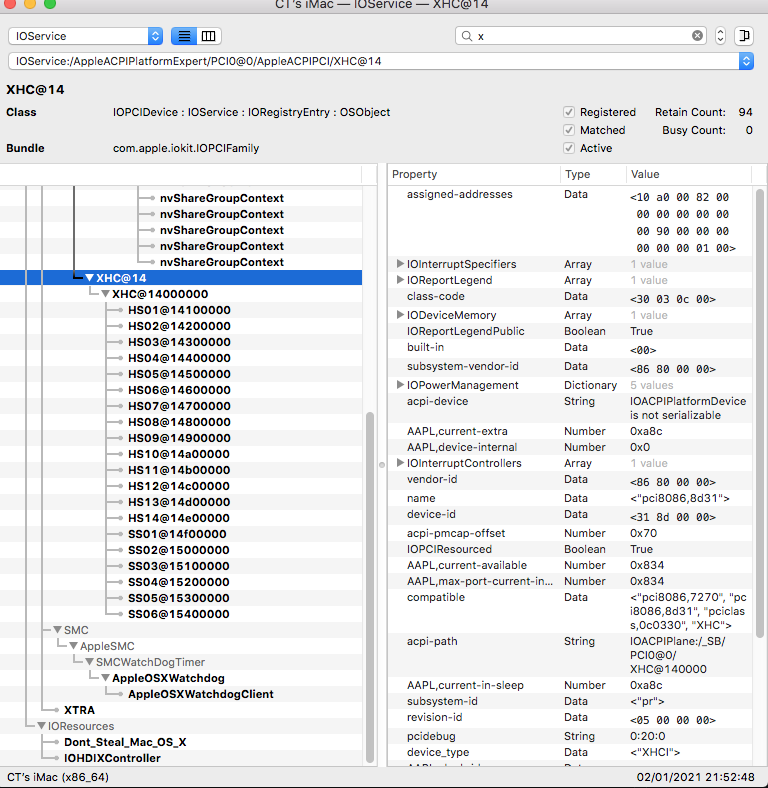

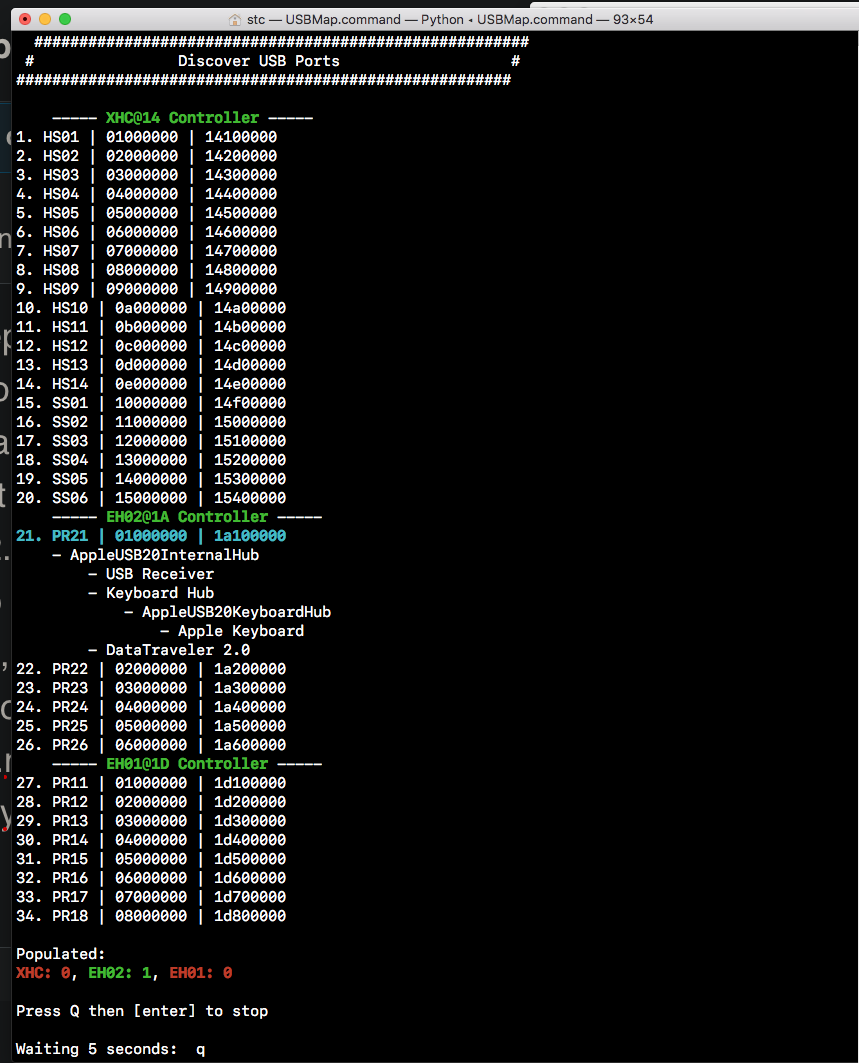

geticus Posted January 2, 2021 Author Share Posted January 2, 2021 (edited) Thank you guys, much appreciate Anyway I gave up on Opencore for now and managed to boot my High Sierra partition with the good old Clover. Now everything is fine except USB 3, I only have USB 2, I tried with Hakintool and USB.map but without success. Whatever I do with the USB flash drive, I can change the port, but it always appears in two different places only in usb.map and nothing appears in XCH in IORegistryExplorer. On 1/1/2021 at 10:22 PM, Hervé said: The info displayed at the point where you get stuck is indicative of graphics not initializing. GTX 1060 is Pascal generation and Pascal cards require the nVidia Web Driver (with support limited to Sierra and High Sierra), since they're not natively supported. You would probably need to boot with nVidia graphics disabled initially and, once you reach the High Sierra desktop, download the Web Driver applicable to your High Sierra build and install it. You should then obtain graphics acceleration with the relevant boot arg as described in Dortania's documentation. However, that documentation states that GP104/GDDR5X variants of the GTX 1060 are not supported by the Web Drivers so you could find yourself out of luck... https://dortania.github.io/GPU-Buyers-Guide/modern-gpus/nvidia-gpu.html#pascal-series-gtx-10xx I don't know what to say, I can use my 1060 with 6Go of RAM without any problem... Edited January 2, 2021 by geticus Link to comment Share on other sites More sharing options...
