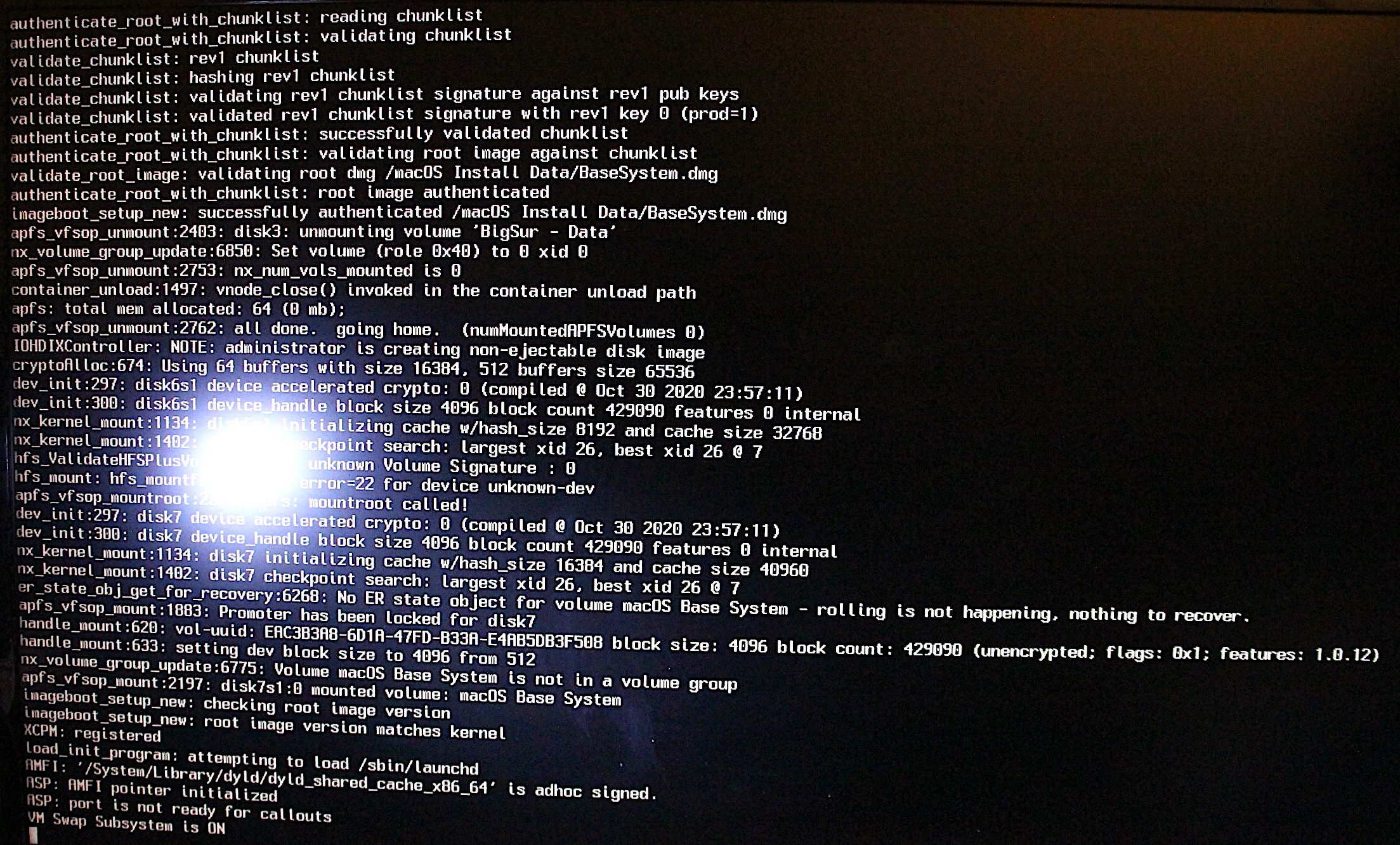

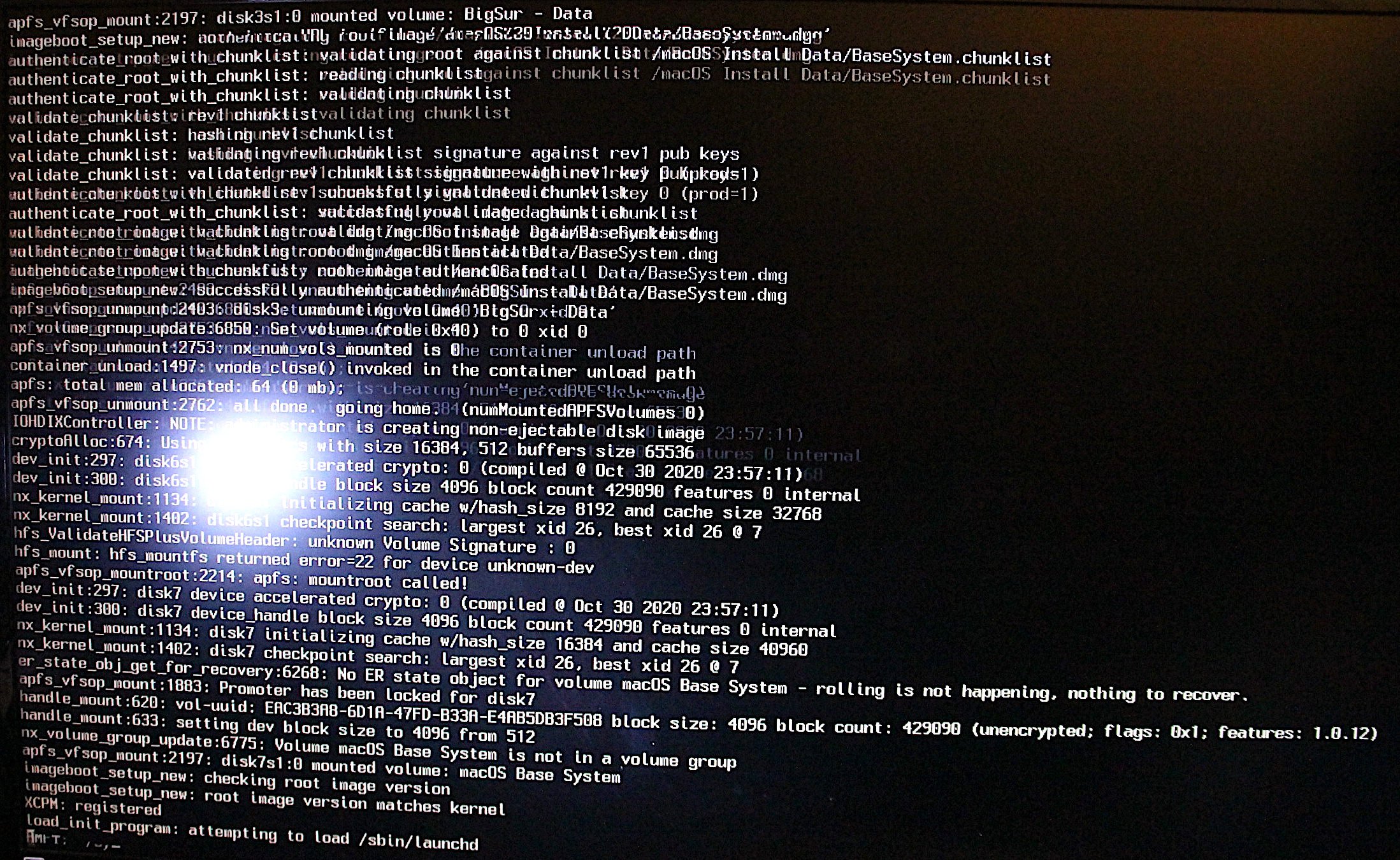

Hi there,
is there anyone who can help me with installing big sur?

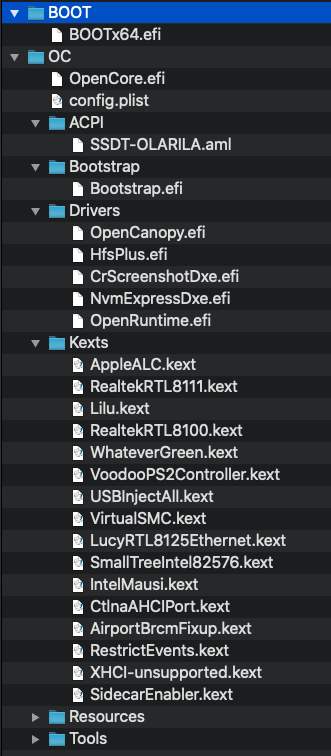

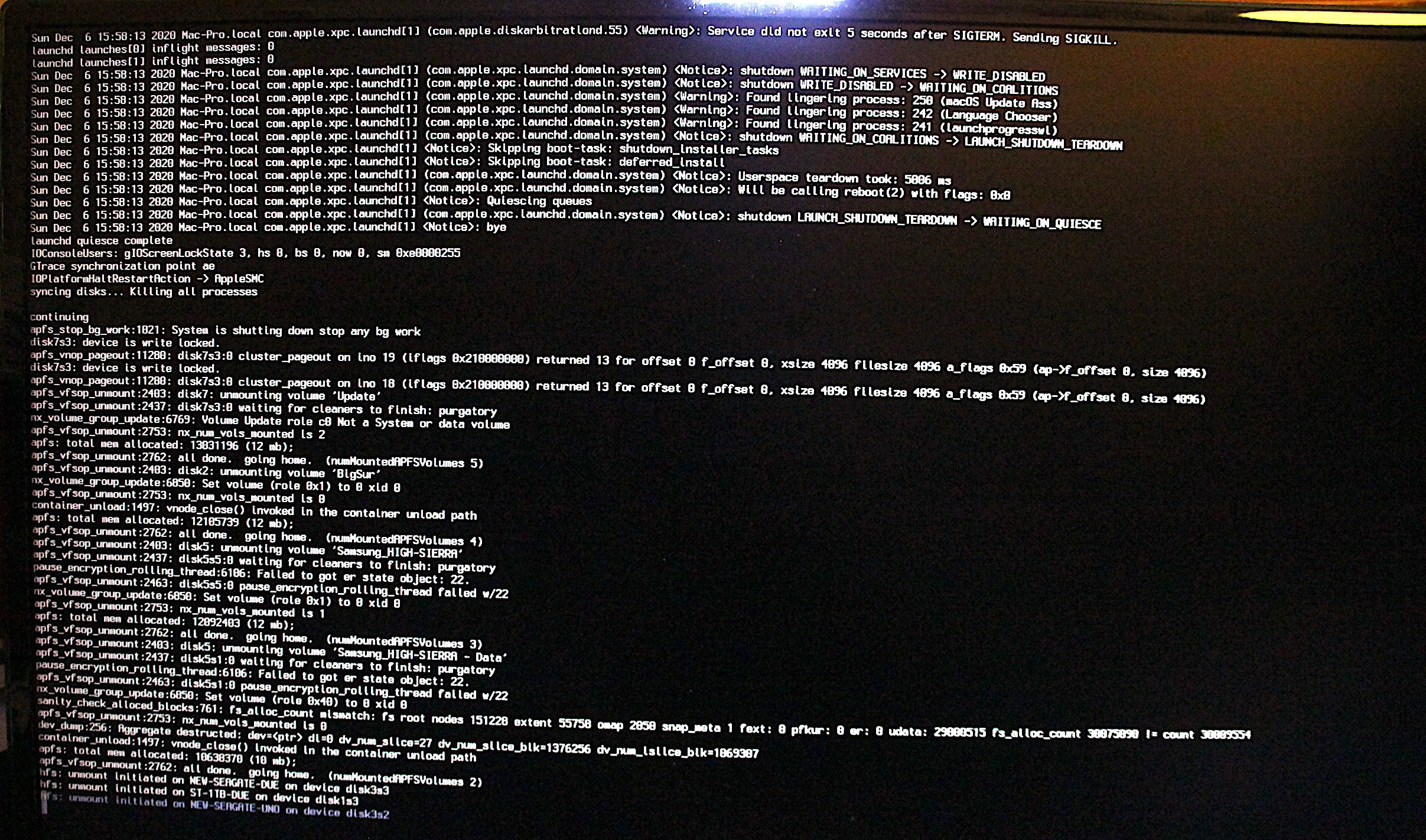

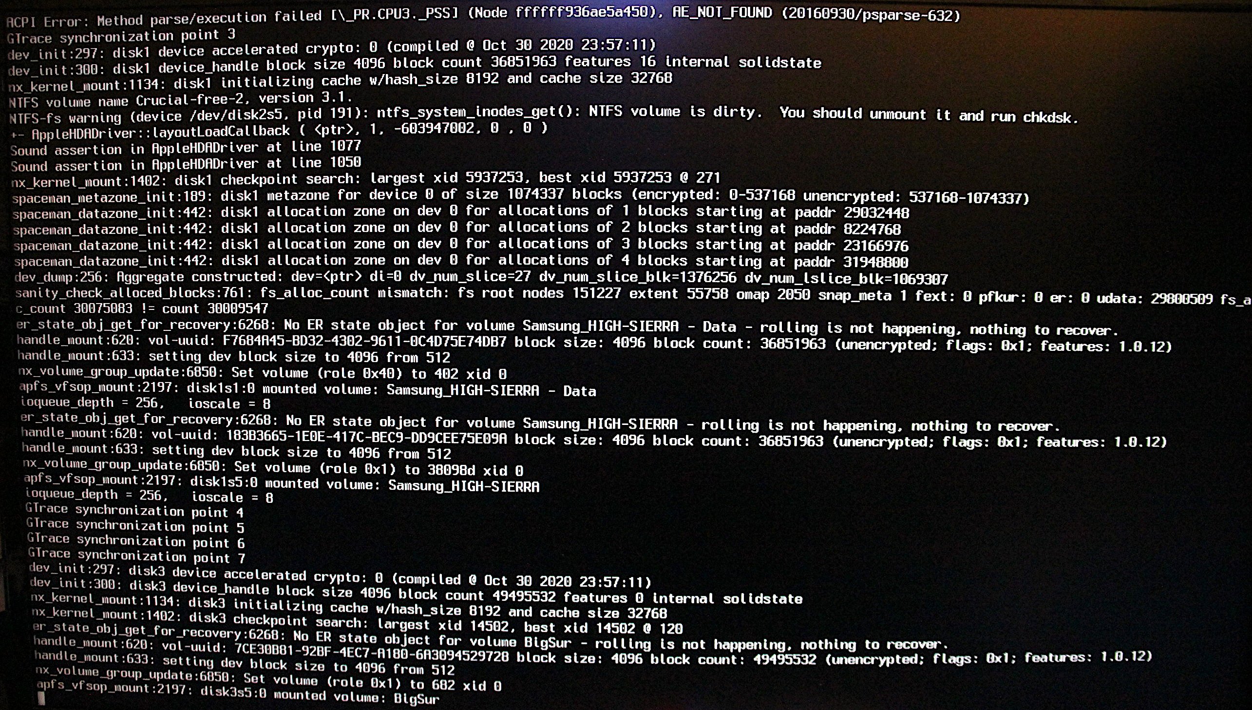

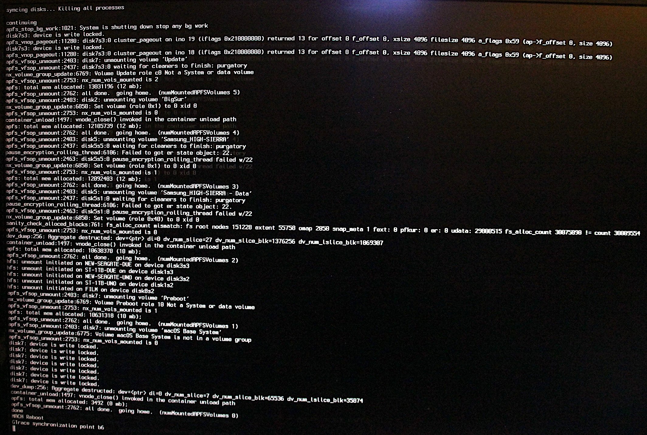

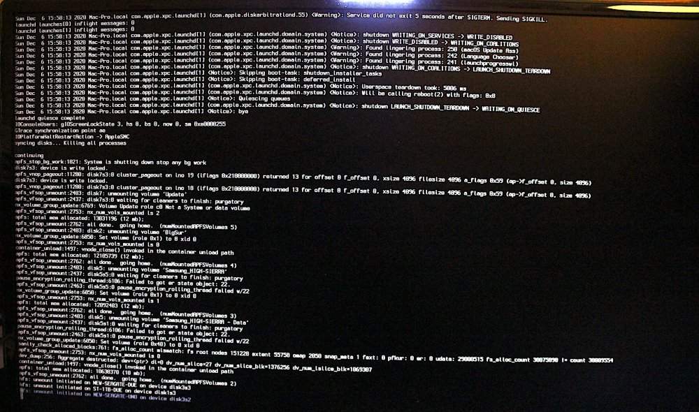

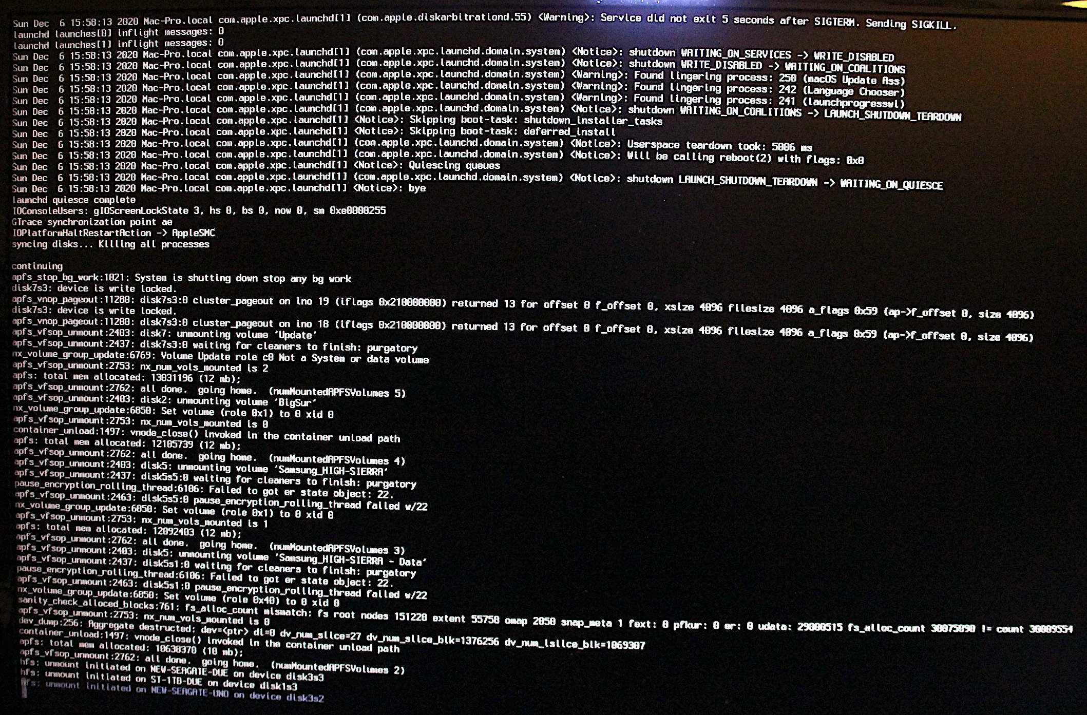

The problem is this: after installing the system on the ssd (when there are 12 minutes left, it restarts by itself) I try to boot from the usb key indicating the partition in which I have installed Big Sur, the system loads, the apple logo appears but shortly thereafter the status bar stops progressing and the system reboots by itself. I've tried tons of config.plists and settings (quirks and more) but I've been getting the same result for about a month now.
I tried both with OC (all versions up to 0.6.4) and with CLOVER version 5127.
What should I do ? Please help me.

I attach config.plist, photos and video.
Spoiler

The problem is that Big Sur relies on NATIVE nvram to finish the installation. Otherwise you will get stuck at stage 2. This problems occurs on Asus Z97 and soe HEDT motherboards. There are two ways to fix it.
  1. Take out the disk drive and perform the installation on a different pc (or a real Mac). Then put it back.  Your computer can run Big Sur but it can't finish the installation.
  2. Or you can fix the nvram yourself. More info here
This information is from the OpenCore guide.
https://dortania.github.io/OpenCore-Install-Guide/extras/big-sur/#asus-z97-and-hedt-ie-x99-and-x299-failing-stage-2-installation
Note that this problem exists on all motherboards without working nvram (like mine too :/)
Hope this helped :D
