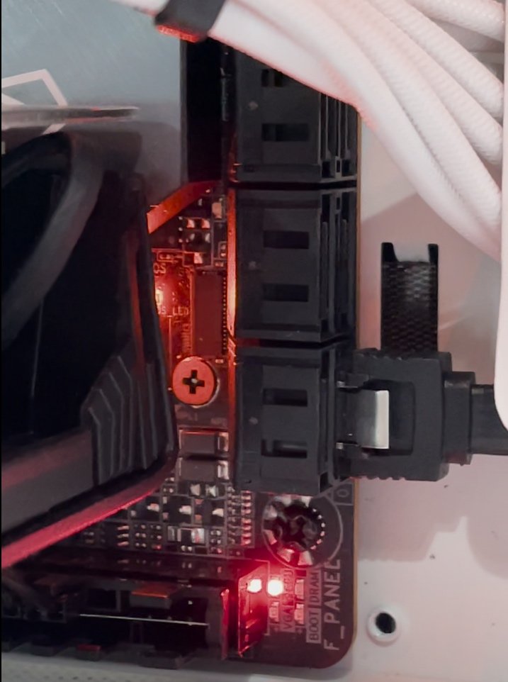

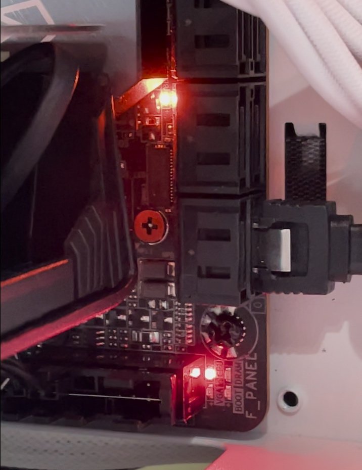

Muaitai Posted December 23, 2020 Share Posted December 23, 2020 Have any of you seen this kind of error? It was working perfectly until I opened the case to fix the RGB cable that was a bit lose, turned off everything and disconnected from power before fixing the cable, after that the BIOS lights are lighting up each at a time and the computer shuts down, CPU light is RED all the time, I have replaced everything inside, CPU, Mobo, VGA card, memories but still this error. I did not touch anything else but the RGB cable. Configuration: GIGABYTE Z490 AORUS Master Intel Core i9-10900 Desktop Processor Noctua NH-D15 chromax.Black, Dual-Tower CPU Cooler HyperX Fury 128GB 3200MHz DDR4 Ram CL16 DIMM Sapphire Radeon Pulse RX 580 Corsair RMX White Series RM750x Samsung 970 EVO Plus SSD 1TB Link to comment Share on other sites More sharing options...
Muaitai Posted December 23, 2020 Author Share Posted December 23, 2020 After troubleshooting the computer, by removing everything and trying one by one, I was NOT able to fix this problem so I opened an RMA with Gigabyte and will try to return the mobo for exchange. Several people in other chats said it may be the battery, it was not, replaced twice, and still, I reset the BIOS, updated it, and still the problem, memories, cpu vga and nvme all fine. Link to comment Share on other sites More sharing options...
