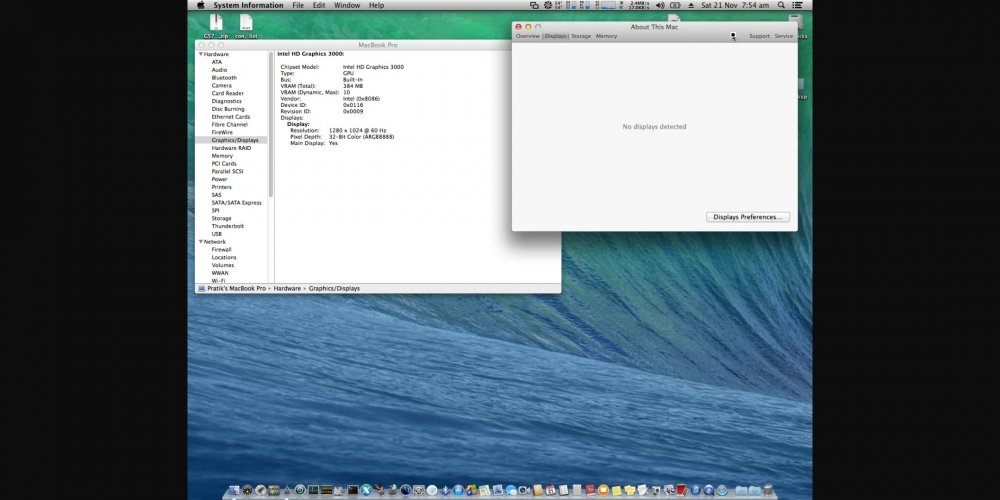

You are not the only person to face this issue on HD3000.
Most people have HD3000 working ootb. But few unlucky ones have the same issue since Mavericks
I tried with OC, Clover & Chameleon. No LVDS display without connecting hdmi.
Tried injecting edid as well.
No one has solved this issue afaik.
PS: ioreg shows entry for Applebacklightdisplay & qeci is working on hdmi
Hardware: hd3000 on series 6 chipset (dont need imei patch)
Resolution:1366x768 (set in oc/clover/chameleon) yet it chooses 1280x1024Screenshot_20201121-132422.thumb.jpg.424c72604a7370050d6b8373fadda550.jpg
