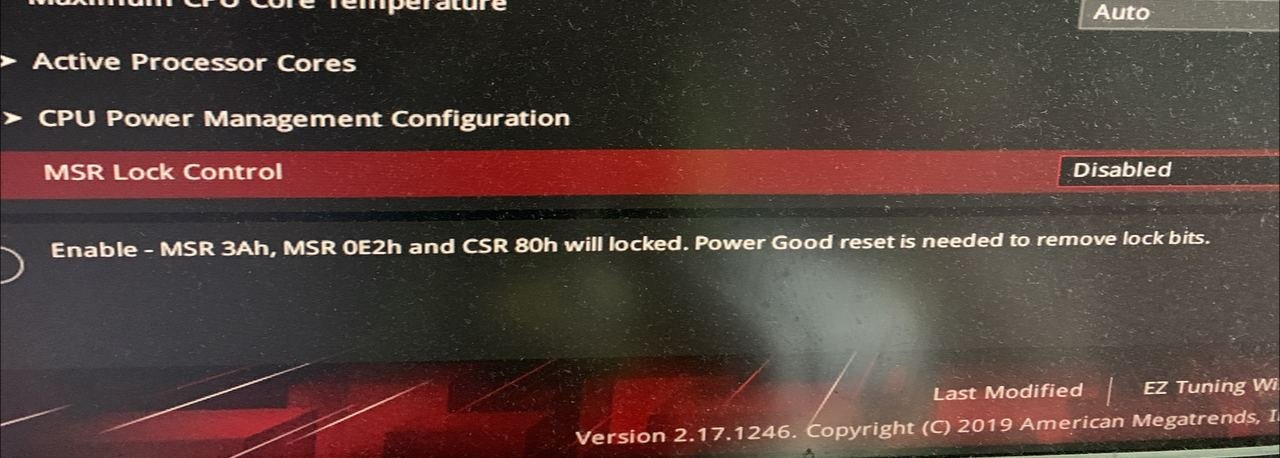

llity Posted December 8, 2020 Share Posted December 8, 2020 I use the lasted BIOS-0702, and disabled the MSR lock. But I reboot the PC, the MSR lock did not unlock. I need help for this issue. Thanks. What's the meaning of 'Power Good reset'? to remove lock bits. Quote Link to comment Share on other sites More sharing options...
Slice Posted December 8, 2020 Share Posted December 8, 2020 You have to switch off the computer, unplug from electricity and switch on again. Quote Link to comment Share on other sites More sharing options...
