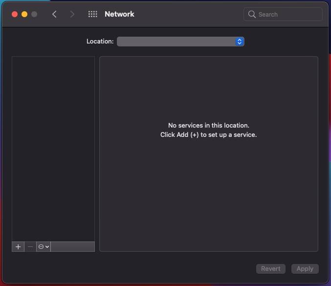

Muaitai Posted December 1, 2020 Share Posted December 1, 2020 Hi, I have finished my Hackintosh and everything seemed to go very well but as soon as I tried the network and sound neither were working. I don't even see an option in the Network. Below is my configuration and parts: • GIGABYTE Z490 AORUS Master • Intel Core i9-10900 Desktop Processor • HyperX Fury 128GB 3200MHz DDR4 Ram CL16 DIMM • Sapphire Radeon Pulse RX 580 • Samsung 970 EVO Plus SSD 1TB • Fenvi M.2 NGFF BCM94360NG Card SSDT-AWAC.aml SSDT-EC-USBX-DESKTOP.aml SSDT-PLUG-DRTNIA.aml AppleALC.kext Lilu.kext LucyRTL8125Ethernet.kext NVMeFix.kext RealtekRTL8111.kext USBInjectAll.kext VirtualSMC.kext WhateverGreen.kext Sanity Checker Results Appreciate any inputs. TIA. Link to comment Share on other sites More sharing options...

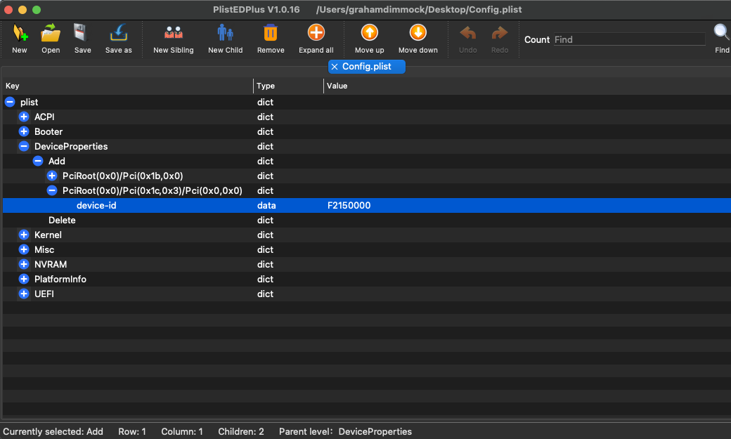

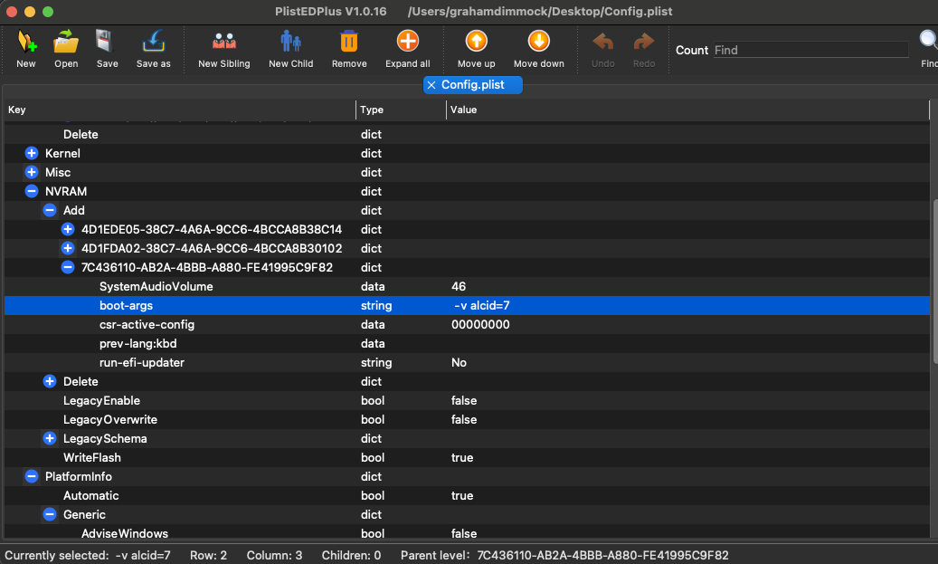

BALDY_MAN Posted December 2, 2020 Share Posted December 2, 2020 (edited) open you config.plist. Device properties add a new child. PciRoot(0x0)/Pci(0x1c,0x3)Pci(0x0) then add sibling device-idF2150000. to your kext folder add FakePCIID_Intel_1225-V.kext and FakePCIID.kext. that will get your internet working. for sound you will need Lilu.kext andAppleALC.kext and alcid=7 in the boot arg or you could try this EFI Edited December 2, 2020 by BALDY_MAN 2 Link to comment Share on other sites More sharing options...

Muaitai Posted December 2, 2020 Author Share Posted December 2, 2020 I was able to get the Ethernet working, I used Hackintool to find out the correct PciRoot for my Ethernet and it was PciRoot(0x0)/Pci(0x1C,0x3)/Pci(0x0,0x0), now is working. Only the Wi-Fi and Bluetooth are not working and is very weird because I replaced the original for a Fenvi M.2 NGFF BCM94360NG Wifi 802.11ac Bluetooth 4.0 Network Card and should have worked out of the box. Link to comment Share on other sites More sharing options...
BALDY_MAN Posted December 2, 2020 Share Posted December 2, 2020 (edited) 48 minutes ago, Muaitai said: I was able to get the Ethernet working, I used Hackintool to find out the correct PciRoot for my Ethernet and it was PciRoot(0x0)/Pci(0x1C,0x3)/Pci(0x0,0x0), now is working. Only the Wi-Fi and Bluetooth are not working and is very weird because I replaced the original for a Fenvi M.2 NGFF BCM94360NG Wifi 802.11ac Bluetooth 4.0 Network Card and should have worked out of the box. PciRoot(0x0)/Pci(0x1C,0x3)/Pci(0x0,0x0) is in the screen shot I posted. glad you up and running enjoy. I just bluetooth from my windows drive Edited December 2, 2020 by BALDY_MAN Link to comment Share on other sites More sharing options...

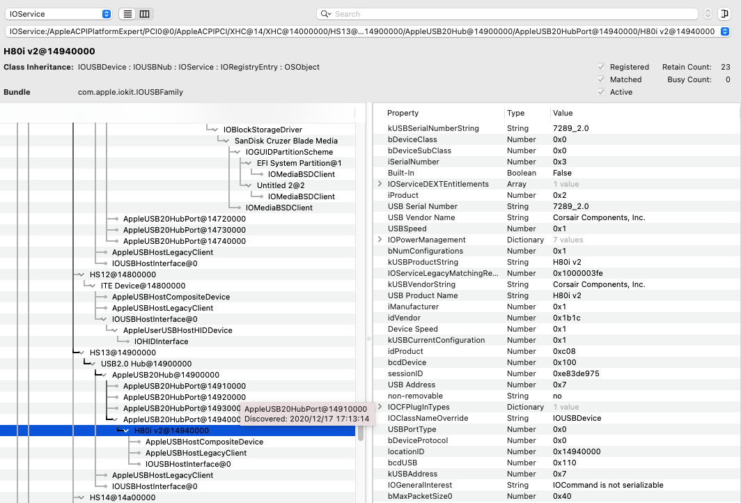

Beefcat Posted December 17, 2020 Share Posted December 17, 2020 Great build!! Well done. I have Z490 master with corsair H80i V2 water cooler cpu.My computer shows HS13 as USB 2.0 Hub.On this Hub (port 4), H80i V2@ 14940000 can be found. This device is preventing sleep.Sleeps works when:1. I remove the CPU USB header (H80i V2) from the motherboard2. OR if I removed HS13 completely in SSDT-UIAC.amlWhat is the best and most elegant way to achieve this without affecting the other 3 devices that also sits on HS13 Hub ?See below HS13 that shows on Hub port 4 the H80i V2. Link to comment Share on other sites More sharing options...
