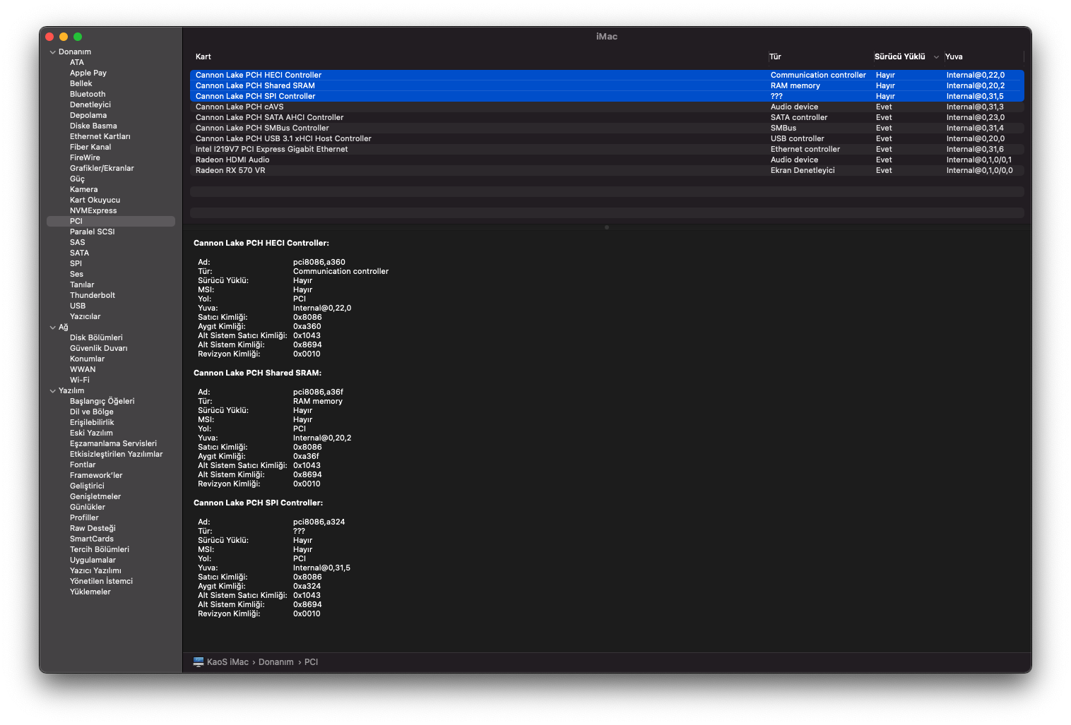

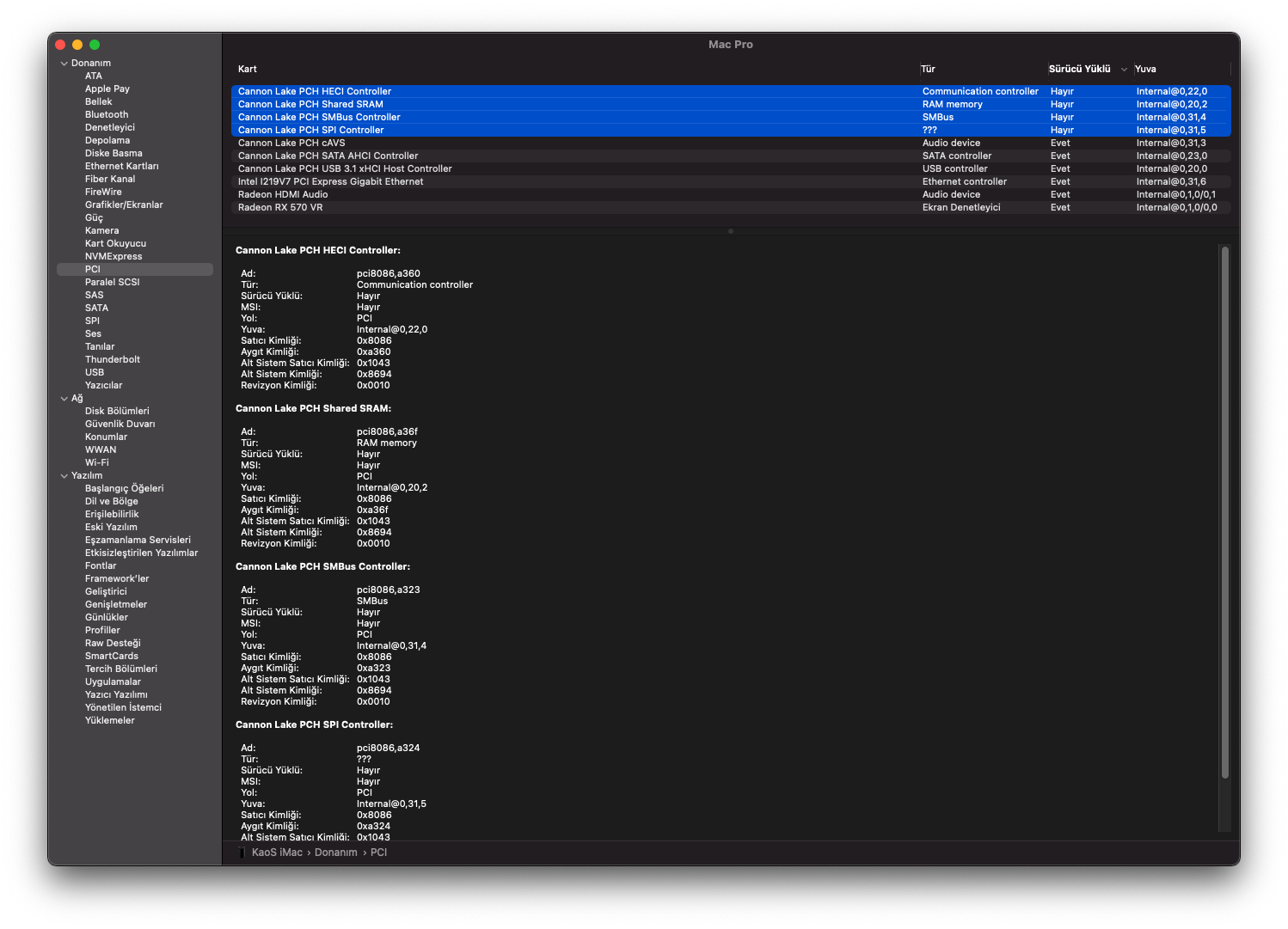

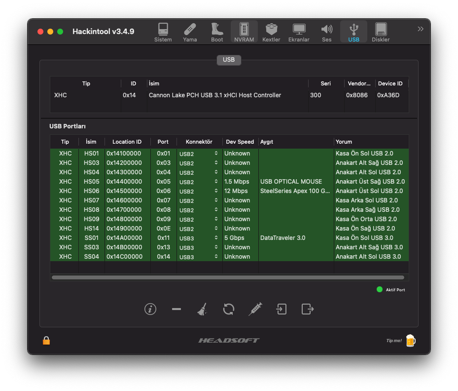

xKaoSx 1 Posted December 1, 2020 Share Posted December 1, 2020 (edited) Hi everyone, I am Turkish people and live in Turkey. My English very very bad. I am so sorry. I am read OpenCore guide and new install. My system specs in down. Installing macOS Big Sur with OpenCore 0.6.4. Finish install open Hackintool and dump to DSDT. Open SSDTTime and create SSDT-AWAC.aml, SSDT-EC.aml, SSDT-PLUG.aml, SSDT-PMC.aml and SSDT-USB-Reset.aml. Open my EFI and delete all prebuild SSDT and delete config.plist in ACPI tab. New create SSDTs add EFI and config.plist. Open Hackintool and run USP Mapping, create USBPorts.kext and SSDT-EC-USBX.aml. SSTD and kext add my EFI and config.plist. Open About This Mac section and open System Report. I am see 4 devices is not injected or not have a kext or SSDT. Open OpenCore Guide and search SMBUS and find this GUIDE Create new SSDT for SSDT-SBUS-MCHC.aml (my SMBUS device windows bios name SB.PCI0.SBUS) and add EFI and config.plist. Successful device is now inject and system report write is now yes. But system test is sleep problem now. SSDT-SBUS-MCHC.aml disabled for config.plist sleep perfect but enable SSDT-SBUS-MCHC.aml sleep problem only screen sleep, usb and fans not sleep. Can your help me with 2 ask ? 1- SMBUS inject and sleep 2- Other devices Cannon Lake PCH HECI Controller, Cannon Lake PCH Shared SRAM and Cannon Lake PCH SPI Controller how can I inject. My PC Specs MB : Asus H310-Plus Gaming CPU : i5 9400F GPU : RX 570 VR Ram : 16 GB DDR4 (one slot) My Original DSDT Folder for Hackintool Dump DSDT.zip My Current EFI OC 0.6.4.zip My IoReg fie (ORegistryExplorer 3.0.2) KaoS iMac.zip Edited December 1, 2020 by xKaoSx Link to post Share on other sites
