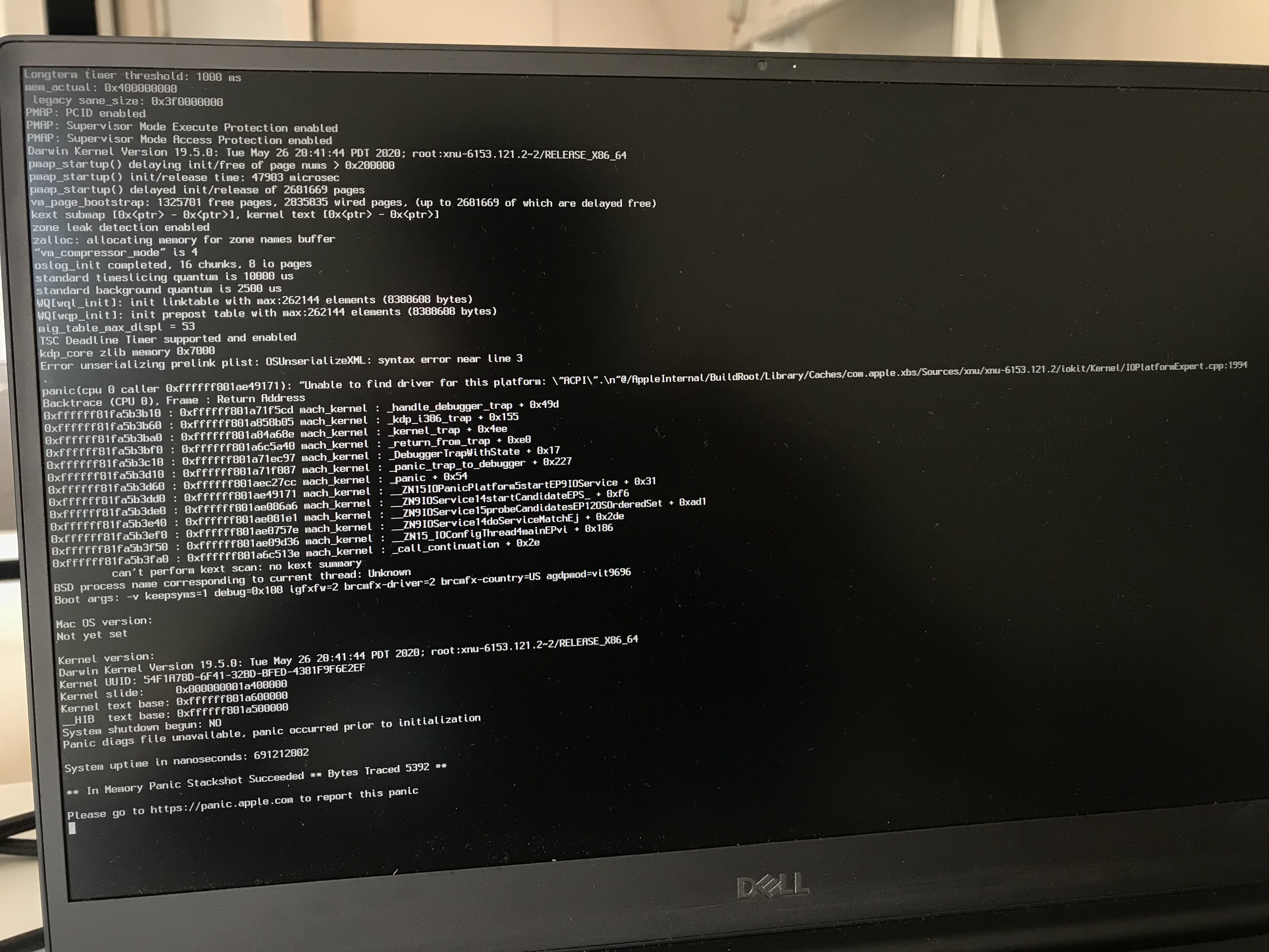

piromanneo Posted August 15, 2020 Share Posted August 15, 2020 (edited) Hello I'm having problem with my Catalina (10.15.5) installation, after the command sudo kextcache -i / system does not boot. It hangs on this kernel panic (attached). I have tried using older versions of Open core (05.8,05.9,0.60) same error. Tried -x -f -v boot flags same panic. Tried different versions of kexts same panic. I can boot in recovery mode, so i tried with in terminal kextcache -i /, -u but it gives me errors about StagedExtensions could not be found "because there is no such file... Any tip, debuging, would be appreciated. Tried reinstalling, system boots fine until there is cache rebuild. Specs Dell XPS 7590 i7 9750h 16GB RAM 1TB ADATA SX8200 m.2 nvme 1080 non touch panel wifi BCM94360NG fenvi card Efi is losely based on this repo: (also tried with his files, but same panic)https://github.com/gorquan/OC-XPS-7590 Thank you. EFI.zip Edited August 15, 2020 by piromanneo wifi added Link to comment Share on other sites More sharing options...

roddie Posted December 28, 2020 Share Posted December 28, 2020 So after a lot of trial-and-error, I figured out that the problem on my end was a newer version of AtherosE2200Ethernet.kext. I went back to v2.2.2 and it worked fine. I know someone else has also seen this issue recently on a completely different system and he was able to resolve it by going back to an older kext as well. Hope this helps others! Link to comment Share on other sites More sharing options...
semaca42 Posted July 10, 2021 Share Posted July 10, 2021 On 12/28/2020 at 6:57 PM, roddie said: So after a lot of trial-and-error, I figured out that the problem on my end was a newer version of AtherosE2200Ethernet.kext. I went back to v2.2.2 and it worked fine. I know someone else has also seen this issue recently on a completely different system and he was able to resolve it by going back to an older kext as well. Hope this helps others! I want to thank you very much . I was trying for weeks to update from OC 0.6.6 to OC 0.7.0 and I was out of ideas when I found this post . I was using the AtherosE2200Ethernet.kext 2.3.3 and after I read this post I switch to 2.3.0 and right away Catalina was booting . I'm using a Gigabyte GA-z170Mx Gaming5 .Now I see , we have same motherboard,cpu and memory . I have a Vega 56 graphic card. Thanks again. Link to comment Share on other sites More sharing options...
