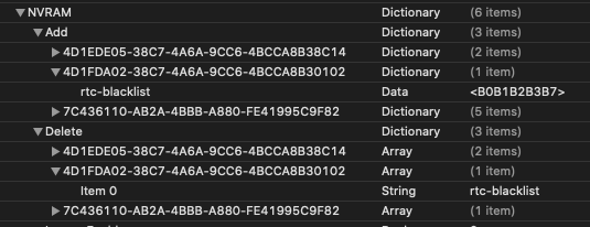

I have determined that the correct rtcfx_exclude range (for use with RtcMemoryFixup.kext) for my EliteDesk 800 G3 Mini is not a contiguous range (e.g. not B0-B4). The correct range for my G3 Mini is
          rtcfx_exclude=B0-B3,B7
I determined this by trial and error when attempting to wake from sleep. I haven't yet gotten wake from sleep to work on the G3 Mini (Kabylake, i7-7700T, HD630), but with this rtcfx_exclude range, attempts to wake from sleep do not corrupt RTC.
I'm posting this in this thread, because the RTC issue on the EliteDesk 800 G4 Mini is hard to reproduce. Maybe the range for the G3 Mini will work (or at least be a good starting point) for the G4 Mini.
EDIT: I tried to convert my G3 Mini rtcfx_exclude range to an rtc-blacklist in OC 0.6.3, but my converted exclude range did not work. I'm sure this is user error and will need to review this again to find my mistake. Staying with boot-arg rtcfx_exclude and RtcMemoryFixup.kext for now.

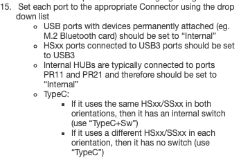

EDIT: When framebuffer-conX-type is set to Single-link DVI as described below, Hackintool crashes when selecting Patch > Connectors. It appears that Hackintool is not compatible with Single-link DVI setting. Since Dual-link DVI appears to work fine even when actual connector is Single-link DVI, it is best to leave framebuffer-conX-type setting at Dual-link DVI if you use Hackintool.
I just learned something new after reading this Dortania page: the DVI connector type 0x0004 that I've been using is for dual-link DVI. My DVI connectors are single-link (display resolution 1680x1050), so my framebuffer-conX-type should be 0x0200 (reverse byte order 0x00020000). I am now running with this revised connector type and am not seeing any difference in behavior. I suspect that this doesn't matter for me, because my display resolution is below 1920x1200 as discussed here. For those with DVI displays having resolution higher than 1920x1200, you would need dual-link DVI.

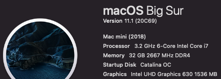

Prior to my upgrade to OC 0.6.5, I upgraded to Big Sur 11.1 (20C69) (still running OC 0.6.3). I also attached the latest version (r006) of my OC 0.6.3 EFI to Post #1. Including RTCMemoryFixup.kext with boot-arg rtcfx_exclude=B0-B3,B7 has resolved the RTC issues that I observed with my EliteDesk 800 G4 Mini. The updated EFI (r006) includes the following changes from r005:
ACPI
  • Replaced SSDT-AWAC with SSDT-AWAC-HPET: disables AWAC and HPET
  • Removed SSDT-HPET (no longer patching HPET now that it is disabled)
Kexts
  • Updated AppleALC, Lilu and WhateverGreen
  • Added RTCMemoryFixup
config.plist
  • Updated "ACPI > Add" to reflect ACPI changes
  • Updated "ACPI > Patch" by eliminating unnecessary HPET / IRQ patching (now that HPET is disabled)
  • Added "Booter > Quirks > AllowRelocationBlock=No" (prep for OC 0.6.4+)
  • Changed "Booter > Quirks > EnableWriteUnprotector" from Yes to No (as recommended by OC Sanity Checker for CoffeeLake Laptop)
  • Updated "Kernel > Add" with RTCMemoryFixup
  • Added "Misc > Security > BlacklistAppleUpdate=Yes" (prep for OC 0.6.4+)
  • Added "rtcfx_exclude=B0-B3,B7" to "NVRAM > 7C436110-AB2A-4BBB-A880-FE41995C9F82 > boot-args" to prevent RTC corruption on Big Sur Shutdown and during MacOS installs
About This Mac
Spoiler

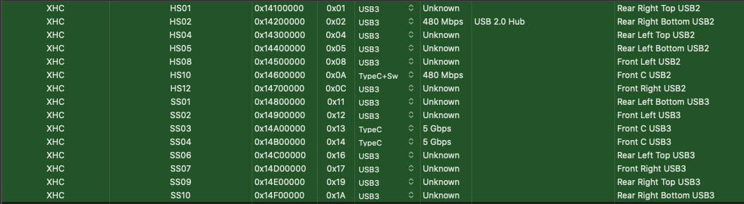

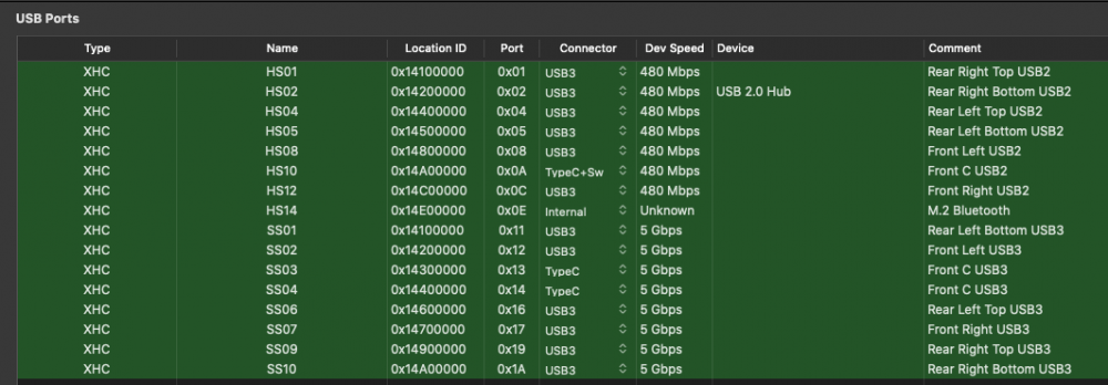

I learned something about the HP EliteDesk 800 G4 Mini that I didn't know: the USB C port uses the same port ID (HS10) for both orientations with USB 2.0 devices, but it uses different port IDs (SS03 and SS04) for each orientation with USB 3.0 devices.  Since everything appears to be working correctly with the current USBPorts.kext USB mapping, I suspect that this change below is only cosmetic, so I'm posting this for interested readers who are learning about USB patching.  I use the word "orientation" to be consistent with the term used in Hackintool's context-sensitve help, which implies that there is a "upside" and a "downside" when connecting USB-C devices (since the connector can be inserted both ways).  The USB-C port is able to sense this "upside orientation" and "downside orientation" as you will read below.
Details:
The HP EliteDesk 800 G4 Mini USB C port (Front) uses the same port ID (HS10) for both connector orientations with USB 2.0 devices, but it uses different port IDs (SS03 and SS04) for each orientation with USB 3.0 devices. If I read the Hackintool help screen (below) correctly, I think this means that the connector type for the USB C port with USB 2.0 devices is "TypeC+Sw," but the connector type for the USB C port with USB 3.0 devices is "TypeC."
Hackintool Port Connector Instructions
Spoiler
This also means that the HP EliteDesk 800 G4 Mini has 16 different USB port IDs, which exceeds the maximum of 15, so we need to choose either SS03 or SS04 (not both) to remain within the 15-port limit. Attached is my revised USBPorts-16.kext with all 16 ports defined. The attached USBPorts-16.kext does NOT comply with the 15-port limit. I enable OC's Kernel>Quirks>XhciPortLimit to boot with the attached USBPorts-16.kext.  You will need to enable the appropriate USB port-limit patch for your bootloader.
Revised Hackintool USB Port Mapping (does not comply with 15-port limit)
Spoiler
1430459346_ScreenShot2021-01-13at12_46_31PM.thumb.png.d768b10b4607bc0c3d13707eefcc4a79.png
I tested this with simple USB thumb drives (one USB 2.0 and one USB 3.0) and a USB > USB-C adapter. I'm sure it's more cosmetic than anything else. I am currently running with HS10 as TypeC+Sw (since it is a single Port ID for both orientations) and SS03 as TypeC. I deleted SS04 to stay within the 15-connector limit. The only change from the current TypeC mapping is that I changed HS10 from TypeC to TypeC+Sw.  This new 15-port USB mapping is in the attached USBPorts-15.kext.
EDIT: After deleting SS04 (to comply with the 15-port limit), when a USB 3.0 device is inserted into the USB-C port in the "SS04 orientation" (the orientation no longer in the USB map), the USB 3.0 device is recognized on port HS10. So it does appear that the USB-C port is recognized differently depending on whether its SS04 Connector is included in the USB map. When I flip the device, it is recognized on port SS03 as expected. If I use the port limit patch and keep both SS03 and SS04 in the map, the USB-C device is recognized on ports SS03 and SS04 as expected.

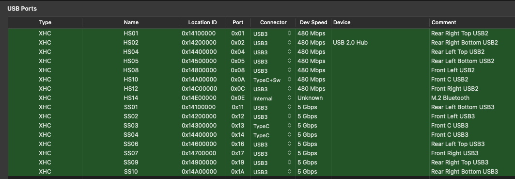

Since I am not using my Wi-Fi / Bluetooth (I still have the unsupported Intel M.2 card), I have removed HS14 from my USB map and restored SS04. With this new mapping, a USB 3.0 device inserted into the USB-C port is recognized on ports SS03 and SS04 as expected. The corresponding USBPorts-noHS14.kext for this new USB mapping is attached.
USB port mapping with HS14 Removed and SS04 Added
Spoiler
1026123590_ScreenShot2021-01-15at5_33_36PM.thumb.png.c93ed6aaa5e5b1cea614cefb3a3be659.png
USBPorts-15.kext.zip

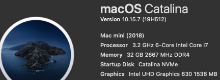

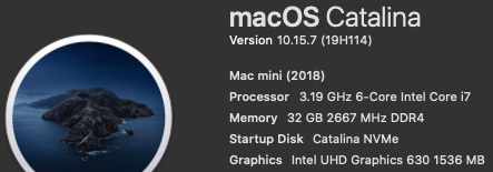

The Catalina security update and Safari update installed without any problems. My current baseline is Catalina 10.15.7 (19H512) and OpenCore 0.6.5 (using EFI OC0.6.5-EFI-r002.zip attached to Post #1).  OpenCore even properly selected the correct macOS Install volume when rebooting the installer.
About This Mac: 10.15.7 (19H512)
Spoiler

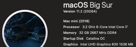

Post #1 now includes an attached draft EFI for OC 0.6.6 (OC0.6.6-EFI-r001). I used this updated EFI to upgrade to Big Sur 11.2 with no problems. Changes from the previous OC 0.6.5 EFI are as follows:
Changes in this EFI (from OC0.6.5-EFI-R002)
  • Upgraded to OC0.6.6
  • Replaced SSDT-MM81 with SSDT-DMAC (new SSDT only adds device DMAC)
  • OC/Kexts contains multiple versions of USBPorts.kext. The default USBPorts.kext has 16 logical USB ports and requires config.plist Kernel>Quirks>XHCIPortLimit=1. Other USBPorts options are below.
  • USBPorts.kext now labels SS03 and SS04 "Connectors" as TypeC. There is disagreement about this, but it is working for me and I suspect it's more cosmetic than functional. Refer to Hackintool context sensitive help for more info.
  • Changed config.plist: Kernel>Quirks>XHCIPortLimit=1 (for 16-port USBPorts.kext). Use Hackintool to customize USBPorts.kext (to comply with 15-port limit) and change XHCIPortLimit to 0.
  • Revised SSDT-XOSI.aml to be 'multi-boot friendly' - includes _OSI("Darwin") conditions
  • Replaced Driver HfsPlus.efi with OpenHfsPlus.efi
  • Upgraded Acidanthera kexts AppleALC.kext, WhateverGreen.kext, Lilu.kext
    • AppleALC.kext 1.5.6 -> 1.5.7
    • WhateverGreen.kext 1.4.6 -> 1.4.7
    • Lilu.kext 1.5.0 -> 1.5.1
  • Changed config.plist: UEFI>Audio>VolumeAmplifier from 143 to 70 (lower boot chime volume)
  • Changed config.plist: Added Kernel>Quirks>SetApfsTrimTimeout
  • Changed config.plist: Added Misc>Boot>LauncherOption, LauncherPath, PickerVariant
  • Changed config.plist: Added PlatformInfo>UseRawUuidEncoding
  • Changed config.plist: Added UEFI>Quirks>DisableSecurityPolicy
  • Changed config.plist: Removed Misc>Security>BootProtect
USBPorts.kext options included in this EFI:
  • USBPorts-noHS14.kext: HS14 (internal Bluetooth USB) not included in port map - complies with 15-port limit, set XhciPortLimit=0
  • USBPorts-16.kext: Includes 16 logical USB ports - exceeds 15-port limit, set XhciPortLimit=1 (not intended for production use)
  • USBPorts.kext: same as USBPorts-16.kext
About This Mac: 11.2 (20D64)
Spoiler
