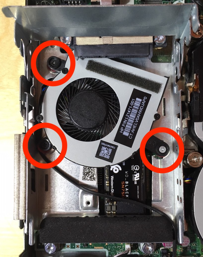

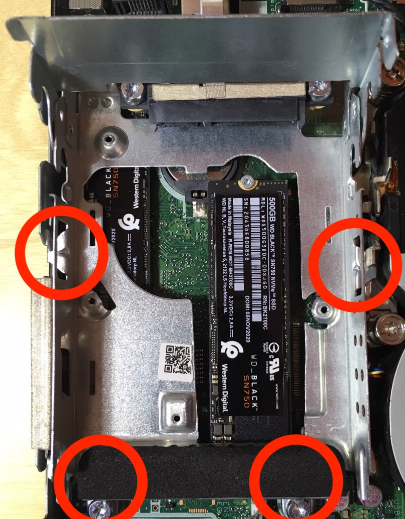

I modified the SATA drive caddy in another 65W HP EliteDesk 800 G Mini in order to be able to install two M.2 NVMe SSDs and a 2.5" SATA HD. This mod was a bit more difficult than my first, so I'm sharing my lessons learned.
1. I needed to slightly bend the tabs circled here:
Spoiler
I needed to bend the upper two tabs "down" toward the motherboard and the bottom two tabs "up" away from the motherboard, so that the top of drive caddy (top as viewed in the photo) sits a little higher (to provide clearance above the M.2 NVMe SSD). Bend the tabs a little at a time and assess your adjustment after each bend. The fan needs to clear the M.2 NVMe SSD so that it spins freely and the fan should sit flush on the mount points without wobbling.
2. I inserted cardboard washers under the caddy fan to raise the fan slightly as pictured here:
Spoiler
With these mods, two M.2 NVMe SSDs and the 2.5" SATA HD fit perfectly in the 65W HP EliteDesk 800 G4/G5 Mini.

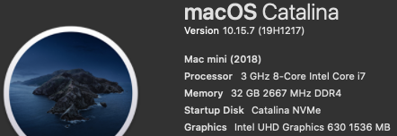

I'm continuing to run Catalina 10.15.7 on my HP EliteDesk 800 G5 Mini using the OC 0.6.9 EFI attached to Post #1. The latest Catalina security update installed without any issues.
About This Mac: Catalina 10.15.7 (19H1217)
Spoiler
EDIT: After applying the Safari 14.1 Security Update, I needed to reboot before Safari would work properly.

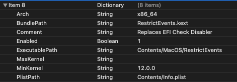

I was thinking about switching from EFICheckDisabler.kext to RestrictEvents.kext, but as I noted here, I don't see evidence that eficheck is disabled when I use RestrictEvents.kext.
I've added RestrictEvents.kext as follows in my OC 0.7.0 config.plist:
config.plist: Add RestrictEvents.kext
Spoiler
Using kextstat, I have confirmed that RestrictEvents.kext is loaded.  Do I need to add any boot-args when using RestrictEvents.kext?

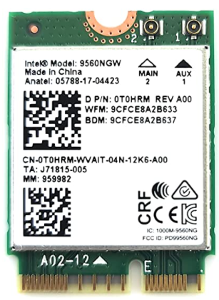

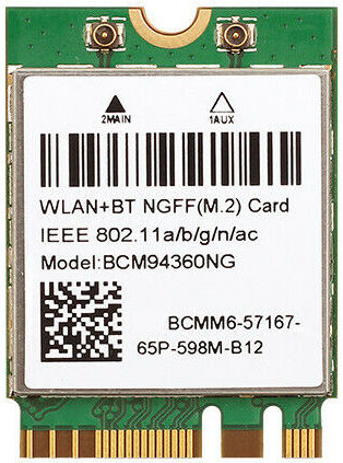

In my opinion, the BCM94360NG M.2 card is a good Wi-Fi/Bluetooth option for our hackminis. Details below...
I'm hacking an HP Envy x360 15m laptop and wanted to replace the Intel Wi-Fi/Bluetooth with Brcm, so I splurged and purchased a Fenvi BCM94360NG M.2 card. The BCM card can be found for under $40 USD. Before installing the card in my laptop, I tested it in my hackmini.
The BCM94360NG is sized perfectly to replace the intel card in the existing M.2 2230 slot without any adapters. This is important if you are using both M.2 2280 slots and the 2.5" SATA HD Caddy (using the modification here). The antenna cable connectors in the HP EliteDesk 800 G5 Mini must be MHF4 because they fit the BCM94360NG connectors perfectly. I did find that the antenna connector alignment needed to be PRECISE in order for the antenna connector to snap onto the card connector, but once attached, the fit was secure. DO NOT force the antenna connector. The connectors will snap in place when they are propertly aligned. I ended up using a magnifying glass to be certain of the alignment before pressing/snapping the connectors.
The Intel color coding of the connector labels (MAIN and AUX) is opposite the BCM color coding (but the numbering is the same):
Intel Wi-Fi Card
Spoiler
Brcm Wi-Fi Card
Spoiler
Be sure to fasten the antenna connectors correctly when replacing the Intel card with the BCM card. Double and triple-check your connectors to make sure you don't have them reversed.
After replacing the Intel card with the BCM94360NG and making sure that the antenna connectors were correctly fastened to the card, Wi-Fi and Bluetooth worked without any Kexts. I haven't tested watch unlock or anything exotic, but basic Wi-Fi and Bluetooth functionality is solid.
Edited by tonyx86

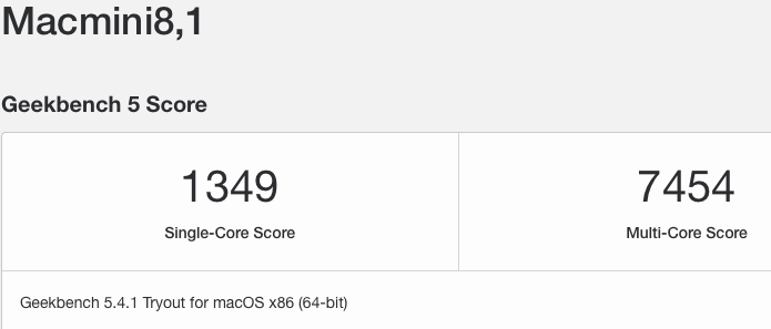

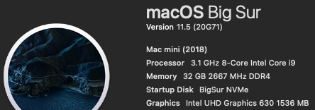

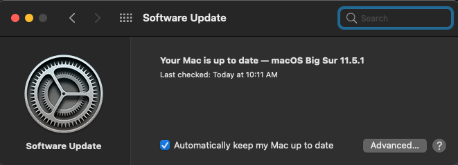

I'll never take for granted the fact that we're running macOS on our Windows PCs. These EliteDesk Minis think they're Macs! The Big Sur 11.5 update was painless with the OC 0.7.1 EFI attached to Post #1.
About This Mac: Big Sur 11.5
Spoiler
GB5 CPU Benchmark
Spoiler
