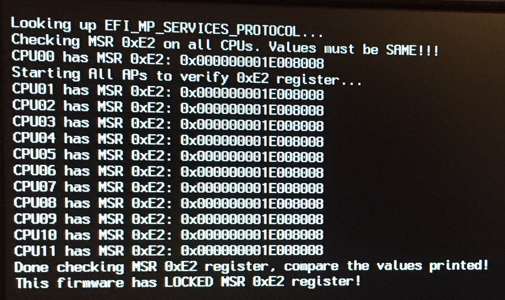

I finally got around to testing MSR 0xE2 register (using OC VerifyMsrE2.efi tool described here). The MSR 0xE2 register is locked in the HP EliteDesk 800 G4 Mini BIOS (see attached screenshot). I have attached a revised OC 0.6.3 EFI to this post. This revised EFI enables Kernel Quirks AppleCpuPmCfgLock and AppleXcpmCfgLock (which others had already done. I did not since my system seemed to work fine with these Quirks disabled). I'm not sure if locked MSR 0xE2 explains the real time clock error that I observed during the Big Sur install and I'm not sure if both AppleCpuPmCfgLock and AppleXcpmCfgLock need to be enabled. I'd prefer to make the suggested BIOS mod, but that's not a high priority for me. If someone else wants to try the BIOS mod (described here), that would be great!
Note that I have not tested my posted EFI with any other OS (e.g. Windows). I dual boot my system, but I don't use OC to boot Windows. In rare instances when I want to boot Windows, I manually select Windows by pressing F9 at startup.
VerifyMsrE2.efi Screenshot
Spoiler
OC0.6.3-EFI-r003.zip

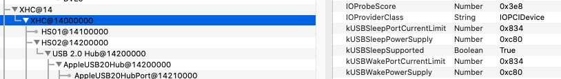

I found mistakes in the USBPorts.kext that I generated with Hackintool:
HS14 was configured as an external USB3 port (UsbConnector 3) when it should have been Internal (UsbConnector 255)
and kUSBSleep and Wake Power properties were not set for MacMini8,1 (they were Hackintool defaults, I think)
My other mistake was that I had both SSDT-USBX.aml and USBPorts.kext in my EFI. SSDT-USBX.aml is no longer necessary with USBPorts.kext.  Also, thanks to @rafale77 for adding port comments and fixing the USB Type C Port Types (changing them to UsbConnector 10).
The attached OC 0.6.3 EFI has is modified as follows:
Removed SSDT-USBX.aml from ACPI (and remove from OC config.plist)
Replaced USBPorts.kext to address the issues above.
*** NOTE ***
If you run USBMap.command after removing SSDT-USBX.aml (leaving USBPorts.kext), USBMap will report that you're missing USBX:
Spoiler
This is a false alarm, because IORegistryExplorer shows that USB Power Properties are loaded:
Spoiler
OC0.6.3-EFI-r004.zip USBPorts.kext.zip
Edited by tonyx86
Fixed broken links

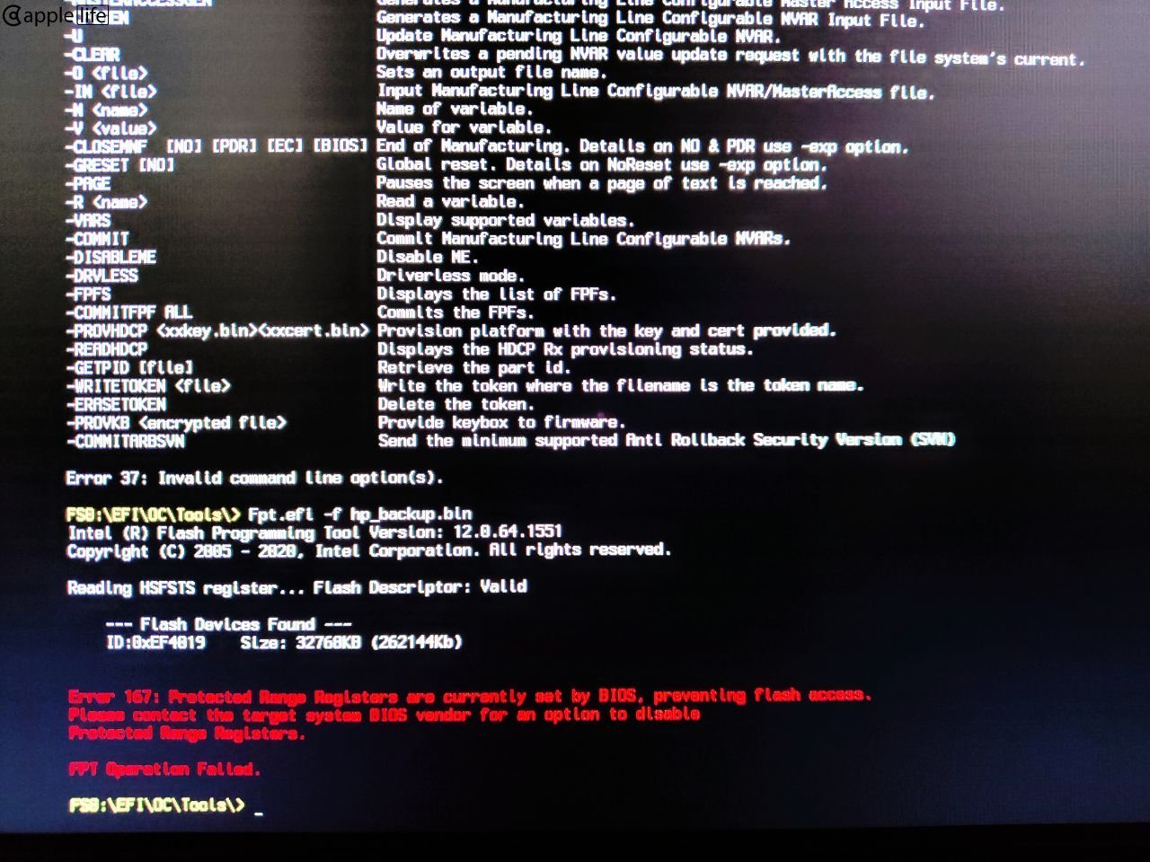

21 hours ago, tonyx86 said:
@v.osypets I saw your BIOS modding request to disable CFG Lock on your G5 Mini.  Did you ever figure it out?  It appears that I've tried the same things that you had prior to your post.
We have locked BIOS by HP, so it's not easy to do there some changes. I have modified with CFG Lock disabled, but I can't flash it, because of BIOS integrated protection.
Would you be able to share how you found CFGLock in your G5 Mini BIOS?
11 minutes ago, v.osypets said:
I had some help from guy who have great experience in this regard...
Ok - we're getting closer. :)  What did you (he) do to unlock CFGLock?
He didn't tell me, because we faced with BIOS protection and it's difficult to unlock it, so we decided to close that topic. I have attached patched BIOS, maybe you will have some time to find some solution. I have no issues with my system at all without CFGLock disabled.
Edited by v.osypets
@v.osypets  I was hoping to learn how you (he) found the CFGLock offset to be able to disable it (even though you weren't able to flash the modded BIOS).  I'll see if I can read what you posted to figure it out.  If you have any more clues that specifically indicate how you (he) found the actual CFGLock offset (location in BIOS), that would be helpful.  Thanks for your patience wiith my remedial questions.
On 11/14/2020 at 6:12 PM, tonyx86 said:
EDIT: A newer version of my OC 0.6.3 EFI is here.
  Reveal hidden contents
Only AppleXcpmCfgLock quirk must be enabled, when CFG-Lock enabled in BIOS on this system.
Thank you.  I've read that and have also seen conflicting recommendations on this.  My current OC config enables both  AppleCpuPmCfgLock and AppleXcpmCfgLock, but I've also been able to run without either quirk enabled and I don't notice any difference in behavior.  Based on my testing, it doesn't seem that the settings of these two quirks matters on the HP EliteDesk 800 G4 Mini.
