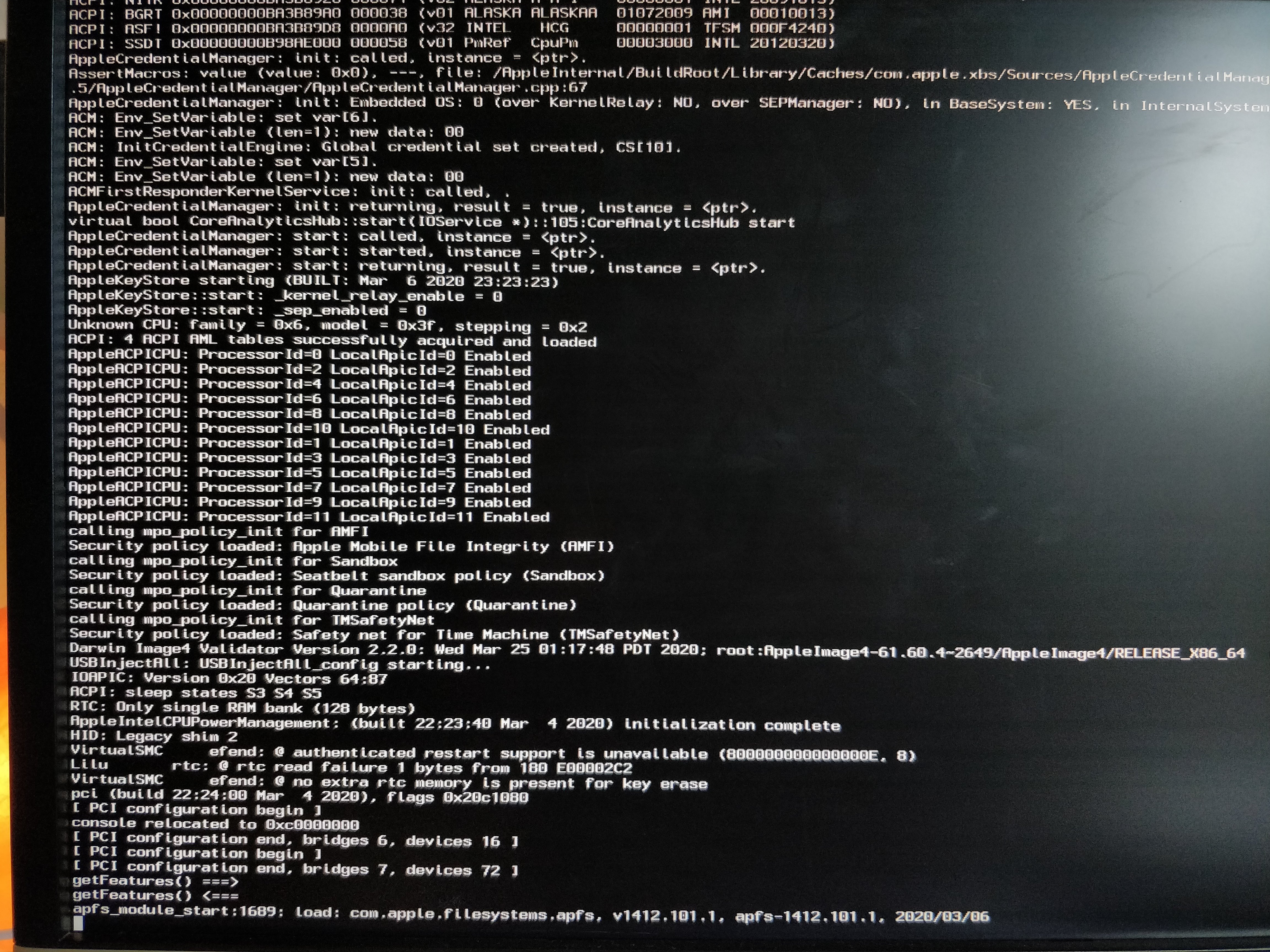

I'm trying to get a Mac OS 15.4.02 install working on the following setup:
Motherboard: GA-X99-SOC Champion (BIOS Version F23c)
CPU: Intel Core i7-5820K (Haswell E)
GPU: XFX Radeon HD 7870
RAM: 1 x 16GB Corsair Vengeance LPX DDR4
I reset the BIOS to optimized defaults and changed these parameters:
Windows 8/10 Features: Windows 8/10 WHQL
CSM Support: Disabled
EHCI Hand-off: enabled
Followed the vanilla desktop guide for creating the USB installer:
Installed clover r5117 on the EFI partition with described drivers and kernel extensions after setting up the USB with createinstallmedia
  • /drivers/BIOS
    • ApfsDriverLoader.efi
    • AudioDxe.efi
    • FSInject.efi
    • SMCHelper.efi
    • XhciDxe.efi
  • /drivers/UEFI
    • AptioMemoryFix.efi
    • VBoxHfs.efi
  • /kexts/other
    • AppleALC.kext (1.4.9)
    • IntelMausiEthernet.kext (2.5.0)
    • Lilu.kext (1.4.4)
    • USBInjectAll.kext (0.7.1)
    • VirtualSMC.kext (1.1.3)
    • WhateverGreen.kext (1.3.9)
    • XHCI-unsupported.kext (0.9.2)
  • I'll have the config.plist attached below ↓
When booting from the Install-Partition it will get stuck right after the "PCI configuration" => getFeatures()
Also I wonder if "rtc read failure 1 bytes from 180 E0002C2" from Lili might be an issue.
After about a minute the log "apfs_module_start: 1689: load: com.apple.filesystems.apfs, c1412.101.1, apfs-1412.101.1, 2020/03/06" comes in and from there on nothing seems to happen anymore.
Image of the verbose boot log is attached aswell.
What do you guys think is the issue here?
Is this some problem with the motherboard / BIOS settings? Or have I accidentally misconfigured Clover?
