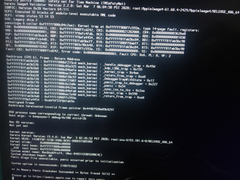

baddles Posted March 17, 2020 Share Posted March 17, 2020 I have attached the zipped folder of my OC for further troubleshooting. Here's my laptop specs: Dell Inspiron 7373 (i7373-7443slv): CPU: Core i7-8550u. GPU: Intel UHD Graphics 620. RAM: 16GB. SSD: 256GB Micron SATA SSD. OC.zip Link to comment https://www.insanelymac.com/forum/topic/343030-kernel-panic-while-using-opencore-unaligned-frameinvalid-frame-pointer/ Share on other sites More sharing options...

pdesh Posted May 10, 2020 Share Posted May 10, 2020 Hello, does anyone have a solution on this? I am stuck on the same error while installing Catalina using OpenCore for 3 days! Link to comment https://www.insanelymac.com/forum/topic/343030-kernel-panic-while-using-opencore-unaligned-frameinvalid-frame-pointer/#findComment-2721751 Share on other sites More sharing options...
pdesh Posted May 20, 2020 Share Posted May 20, 2020 Okay I found a solution in my case. I was using a wrong SMBios. My laptop has a quad core cpu, and the SMBios I was using was of a hexa core cpu. Hence the panics. Link to comment https://www.insanelymac.com/forum/topic/343030-kernel-panic-while-using-opencore-unaligned-frameinvalid-frame-pointer/#findComment-2723008 Share on other sites More sharing options...
