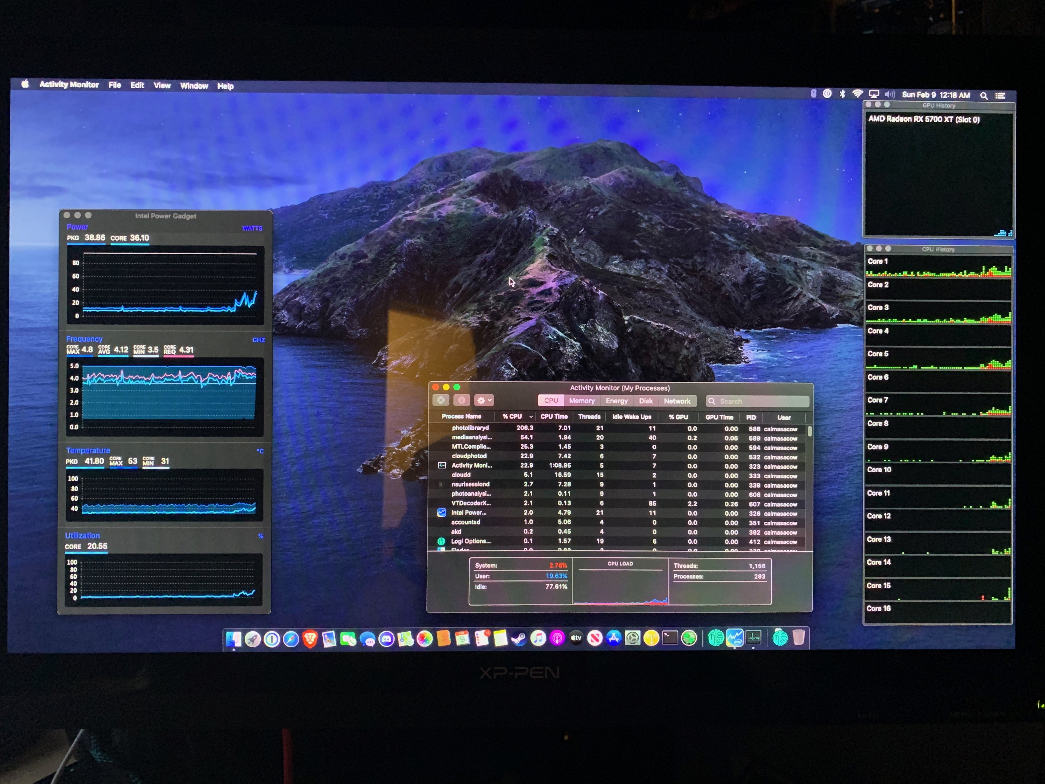

I have my second i9-9900K Hackintoshtosh up and running I tried using the new 5700XT this time I used a sapphire card as I have always had good luck with them. This one works great except for one HUGE problem as long as I'm working with it it is fine but if I let it sit idle for 5 minutes it will freeze at the e 5 immune mark EVERY time without fail.
I have the boot argument:
agdpmod=pikera
as you can see it seems to star drawing more power and there is some GPU activity then boom at the 5 minute mark every time it locks up.
Gigabyte Z390 M Gaming
i9-9900KF
Samsung 1TB 970 PRO
Sapphire PULSE 5700 XT 8GB
Broadcom BT WIFI card
ASUS 10GB Ethernet
I found the solution with the help of pastrychef over on that site that all not be mentioned
the solution was having all of theses boot arguments:
dart=0
darkwake=0
slide=0
agdpmod=pikera
system has been running for several days without a reboot or freeze.
