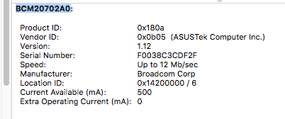

hello. i installed a aw-cb160h  in my desktop using a pcie 1x to mpcie adapter (i got the usb lead connected)
it shows up in usb device tree but even after installing all the patchram kexts in clover i still cannot get it to show up in the bluetooth section in system indentifier
i have tried multiple kexts now and even installing them in s/l/e with kext utility didnt seem to work..
wifi 2.4 ghz and 5ghz worked out of the box after install  and the card showed up in usb devices.
my motherboard is a msi z270 m7
i had this card in my laptop before and somehow got bluetooth working (altho unstable)
thank you in advance
okay. so i done the usb mapping with hackintool and installed the files into acpi in the efi.
bluetooth card stil shows up in the usb tab but stil no information found on the bluetooth tab.
