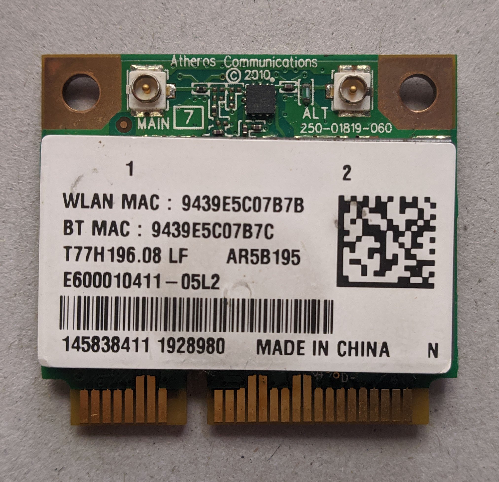

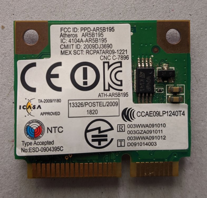

Nikhil Chandran Posted December 26, 2019 Share Posted December 26, 2019 I have a Atheros AR5B195 Half Mini Pci-e Wireless Wlan Wifi + Bt Bluetooth Card Module 802.11b/g/n from a old Sony Vaio laptop and I don't know if this card works with macOS or not. My mobo is Asus Maximus Hero VI running MacOS 10.13.6 High Sierra The wifi card can't be inserted in the pci slot, cuz the wifi card is Mini pci. So I tried to find Mini PCI-E to PCI-E adapter and I got this adapter Bloomerang Mini Pci-E Mini Pci Express to Pci-E Adapter Wireless WiFi Convertor Card Expan Mini PCI-E to PCI-E 1X Desktop Adapter Convertor with Two Antennas for Wireless Wifi Network Card Can someone suggest me a way to use this Wifi card which adapter, Kext should I use. and will this card work for MacOS Mojave or MacOS Catalina Thanks in advance Link to comment Share on other sites More sharing options...
