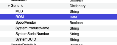

albcc Posted December 20, 2019 Share Posted December 20, 2019 Hi, I used OpenCore with this configuration: -b450i Aorus pro wifi - ryzen2700 - rx5700 - dw1560 I followed the instruction and Catalina 10.5.2 works flawlessly. Usb power, bluetooth patched, iCloud, airplay. audio, gpu. The only thinks that aren't working are iMessage, FaceTime and handoff. iMessage Error: a.cicala@logicsolution.com FaceTime Error: This account has not reachable addresses. Please signing to appleid.apple.com in order to add one. I think it could be related to ROM configuration in PlatformInfo-> Generic -> Rom But even if I tries to change the value it doesn't seems to work. Steps I've done: - Change Rom Value - Change entirely the Generic settings - Used CloverConfigurator to create a new rom value - checked that en0 is stetted in Wifi - removed [~/Library/Caches/com.apple, ... , networkPreferences.plist] files Is anything wrong I'm doing in the rom code creation? I attach my config.plist (without smUUID) maybe in OpenCore I should use not data but string type? config.plist Link to comment Share on other sites More sharing options...

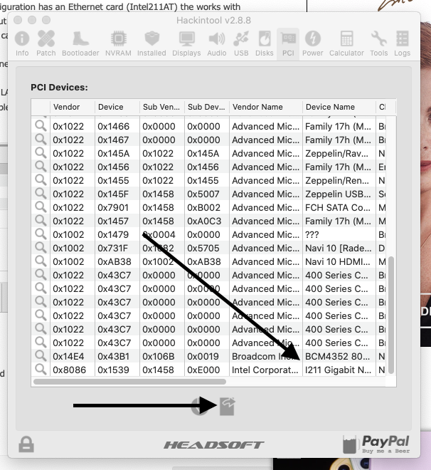

albcc Posted December 21, 2019 Author Share Posted December 21, 2019 8 hours ago, Slice said: WiFi should be en1. LAN must be en0 if present. Ok, so maybe that's the problem: my configuration has an Ethernet card (Intel211AT) the works with "SmallTree-Intel-211-AT-PCIe-GBE.kext" but if I install the kext a) is not recognised as built-in=true and I can't find any parameter equivalent to clover fixlan (and I have NO IDEA how to fix lan) b) is always listed as en1 (even removing networkPreferences.plist) So I removed the kext (since I don't need LAN connection)...but maybe it's not the smartest thing to do. Do you think this could generate the problem? So my actual network config is: Link to comment Share on other sites More sharing options...

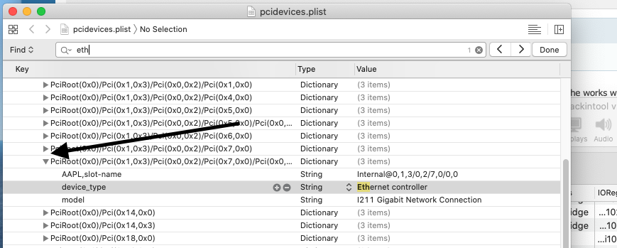

albcc Posted December 21, 2019 Author Share Posted December 21, 2019 I found the solution, - injected the kext again - removed networkPreferences.plist - added built-in 01 in my pcie card ethernet as mentioned here https://khronokernel-2.gitbook.io/opencore-vanilla-desktop-guide/troubleshooting/troubleshooting If you have troubles find the correct pcie for the card use hackintool-> PCI Tab> export data> find your LAN CARD Now I Have ethernet en0 Thanks for the help! 1 Link to comment Share on other sites More sharing options...
