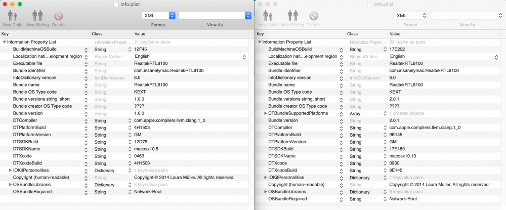

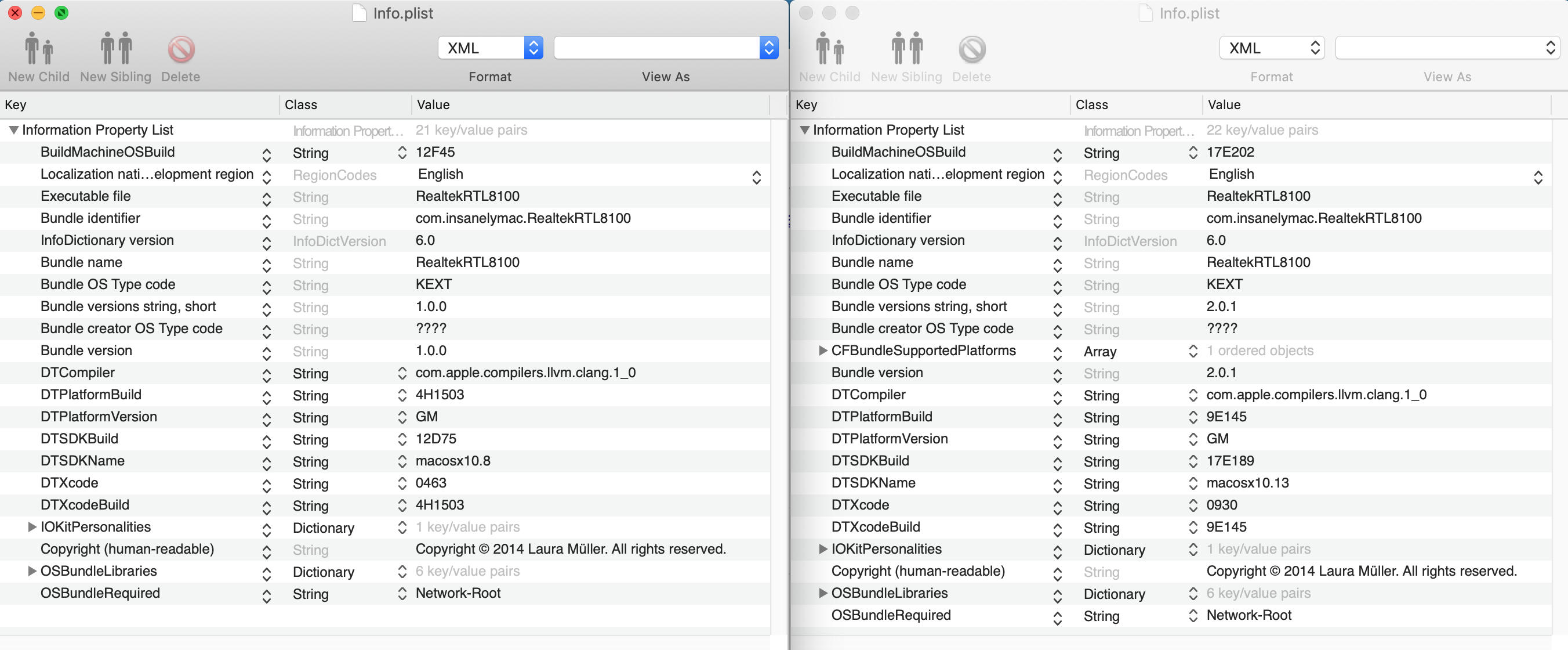

matgeo Posted November 9, 2019 Share Posted November 9, 2019 (edited) Today something strange (but interesting) happened.I have a Kabylake-r laptop (Intel 8250u) which always idles at 1.2ghz with pkg power at minimum 1.38.Today I replaced RealtekRTL8100.kext (from Mieze RealtekRTL8100) with this one : (link removed)After rebooting my cpu idles at 1.2ghz (as always) but thit time minimum pkg power is at 0.6!!!That has a positive impact at both battery consuption and heat producing.If anyone willing to try just let me know :1) If the above statement happens to you also , and2) If ethernet is working , since I only use wifi. Terminal Saved Output.txt Edited November 10, 2019 by matgeo Link to comment https://www.insanelymac.com/forum/topic/341089-to-anyone-who-uses-realtekrtl8100kext/ Share on other sites More sharing options...
Cyberdevs Posted November 9, 2019 Share Posted November 9, 2019 @matgeo Both of these kexts are essentially made by @Mieze but the second link is an older version (v.1.0.0) and the one that you have been using is the source code to the original Xcode project which you might have compiled yourself, so please remove the link to the Tony's site and attach the kext file to your original post. You can also find the latest stable version here at: Thanks. Link to comment https://www.insanelymac.com/forum/topic/341089-to-anyone-who-uses-realtekrtl8100kext/#findComment-2696633 Share on other sites More sharing options...

Mieze Posted November 10, 2019 Share Posted November 10, 2019 RealtekRTL8100.kext disables Active State Power Management (ASPM) as this feature is broken on some machines / chips. In case it's enabled on affected platforms, the NIC won't work properly. That's the reason why I decided to disable it. I'm well aware of the fact that this has a negative impact on power consumption but due to the lack of documentation and hardware to test, I see no other way as a working configuration has precedence of power consumption from my point of view. Mieze 1 Link to comment https://www.insanelymac.com/forum/topic/341089-to-anyone-who-uses-realtekrtl8100kext/#findComment-2696796 Share on other sites More sharing options...
