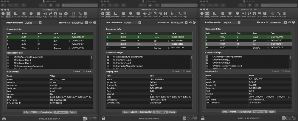

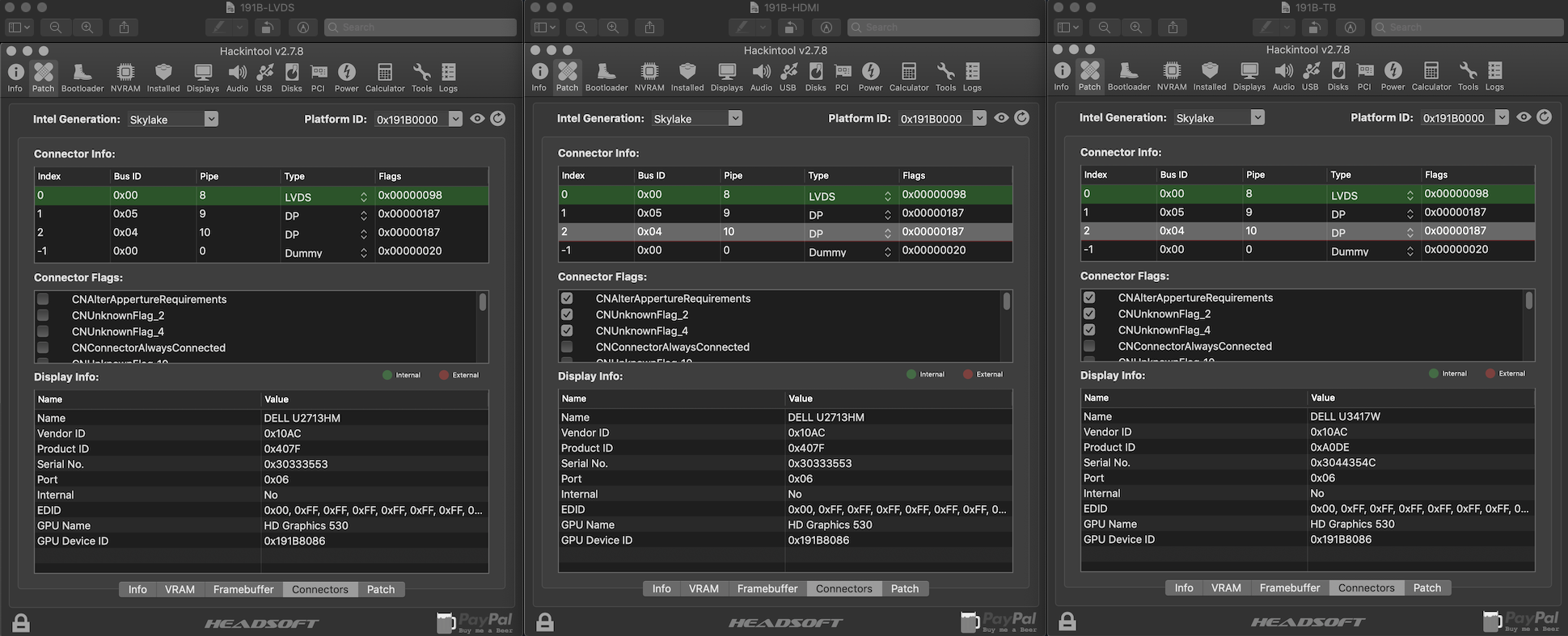

takeawaydave Posted September 5, 2019 Share Posted September 5, 2019 Running Mojave 10.14.6 (18G95) on a Dell Precision 7510 and trying to get all framebuffers working properly. The following CPU is being used: https://ark.intel.com/content/www/us/en/ark/products/89608/intel-xeon-processor-e3-1505m-v5-8m-cache-2-80-ghz.html The actual Device ID of the iGPU is 0x191D. There are the following graphical outputs: mDP HDMI Thunderbolt Clover 5058 (update to date at time of writing) is being used and up to date versions of Lilu 1.38, WEG 1.3.1 Till now I've been running with the following config: with Model Name: MacBookPro13,3 When using 191B: LDVS - Ok HDMI (no audio) : 1920x1080 Thunderbolt (no audio) : 3440 x 1440 no mDP 191B-config-ioreg.zip is attached. When using 1912: No LDVS (as expected since this arrangement is targeted for iMac17,1 HDMI (with audio): 1920 x 1080 Thunderbolt (with audio) : 3440 x 1440 no mDP 1912-config-ioreg.zip attached Question: How can I get audio working as with 1912 on the 191B laptop config ? Link to comment Share on other sites More sharing options...

takeawaydave Posted September 6, 2019 Author Share Posted September 6, 2019 @zkingtut Happy to say found an improved monitor setup with 193B0005 and got 2 External monitors and laptop screen working in full resolution! Now I could really do with the audio devices working on each of the connections. Link to comment Share on other sites More sharing options...
