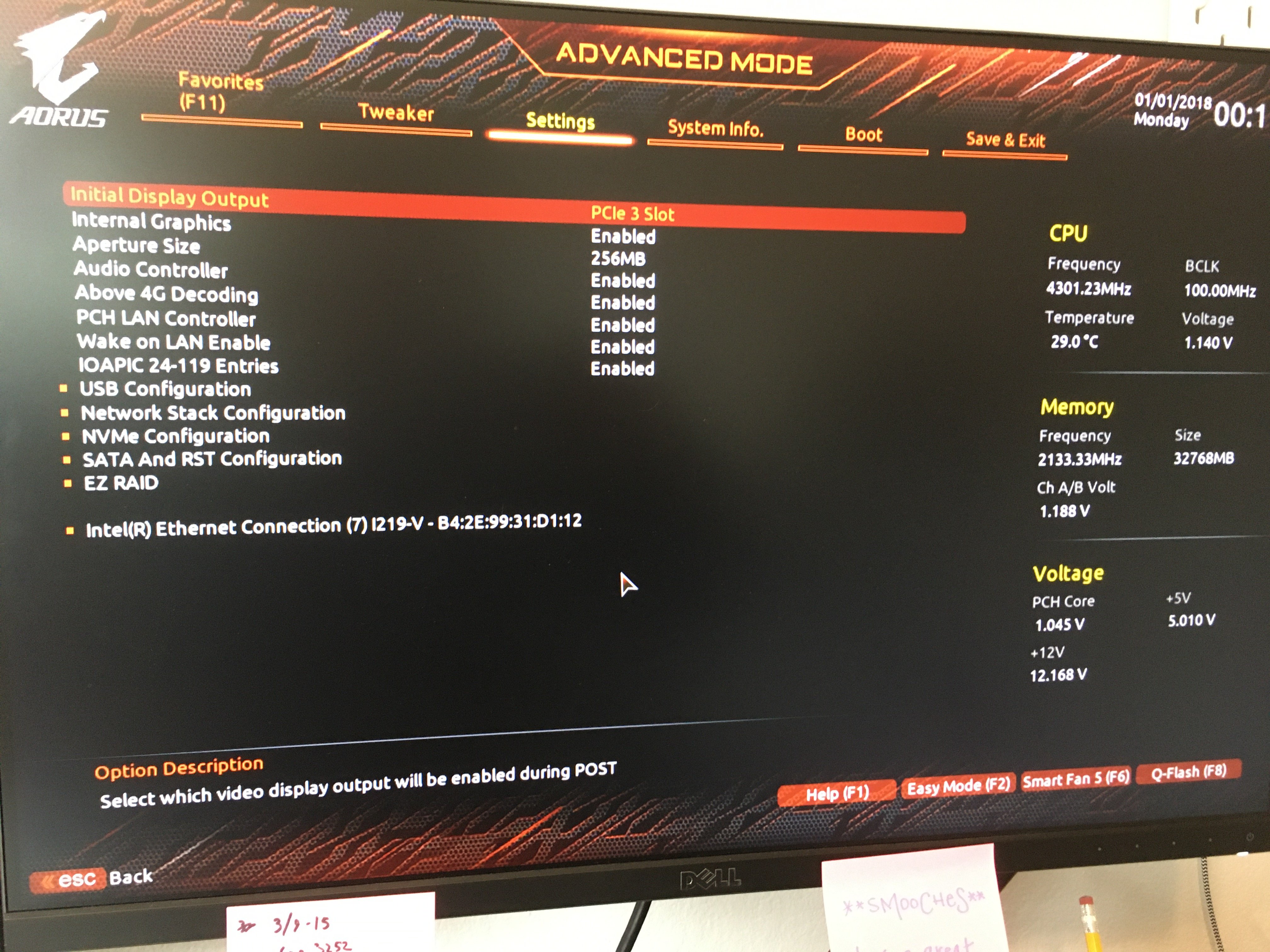

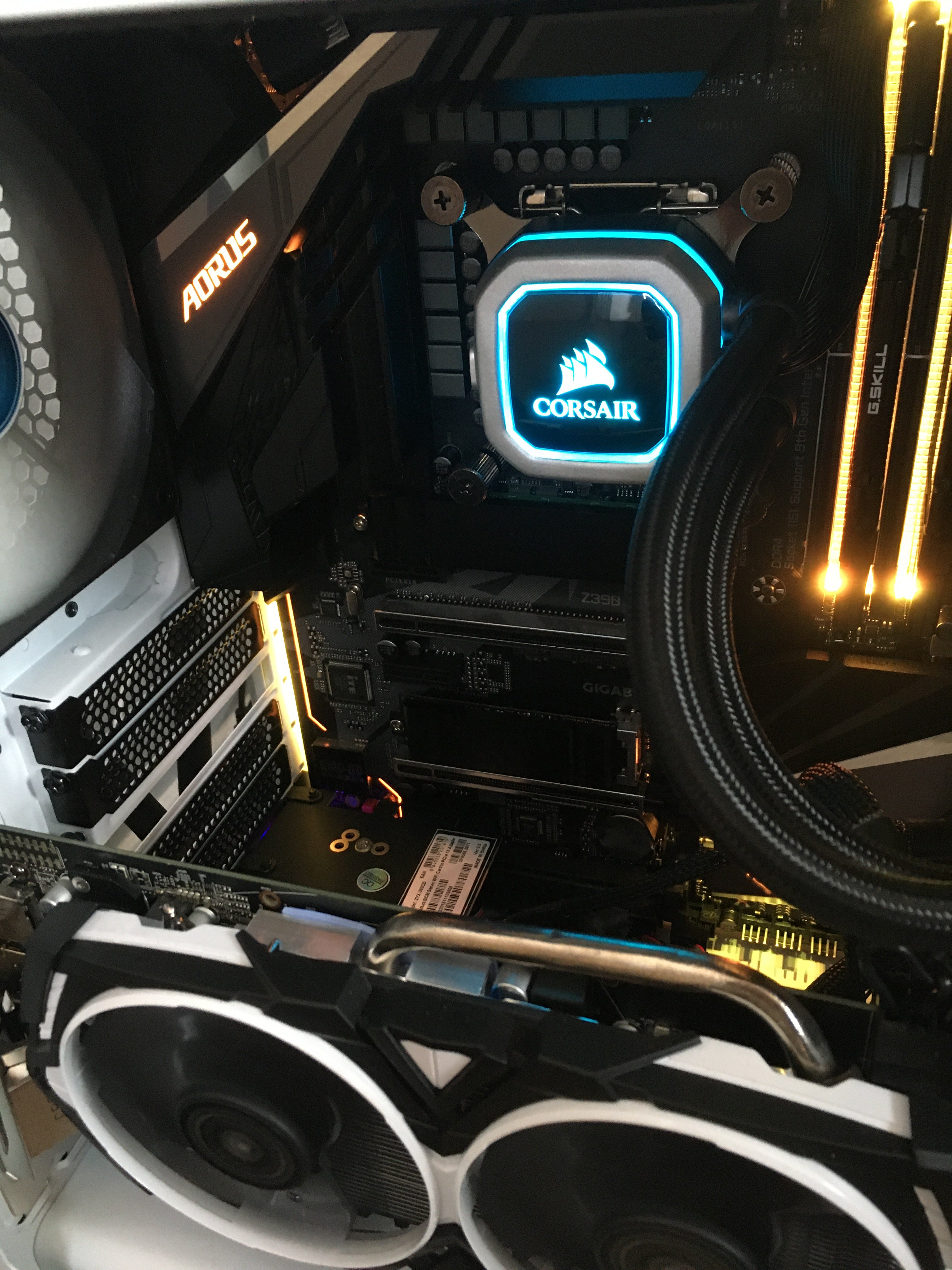

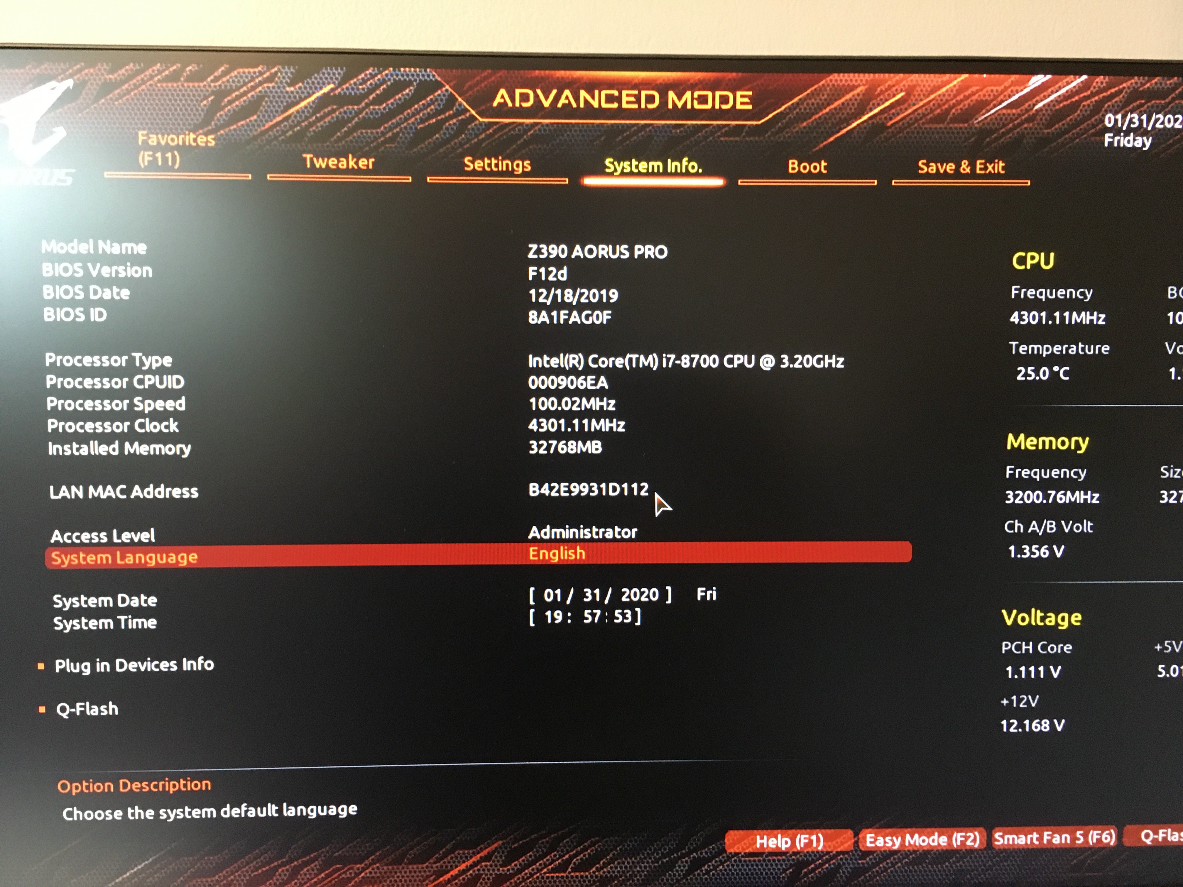

Very odd, just did as you said and same deal? This was tried using my older 10.15.12 boot drive as well.
I attached the picture as I believe my PCI card is in a different slot (closest to the bottom) as well as my wifi car adaptor and didn't know if that would potentially affect anything? I'm kinda at a loss, should I try the open core version maybe?
3E6038E1-BBA4-4A2E-B5B3-591A5FB748C4.thumb.jpeg.7aad6cee87cf5aac00f587a57a4e4d3e.jpeg3E6038E1-BBA4-4A2E-B5B3-591A5FB748C4.thumb.jpeg.7aad6cee87cf5aac00f587a57a4e4d3e.jpeg
Edited by stavidawg
Share this post
Link to post
Same outcome :(
The only thing I can think of is if I'm missing something in the bios at this point?
Is there a certain USB port I should be using for the install?
I am using a NVME Intel 660p, but that hasn't given me any issues in the past.
Share this post

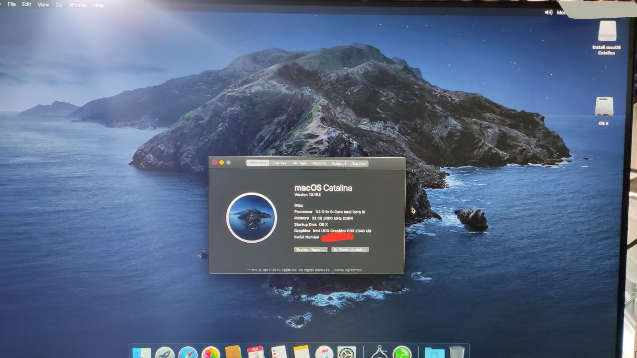

Update:
After trying open core (it not working) but then trying the clover again, I no longer get the circle with line.
However, it seems that there is some issue with the USB ports, as my mouse and keyboard are non-responsive (occurring using both different boot drives: 10.15.2 (your first refi) & 10.15.3 (your first efi with the two updated drivers). I have my computer dual booted, and windows works fine so I couldn't think its a bios update issue.
When booting into "install Catalina" I am able to get to the screen where it asks what language I wan't to use, but cannot select anything.
When booting into my old install, I get to the login screen but cannot use mouse or keyboard. I can tell it is not frozen here though as the cursor for my password will blink. The login page will also go to sleep at which point plugging in any usb does not register anything, but I can wake it via my power/restart/sleep button on my desktop case.
Any suggestions?
(edit: Mouse and keyboard use Logitech usb dongle and are recognized as true keyboard/mouse, alternatively tried using older hardwired mouse and have tested all the USB ports. )
Edited by stavidawg

31 minutes ago, stavidawg said:
Update:
Any suggestions?

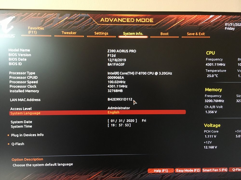

What bios revision are you using for your board and just to double check what model board is it?
you have a unique problem going on here as this has never been reported before,
your not trying to add your own usb kext or ssdt are you?
Edited by AudioGod
Share this post
Link to post

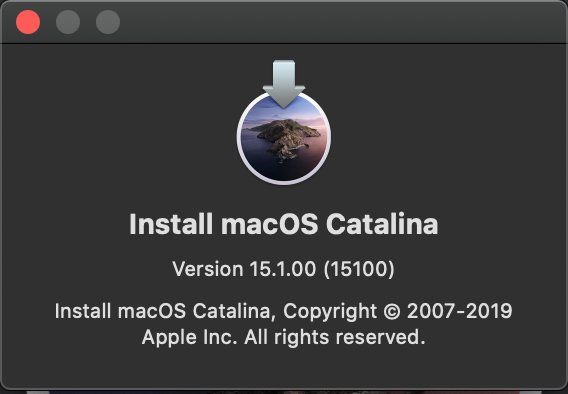

F12d, Z390 AORUS PRO.
I am not adding in anything else in there.
The Catalina installer version I am using with you EFI folder is 15.1.00image.png.90f673fa8d0c492964bbfeda5687e1df.png
Share this post
Link to post

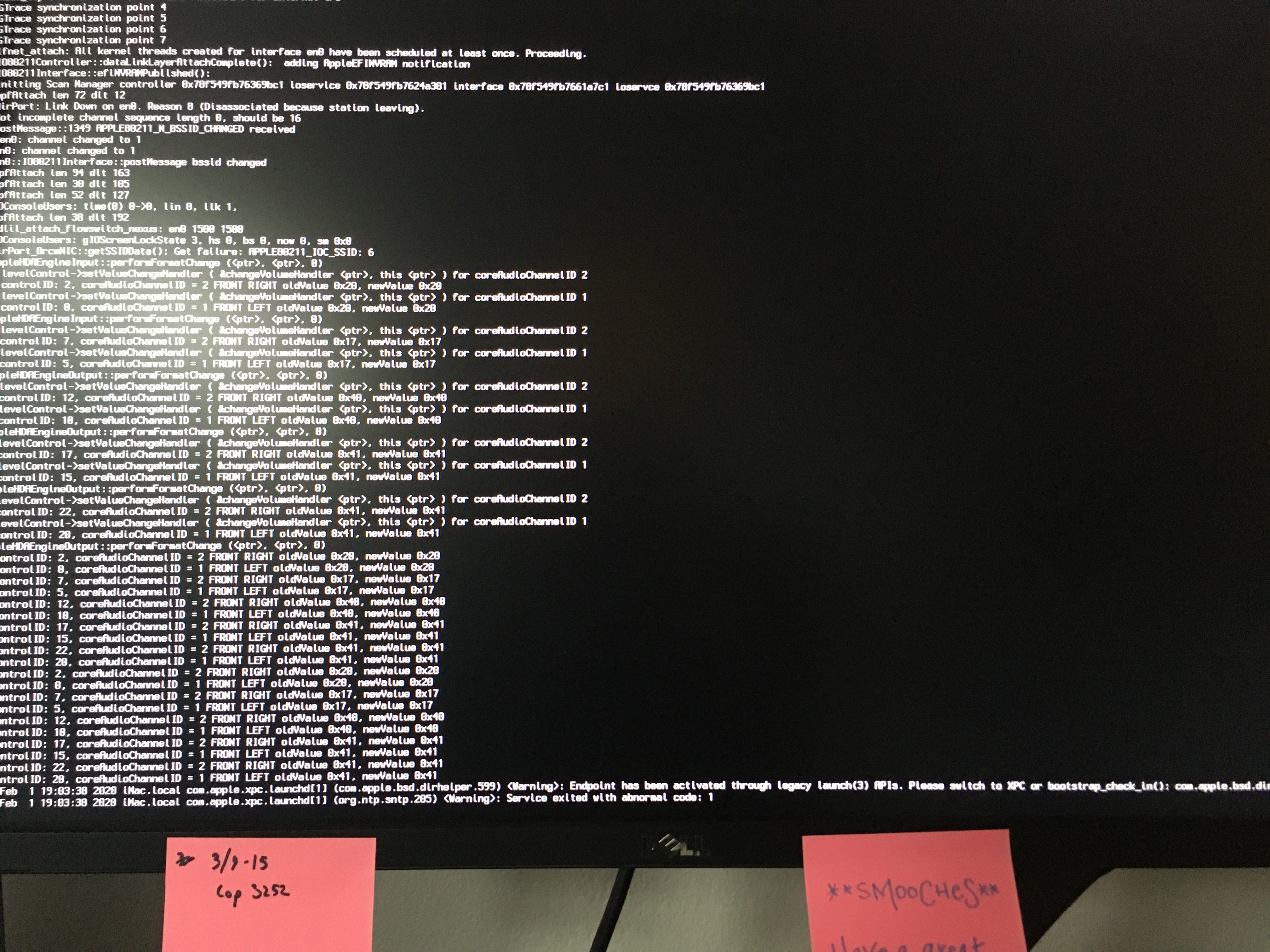

I haven't been changing the SN, MLB, UUID, so perhaps that's the problem? How do I go about finding and inserting these values?
When I did a versos boot I get the following error before the "lock" screen boot:
"Warning: Endpoint has been activated through legacy launch(3) APIs"
Doing a little digging, I'm wondering if the Graphics card is throwing the issue, as this Redditor got the same code which was being caused by his graphics card?
Share this post

BIOS SETTINGS (Bios Revision F11)
 Enter BIOS  Press F12  Enter Setup
 Save & Exit  Load Optimized Defaults
• Boot -> Windows 8/10 Features -> Win 8/10WHQL
 Boot -> CSM Support -> Disabled (Can be set to Enabled if need be but try to have it set to Disabled first)
 Favourites -> Extreme Memory Profile (X.M.P.) -> Profile1
 Favourites -> VT-d -> Disabled (Can be set to Enabled or Disabled, Your choice)
 Settings -> IO Ports -> USB Configuration -> XHCI Hands-off -> Enabled
 Settings -> IO Ports -> Internal Display Output -> PCIe 1 Slot
 Settings -> IO Ports -> Internal Graphics -> Enabled
 Settings -> IO Ports -> DVMT Pre-Allocated -> 64M
 Settings -> IO Ports -> DVMT Total GFX0-Allocated -> 256M
 Settings -> IO Ports -> Aperture Size -> 256MB
 Settings -> IO Ports -> Audio Controller -> Enabled
 Settings -> IO Ports -> Above 4G Decoding -> Enabled
 Settings -> IO Ports -> USB Configuration -> Legacy USB Support -> Enabled
 Settings -> IO Ports -> USB Configuration ->  XHCI Hand-off -> Enabled
• Settings -> Miscellaneous -> Software Guard Extensions (SGX) -> Disabled
 Settings -> Platform Power -> Platform Power Management -> Enabled
 Settings -> Platform Power -> ErP -> Enabled
 Settings -> Platform Power -> RC6(Render Standby) -> Enabled
 Save & Exit  Save & Exit Setup
