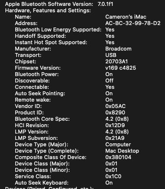

I have tried with all different combinations of the kext's you gave me. Still slow internet, laggy mouse when doing a upload test, jittery mouse in normal use.
Share this post
Link to post
21 minutes ago, Cameron Nicholson said:
Sorry, had to go to bed.
Make sure you have your Fenvi card on the last slot of your motherboard and the header cable on the F_USB2 connector

Sorry guys I went to bed then work. I am using the EFI for 12d without any relating kexts, it seems to be working better, I think. However this is still what system info reports...
Edited by Cameron Nicholson

      OpenCore 0.6.3 with onboard Bluetooth and WIFI Enabled and Working 21/10/2020.
