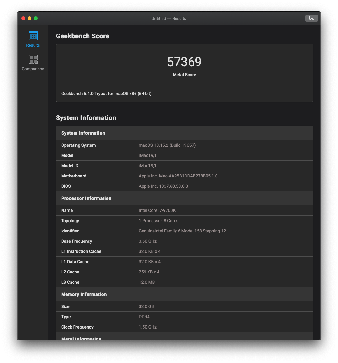

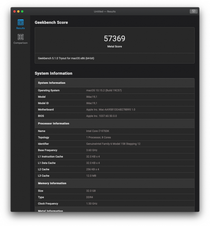

Just now, benjiolino said:
Oh wow I'm sorry you are right. I just researched and you can find a lot of websites the claim it has the 9900KF but you find more that claim 9900k. I guess that's fake news then and Linus is wrong. Pahh. Thanks for your help.
I did a geekbench on a real iMac just to show you.

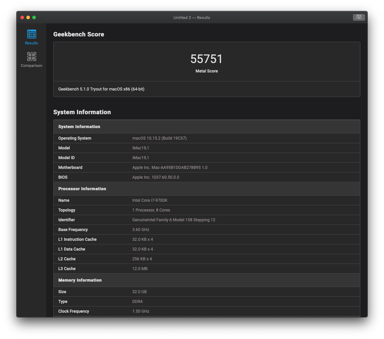

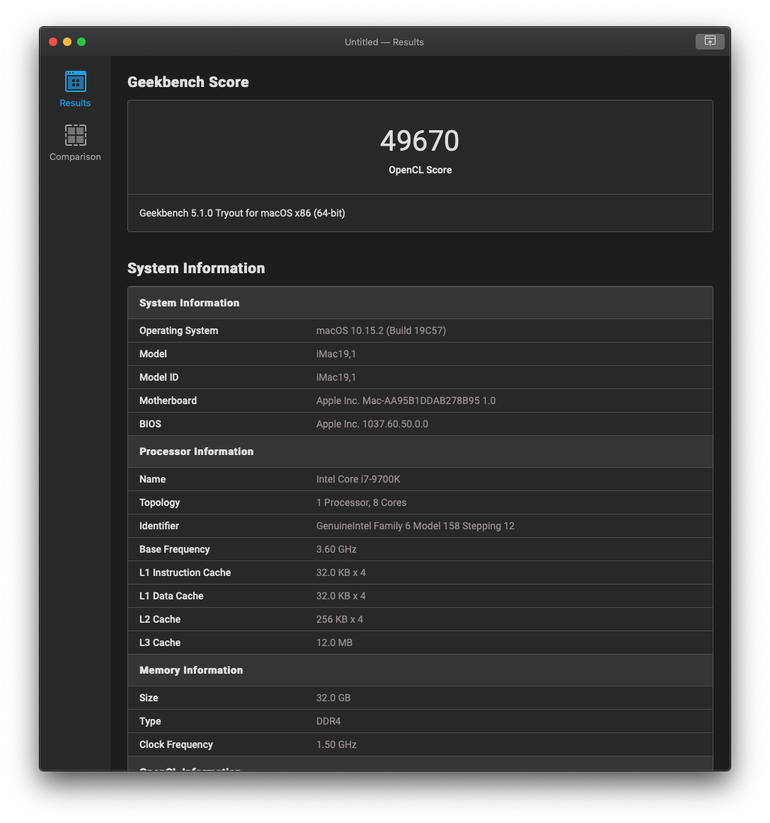

Done some more GPU testing with GeekBench 5
System setup is no Whatevergreen.kext with InjectIntel, non headless mode ie gpu 1 is intel 630 and gpu 2 is the Vega 56...
with this setup I'm able to test the intel 630 separately but alas freezes using the Metal bench test. OpenCL is fine.
with this setup Booting is faster, Final Cut Pro is more responsive and does not drop frames with HEVC very high bit videos (tested with HEVC 4K 1.5Gb 400mbps jelly fish vid) but look below...
System now Headless with Whatevergreen...
1621805972_ScreenshotGB5.Whatevergreen.Vega56.OpenCL.thumb.png.e54f74285b09bf001a45c8064d6b73b4.png
Screenshot_GB5.WhatevergreenVega56.Metal.thumb.png.d714c24761505ed71de438039eed0143.png
I kept on running the tests and this is the average score.
Screenshot_GB5.sixthTry.Metal.Vega56.Whatevergreen..thumb.png.b96422cca90c40c59ff4bb81779d7675.png
Now with this setup I Black screen at login and have to reconnect my thunderbolt 3 monitor, but as you can see bench marks are better in headless mode but Final cut takes a hit with HEVC. I will test some more...

Posted (edited)
there’s no need to tell us your results bro as we know all of this already and like I told you from the beginning having your igpu enabled fully and not in headless mode was wrong.
your gonna take a hit in performance when you do anything that kicks in the igpu as your vega will do it better on it’s own,
One  option for you would be to use smbios 1,1 with the igpu disabled so that way your vega would be fully in charge, only downside of 1,1 is your lose Sidecar but I don’t think that’s the biggest deal personally.
lastly geekbench is one bugged out program to use and take a baseline score from as the score moves around way to much to take seriously.
I hope that all helps pal. :)
on a side note, using Catalina without WEG works for sure with the vega or navi Gpus but you lose displayport output and performance in certain scenarios like playing Rocket League take a huge hit in things like the 1% lows.

38 minutes ago, AudioGod said:
It’s a problem people have with a real Mac using that hub too and it’s always the mouse that’s the problem. Just put it on a it’s own usb Input and not via the hub.
Tried that bud but no joy... all ports on back io.
Share this post
Link to post
Posted (edited)
Sorry Bro I mean don’t plug the mouse into the hub and plug it into its own input in the back of your hack. Or do you mean your mouse won’t work no matter where you plug it into hub or no hub?
Edited by AudioGod
Share this post
Link to post
are you using any sort of AIO in your build?
if so what one?
The only add-on I have is a double Firewire card PCIe in PCI X1. slot. Startech PEX1394A2
Share this post
Link to post
I get you, but In my case headless is not wrong. I saw I had an issue with HEVC so I experimented and found headless to perform poorer with HEVC/final cut. That's why I thought it might be helpful if users with or without your efi that use Final Cut Pro and have issues to test for themselves.  I'm not saying to anybody to change their setup.
Share this post
Link to post
Posted (edited)
Headless is correct I’m saying using it fully and in a non headless way like you were is wrong buddy.
my EFI is setup out of the box for headless igpu use. That’s how it’s done mate from the off.
Or you can also switch to smbios 1,1 with igpu disabled and everything will work perfectly bar Sidecar.  (19,1 with igpu disabled will give you real poor results but 1,1 with igpu disabled will give you much better results and in some cases better then 19,1 igpu enabled)
:wallbash:
I just got to add that reading all your tests your conclusion so far is to use the EFI the way I intended it to be used (with igpu enabled headless and with WEG) :hysterical:
if your injecting the igpu in clover still and you can see the igpu in system preferences then you have it set up all wrong pal. I’m only trying to help you do things the right way.
Edited by AudioGod
