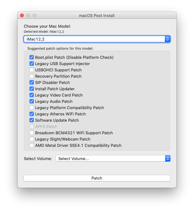

_Mirko_ Posted August 3, 2019 Author Share Posted August 3, 2019 (edited) I've managed to boot into OS X, but in Software mode only, gpu appears as: "AMD Radeon RX 580 6 MB": AMD Radeon RX 580: Chipset Model: AMD Radeon RX 580 Type: GPU Bus: PCIe PCIe Lane Width: x16 VRAM (Total): 6 MB Vendor: AMD (0x1002) Device ID: 0x67df Revision ID: 0x00e7 EFI Driver Version: 01.00.3180 I have used Mojave patcher: http://dosdude1.com/mojave/ and selected option iMac12.2, and got it running. Unfortunately no hardware acceleration, so its bit more sluggish than it should be. Not sure if I can do something about it. Here are settings that got it running attached. Not sure how to get GPU properly recognized thought. Edited August 3, 2019 by _Mirko_ Link to comment Share on other sites More sharing options...
