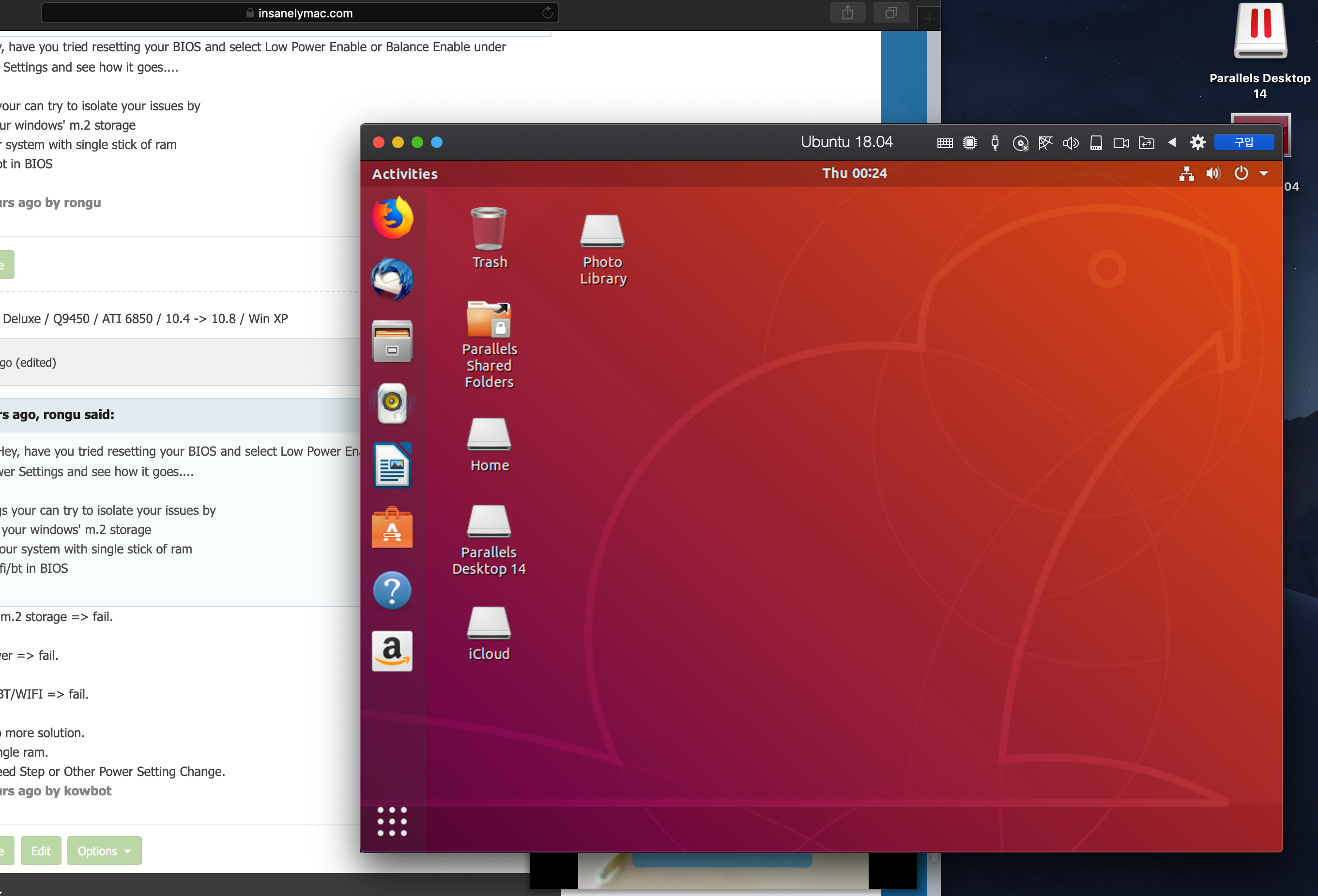

hmm it's strange.
I disable VT-d in bios how working Parallels os OS X?
+) on Parallels Windows Game working smoothly lol.

VT-d is not required for VM. It speeds up certain things such as device pass through. Not sure if parallels desktop supports any VT-d features.

u before say "VT-d doesn’t have to be disabled. I use parallels so I need it on."
what does mean u need VT-d use parallels?

@kowbot Glad you found a way to manage the freezing issues and Thanks for sharing. You might want to include the BIOS version (0057 or 0056). I'm trying to borrow one HVK to test.
@kowbot "I disable VT-d in bios how working Parallels os OS X? "
At this point of time, the biggest bottleneck with hypervisors is Direct I/O and with VT-d enable, it should help with I/O intensive virtualization. To me VT-d is good to have not must have.
If you are a PRO providing a virtual service, hosting guests, running something where you need the performance ........ then VT-d is very important.
Normal day to day, casual run additional OS ...then not that important, I can't tell if they were any difference.

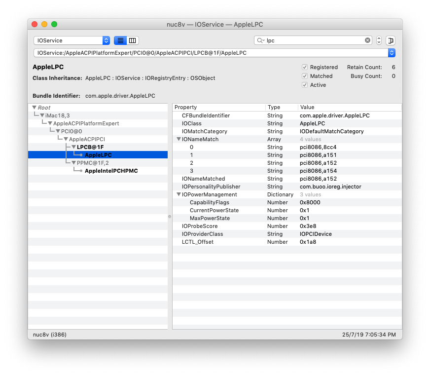

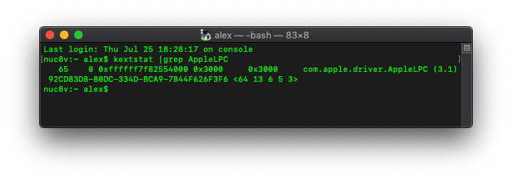

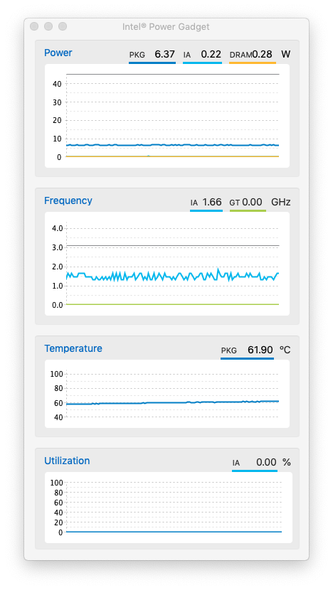

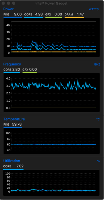

@kowbot Thanks, that means AppleLPC.kext was not loaded in your system (HVK) also. I have a HNK version and wonder why it not loading AppleLPC.kext despite device-id change in clover->devices->properties changes with "PciRoot(0)/Pci(31,0) device-id C19C0000" (according to osy it should load).
At the end of the day, AppleLPC.kext is needed for proper CPU Power Management (https://pikeralpha.wordpress.com/2013/10/05/xnu-cpu-power-management/).
To get AppleLPC loaded:
- Disable device change in clover/devices/propeties by adding a "#" to "PciRoot(0)/Pci(31,0)",  see attach picture.
- Install the attached AppleLPC_Injector.kext in clover/kexts/others.
- save/reboot and verify with command "kextstat | grep AppleLPC" in your terminal again.
- double check with IOregistryviewer

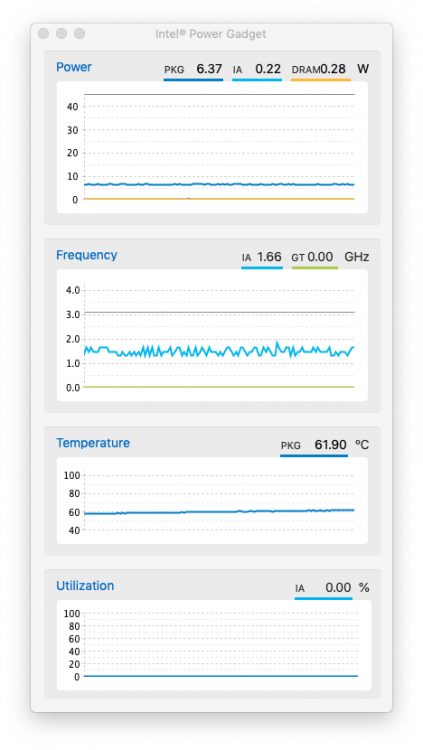

HNK & HVK should have the same LPC controller (HM175 Chipset) pic8086,a152. Attached picture & terminal LPC output are mine.
Can you or anybody test and reply, Thanks !
Managed to test on a HVK system and confirmed AppleLPC.kext was not loaded without LPC injection.
Last picture is a HVK (iMac18,2 profile) average idle frequency with AppleLPC.kext loaded. More test and time to tell.
AppleLPC_Injector.zip
Edited by rongu
Share this post

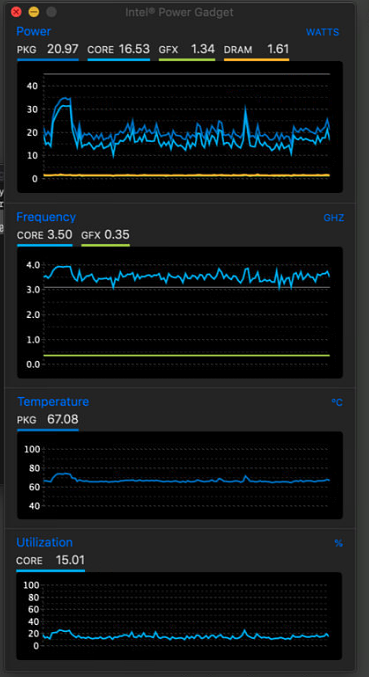

@rongu ok i merged 1.3 update. (thx @osy)
my terminal output.
  146    0 0xffffff7f86b63000 0x3000     0x3000     com.apple.driver.AppleLPC (3.1) 6DD4B940-38F9-3E34-8641-19F57B5FA0A8 <103 13 6 5 3>

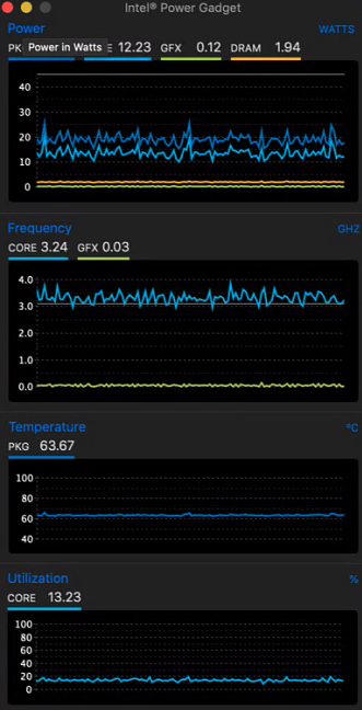

but i have one issue.
intel power gadget always core frequency > 3.0GHz
PKG watts > 20
is this iMac19,1 SMBIOS problem? or anything else?.7776562B-3E1A-4E92-931A-07719C4BB2D3-404-000001438C3A1E93
Share this post
Link to post
my terminal output.
PKG watts > 20
Maybe. Any reason why you're using iMac19,1? iMac18,2/iMac18,3 are the closest in terms of CPU/platform. Macmini8,1 is the closest in terms of overall hardware.

46 minutes ago, kowbot said:
@osy i use iMac19,1 because iMac18,3 not detected bluetooth chipset.
Thermal profiles are defined for each platform based on case dimensions, CPU step, etc. My theory is that iMac19,1's profile is more aggressive.
oh, sorry i use iMac19,2.
and i tested Mac Mini 2018 it same and Mac Mini 2018 is not use iGPU for video decoding.
