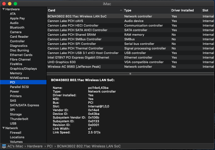

33 minutes ago, chris1111 said:
OK My AzureWave works now
Which kexts you're using?
I have Azurewave AW-CB160H (BCM94360HMB) and can't enable Bluetooth, while Wi-Fi works.
Under Mojave used BrcmFirmwareRepo, BRCMPatchRAM2 and FakePCIID_Broadcom_WiFi.

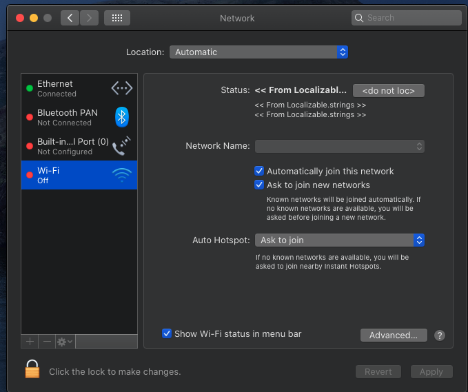

ArportBrcmFixup did not change anything it's still says status off, and not turning on, my card was working OOB on mojave :(
Bluetooth working
Edited by Sanom4
Bluetooth working
Try ask to Join network
Bluethoot work with ??
Share this post
Link to post
nothing, its works OOB, nope wifi still dead.

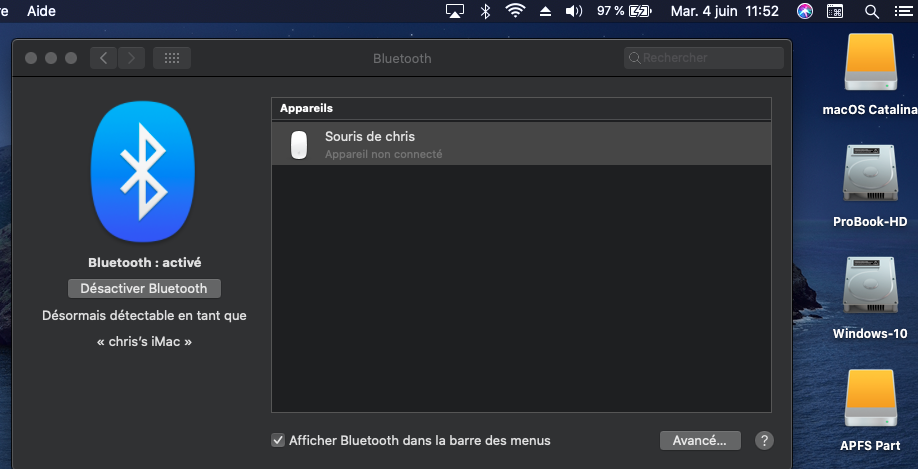

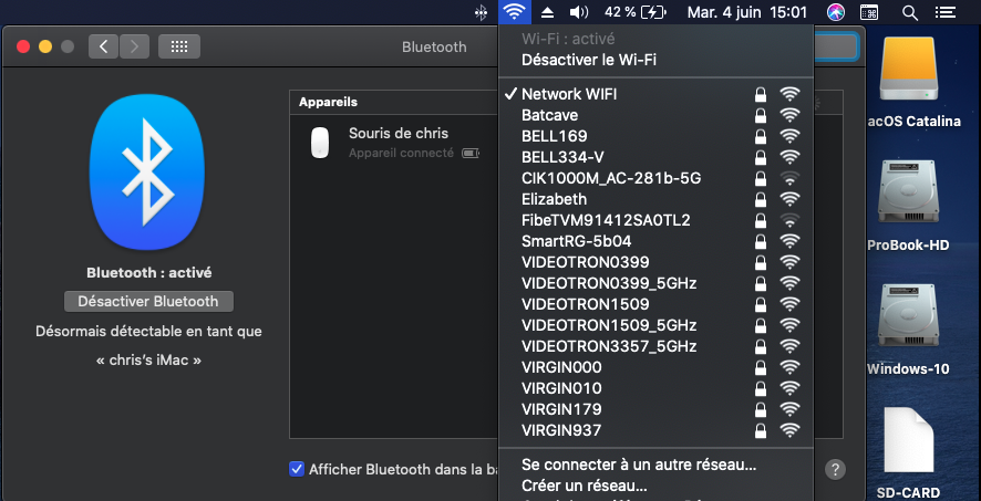

Posted (edited)
11 minutes ago, mnfesq said:
chris1111, the BT icon shows up in my menu bar and system preferences but I can't seem to pair my headphones.  Are you able to pair a device?
yes see my Magicmousse is show disconnect but I connect
EDIT *** But Now is really Disconnect :blush:
Edited by chris1111

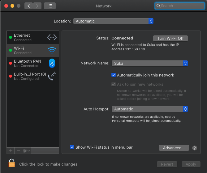

Posted (edited)
Hi guys,
The second time is the charm, with the new versions of the kexts, all works bluetooth, wifi, sound, graphics... and no glitches, lol
Thank you all
