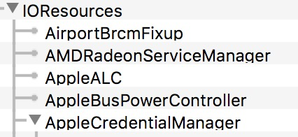

7 hours ago, Ellybz said:
Anybody has an issue with Beta 9 & airdrop not showing? (19A573a)
PS: I had to primarily re-inject the BRCM4331.kext in the IO80211family.kext for my wifi to work as Beta 9 got rid of this kext. ( I rebuild cache, etc..Obviously :))
So wifi & bluetooth are now working, however I lost Airdrop. ( Airplay is working )
Can anyone report their status with a BRCM4331 Card? Thanks.

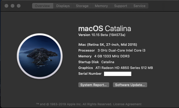

Successful update from DP8 to DP9 on my legacy Dell XPS M1530 with non metal Tesla Geforce 8600M GT...
1735703786_CatalinaDP9_19A573aonXPSM1530.thumb.png.c7d2e34c7e270c97ad79bb0af314532d.png
Full installer 8.09GB in size and the following SHA1 for BaseSystem.dmg & InstallESD.dmg...
BaseSystem.dmg 70fa11a4443e436735d06f0d5754e4e498c35bae
InstallESD.dmg e48972a28c1e2818d2802f7a103a9925a5626d10
Catalina patcher v1.1.3 working for DP9_19A573a with support for legacy non metal graphics cards (same graphics patches as DP8), thanks to @dosdude & @ASentientBot :).

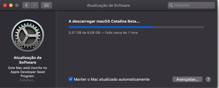

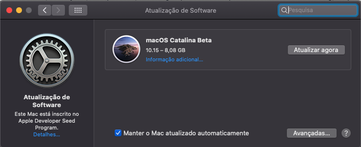

1 hour ago, Andres ZeroCross said:
Anyone get some problem??? I try to download macOS Catalina Beta from appstore https://apps.apple.com/us/app/macos-catalina-beta/id1455661060?mt=12
And when it's almost finish (just 1 minute remaining) i get this error message. Try it twice with same results.
Hmm....no, never seen that error before.
Maybe try to remove any installation files (if there are any) from /Applications and try again...?
Also, you could try switching from Dev Beta to Public Beta (it's the same build). Maybe there's an issue with the dev beta seed.
Share this post
Link to post
@Andres ZeroCross Run this in terminal:
sudo /System/Library/PrivateFrameworks/Seeding.framework/Resources/seedutil fixup
followed by
sudo /System/Library/PrivateFrameworks/Seeding.framework/Resources/seedutil enroll DeveloperSeed
Reboot and try again.
Share this post
Link to post
followed by
Rebooting now,, will report several hours later. I will try to download "Install macOS Catalina Beta.app" again. Thanks before
No problem here with AirDrop in macOS Catalina DP 9 Build 19A573a (BCM943602CS + Bluetooth)

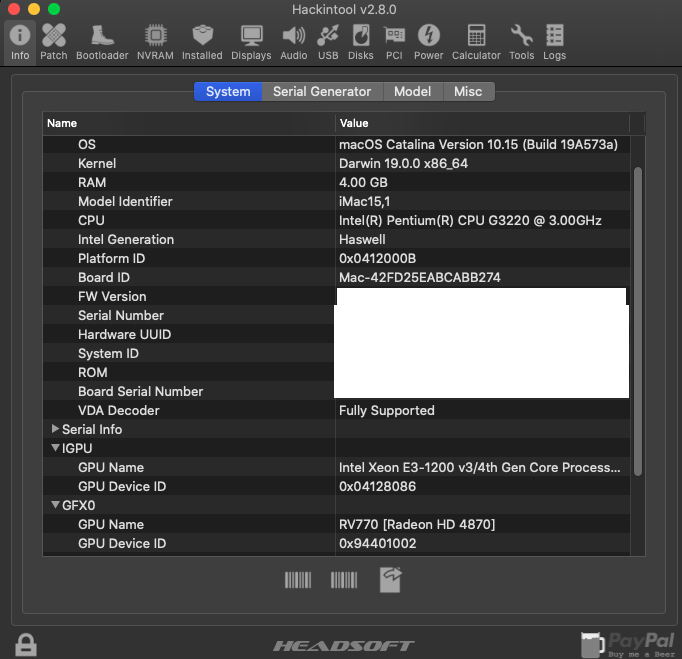

On 9/21/2019 at 4:44 AM, arsradu said:
Hi guys,
Anyone else having wake issues with RX cards and Catalina Beta 8? This used to work before. Now it just doesn't anymore. System goes to sleep just fine. But it just doesn't wake up graphics after sleep. Same config.
Update: I disabled Inject Intel. Now it does wake up the screen, but can't move the mouse pointer, and keyboard seems to be stuck, as well. Everything is pretty much frozen.
I feel this has to be related to the iGPU. And...after fiddling around with the ig-platform-id, I'm pretty sure that's the cause. Thing is...the same ig-platform-id (for headless connection) used to work before. I just don't know what to change now to make it work again...
I have the exact same problem with my RX 560. The solution was to set the iGPU as primary in BIOS.
Share this post
Link to post
Hi there!
Thanks for your feedback! I did that too... Didn't seem to make a difference though... I think the issue is related to the iGPU. I just don't know how to fix it right now.

@Andres ZeroCross I just finished downloading the installer, with no issues. So I'm guessing either something specific to your case, or something specific to the dev beta. I downloaded from Public Beta.
I just thought you might wanna know. :)
Edited by arsradu
Share this post
Link to post
This is my third download. Very slow connection from Apple Server. My Internet Connections is 30Mbps
Share this post
Link to post
I had the same issue and had to stop and restart numerous times. Took about forty minutes with a gigabyte connection.
Sent from my Pixel 3 using Tapatalk
Share this post
Link to post
@Andres ZeroCross Fixed it!! FINALLY!!!!!!
I was right when I said this happens with any SMBIOS and the fact that, with the same config, it just stopped working at some point.
But you were definitely right when you said Serial Ports! That option was enabled, and despite the fact that I don't remember giving much importance to that before with Catalina (when it worked), and despite the fact that, with the same option enabled, Mojave works just fine, THAT ACTUALLY FIXED IT! :)))
So yeah, it was an option in the BIOS, it wasn't the config, it wasn't the SMBIOS, and it looks like it is something that might have been recently added to MacOS, since it didn't happen with previous versions of Catalina (though I might have disabled that option before, without realising how important that was), and it definitely didn't happen with Mojave.
So yeah, to sum up:
1. SMBIOS change did nothing
2. fresh installation did nothing
3. setting the iGPU as primary, in my case at least, it didn't change anything.
What did make the whole difference, and I honestly didn't expect it to make all that difference, since to me it looked like the problem is iGPU related...not..serial ports related...was disabling Serial Ports in BIOS.
So yeah, a HUGE thank you to everyone for their feedback on this issue. You guys are awesome! :)

2 minutes ago, Ellybz said:
Andres ZeroCross
@Andres ZeroCross Airdrop works with BRCM4360 works because it's present in the IO80211 family kext. My question was related to those with BRCM4331 that has to be re injected. Thanks for your input :)
Your first line questions above is about "Anybody has an issue with Beta 9 & airdrop not showing? (19A573a)", you didn't write BCM4331 as main issue in your first questions. So i give answer about your Main Questions
PS : AFAIK Airdrop is about Bluetooth, not wifi kext
Share this post
Link to post
Yes I did, I wrote" Can anyone report their status with a BRCM4331 Card? Thanks."
No big deal. thanks anyway :). AFAIK, Airdrop needs WIFI to be turned on, but it does not need to be connected to a network.
Edited by Ellybz
