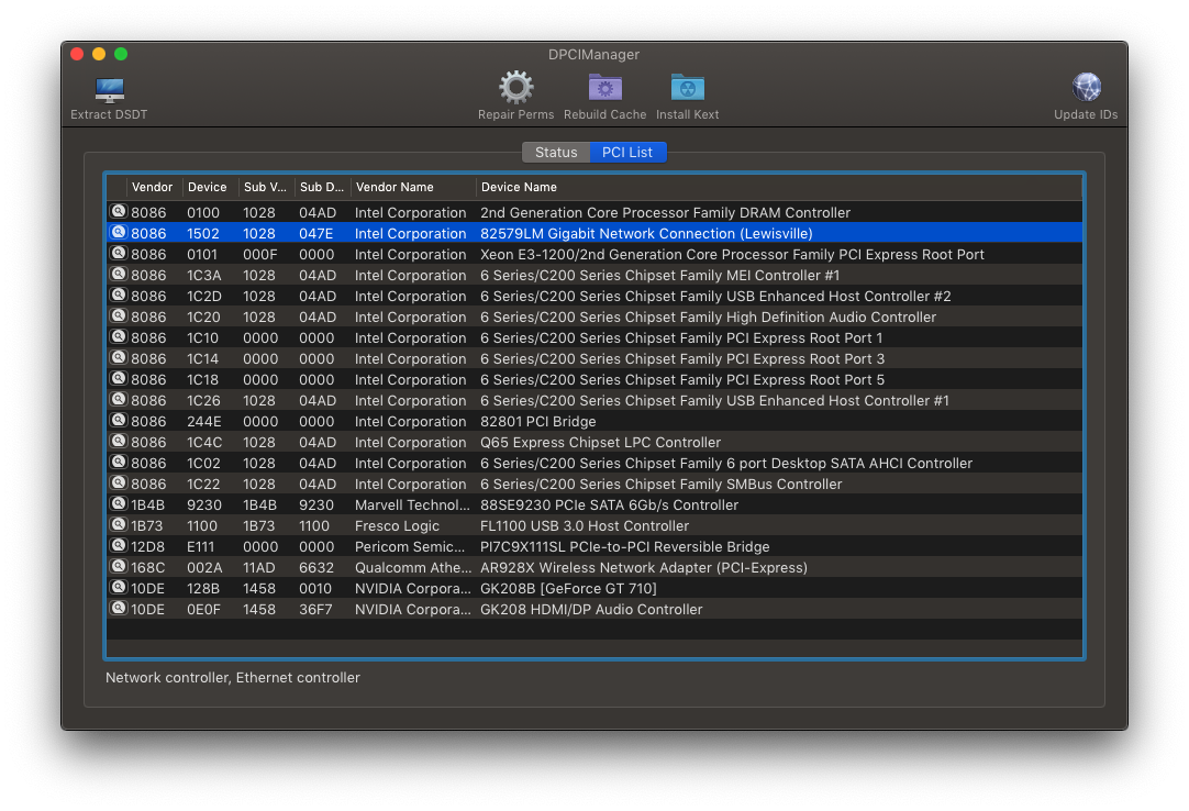

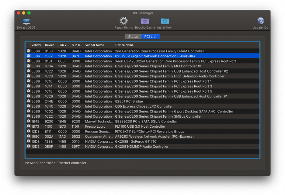

chris1111 Posted April 21, 2019 Share Posted April 21, 2019 (edited) Remove previous install kext Try to using this kext in /EFI/CLOVER/kexts/Other/BCM5722D.kext reboot the laptop and see if the network is connect ? Use DCPIManager to view all device in PCI List /Infos on your machine Post a picture of PCI List like the below pics BCM5722D.kext.zip DPCIManager.zip Edited April 21, 2019 by chris1111 1 Link to comment Share on other sites More sharing options...

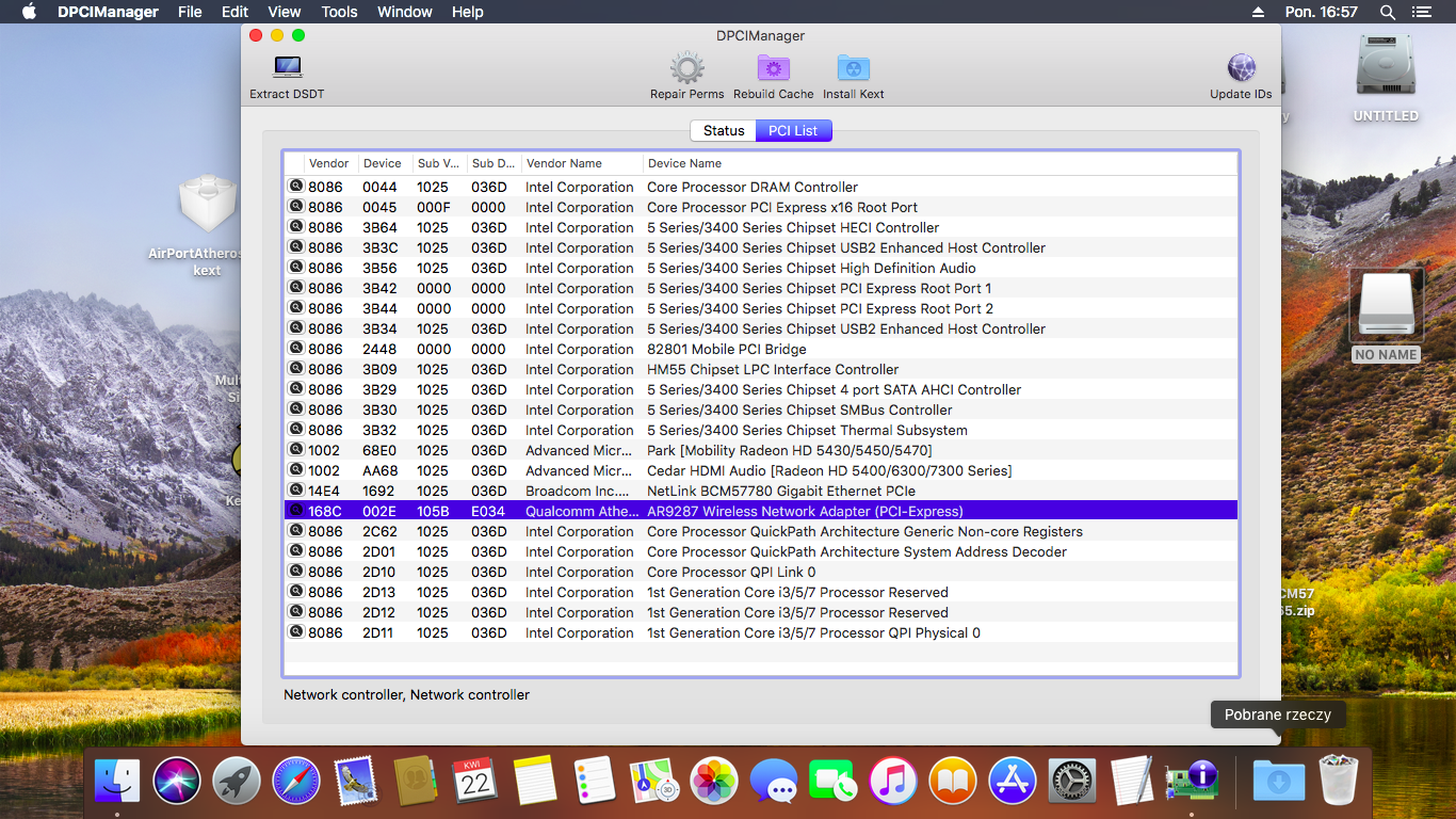

teargas666 Posted April 22, 2019 Author Share Posted April 22, 2019 Dear All, please find enclosed screenshoot. 21 hours ago, Hervé said: Have you identified your exact model of Broadcom LAN card or, at least, its PCI id? Re: wireless, Atheros AR5B597 does not exist. If you meant AR5B97 (PCI id 168c:002e), it's fully supported with the default Atheros kext provided in macOS up to High Sierra but it just won't work OOB; you need to apply a DSDT/ACPI patch or patch Atheros40 kext to inject the card's id in the Info.plist file. See here for full details. DSDT/ACPI patch is preferable. Nope, I've just install kexts and try to connect to WiFi. Unfotunateli its not clear for me how to patch the DSDT. Could you help me with this issue? I've attached dropped DSDT. DSDT.aml Link to comment Share on other sites More sharing options...
teargas666 Posted April 23, 2019 Author Share Posted April 23, 2019 10 hours ago, Hervé said: Ok, it's definitely an AR5B97, a Foxconn card of some sort according to the subbvendor id 105B. Here's your modified DSDT; you could have managed yourself, it already contained an entry for a wireless card... DSDT.aml.zip Re: LAN, it's a Broadcom-based NetLink BCM57780 GigEthernet card; 'should be supported OOB according to this old thread. 'haven't checked, I let you do it. Thank you. I have to put it to /Extra? Link to comment Share on other sites More sharing options...
