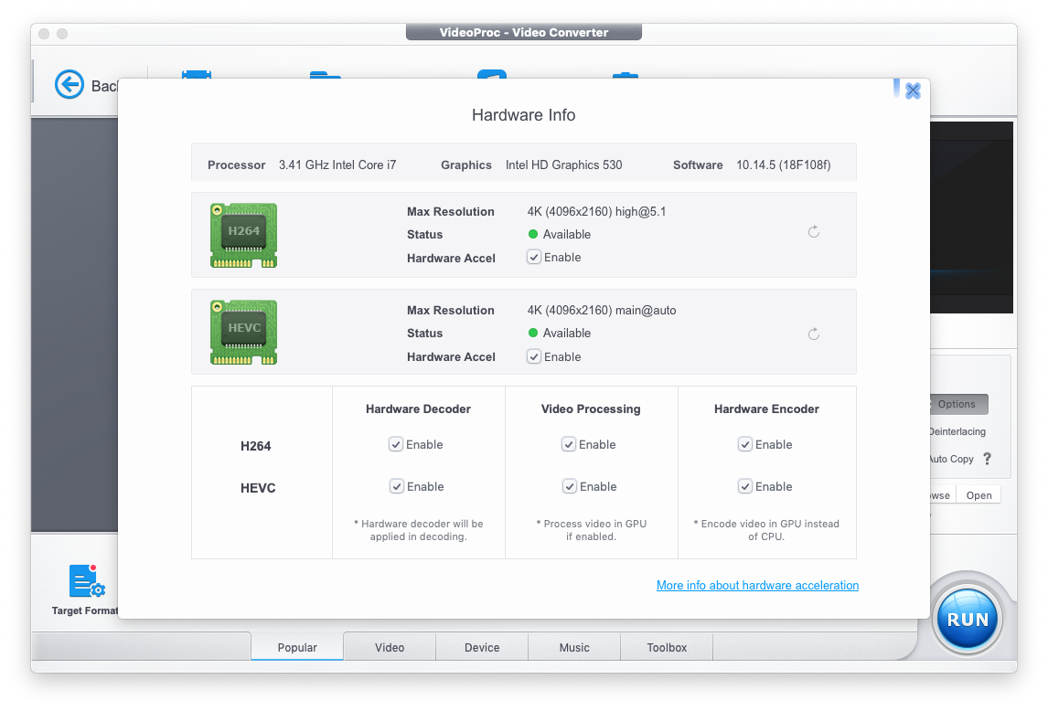

The user you were replying to showed a VideoProc screenshot that indicated hardware encoding was enabled, but their iGPU was disabled. It means the system selected the AMD encoder instead.
I think there's a lot of assumption that 'hardware encoder' means 'intel Quicksync' but that's no longer the case. Unfortunately we have no way to easily test which encoder is actually used, other than annoying cpu/gpu utilization graphs. However, there is a slightly better way. I suggest everyone trying to test video encoder capabilities run these two commands:

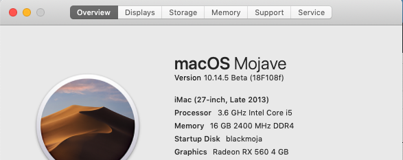

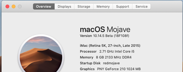

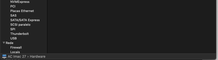

Update made, really easy and smooth...
But is hilarious... in my about this Mac says iMac 19,1 and at the bottom it says AC's Mac mini... lol

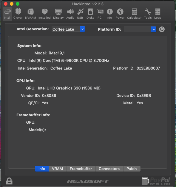

Posted (edited)
hack 1 signature
SMBIOS iMacPro1,1
-wegoff
-disablegfxfirmware
device/fake ID --> 0x3E988086
ig-platform-id --> 0x3E980003
inject intel spuntato/flaggato
The iMac reference is based on your SMBIOS.  The MacMini reference at the bottom of System Information is based on your computer name in Sharing preferences.

Posted (edited)
Hi @mnfesq
Thanks for the clarification, I didn't know that, and I'm going to correct that right away for cosmetic sake... lol
PS: Corrected, thanks man...

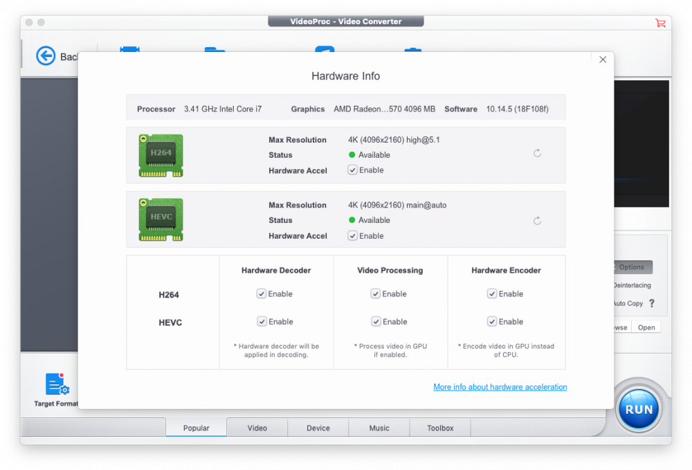

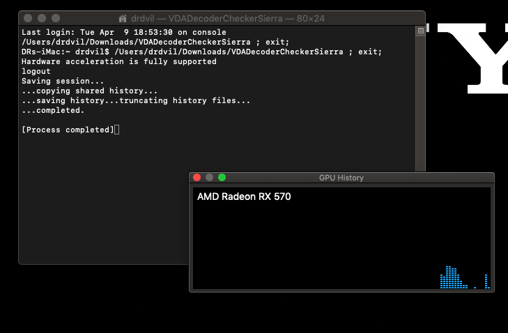

With the latest beta (18F108f) video hardware acceleration is fully supported with dGPU only, without WEG and without dummy kext! Netflix and Amazon video prime are working perfectly and no green artefacts so far with video export!
Excellent!

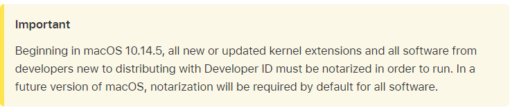

Haven't updated to the latest yet, but looks like it'll be smooth.
Just asking:
Got it from here. Does it mean that future unsigned kexts won't be able to run?

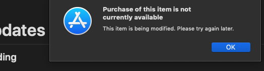

Itunes keeps crashing for me in this update. Also, can't update apps in App Store...  Rest seems fine.
Edit: Fixed app store by re-logging, apparently it was wrong region (I'm from Europe)

2 hours ago, xtddd said:
should change the smbios? thank you
I'm currently using imacpro1,1. In my experience if you are planning to use dGPU only you should use the imacpro1,1 smbios, however I haven't checked this extensively.
