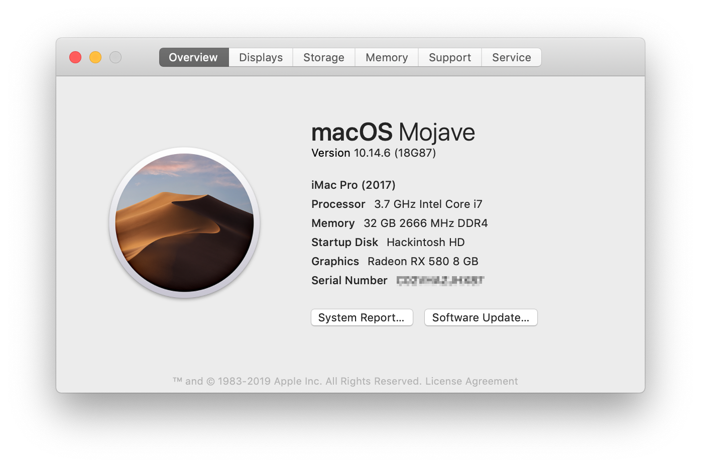

it seems ok, all USB port word. but the front usb2 shows usb3.1.
Thanks MaLd0n.

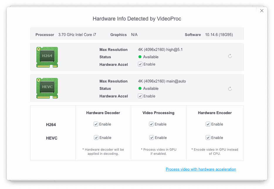

@MaLd0n Hey, first of all thanks alot for this guide! It was the only one that let me install and boot on my new Z390 M Gaming.
The only problem I have is, that I don't have video hardware acceleration (Preview with images doesn't work, for example).
AFAIK, I have to enable iGPU in the bios to make it work. But whenever I set it from auto to enable, I can't boot anymore and get a Couldn't allocate runtime area error.
Do you have any idea what the problem could be or how to fix it?
Well, the iGPU seems to work when I delete WAG and add 0x3E980003 as AAPL,ig-platform-id.
