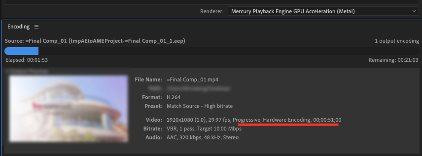

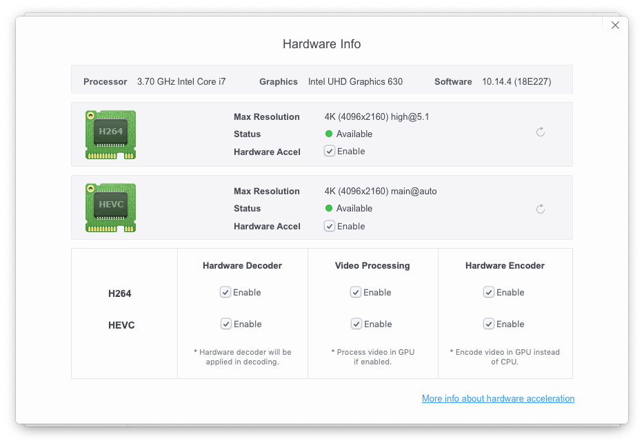

2 hours ago, larabee said:
@glasgood
I used the SMBios iMac 18.3 and whenever I export using Final Cut pro + H264 format, the hackintosh completely freezes.
Can you help me out?
Please attach your EFI folder. I’m using SMBIOS for Mac Mini 2018 and FCP is working.
I’m meantime, check BIOS settings are set for:
Chipset  Internal Graphics  Enabled
Peripherals  Initial Display Output  PCIe 1 Slot
Chipset  DVMT Pre-Allocated  64M ( try 128 )
Edited by glasgood
Share this post
Link to post
Thanks a lot for your response. I used the same EFI as yours. It's working fine but whenever I export using H264 it freezes up. Exporting using Apple Pro Res is fine.
Even  though other softwares report that Hardware Encoding is supported.
Updated:
I managed to get it to export H264 but it's still slower than a real mac by a large margin by  ticking Load VBios and Inject Intel then add 0x3E920003 to ig-platform-id in Graphics
Then Adobe Media Encoder and FCPX starts using the iGPU to encode H264

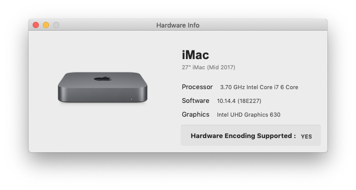

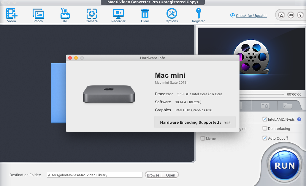

3 hours ago, larabee said:
Just wondering why you'r macx-video reports 27" (iMac Mid 2017) with an image of a Mac Mini. I ran macx-video on my hack and Hardware Info is normal.
207649688_Screenshot2019-05-01at10_50_15.thumb.png.2ceb8d50ec9924c51461071e8145c51a.png
Edited by glasgood
Share this post
Link to post
I followed your guide and choose mac mini because it uses the coffee lake processor just like mine. Everything works fine but I have problem with H264 hardware encoding.
I tried the iMac and it works. I think adding 0x3E920003 to ig-platform-id makes it works.

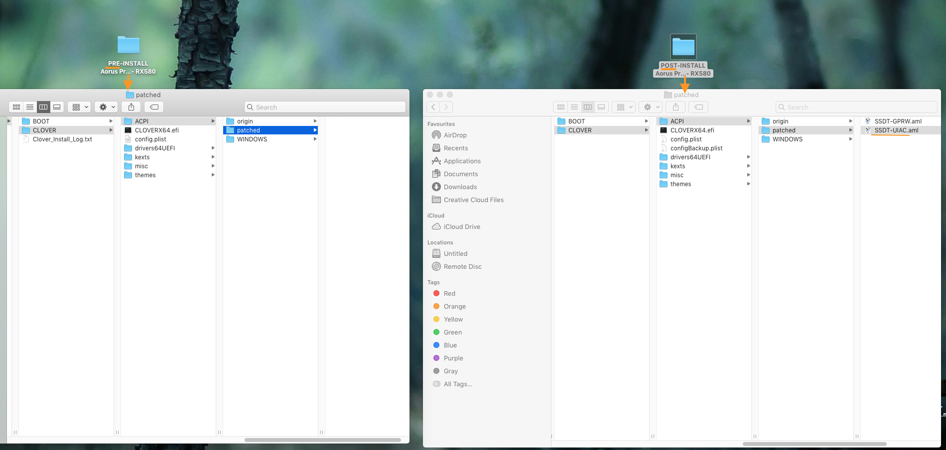

3 hours ago, yegtrash said:
Hey man,
I have a problem with my USB ports when booting into macOS with the internal SSD. Both my mouse and keyboard aren't being picked up, but when booting through the USB installer it's completely fine. Have any suggestions? Thanks.
Do you have Aorus Z390 Pro motherboard?  I suspect not.  My SSDT mapping for Aorus Z390 has disabled those USB ports on your motherboard. Remove SSDT from Clover / ACPI / Patched.
PRE-INSTALL Aorus Pro Z390 EFI ( USB Installer )  has no SSDT for USB ports fix. Thats why you have working USB ports via ports limit patch & USBInjectAll.kext using USB installer.
POST-INSTALL Aorus Pro Z390 EFI, it has SSDT for USB ports fix.
Hence why I suspect you have a different motherboard.  Delete SSDT-UIAC.aml from Clover / ACPI / PAtched and follow guide below for USB ports fix.
524277149_Screenshot2019-05-05at11_11_11.thumb.png.93ead065846a0ad1bff6847b6b077d96.png
Edited by glasgood
Share this post
Link to post
I do indeed have the exact motherboard you have, Z390 Aorus Pro. I did my own custom USB map but for some reason, it just disables all of the USB ports when I boot directly from my SSD.
Share this post
Link to post
I have other SSDT's with different port mappings attached at bottom of guide. Give them a try.
Edited by glasgood
Share this post
