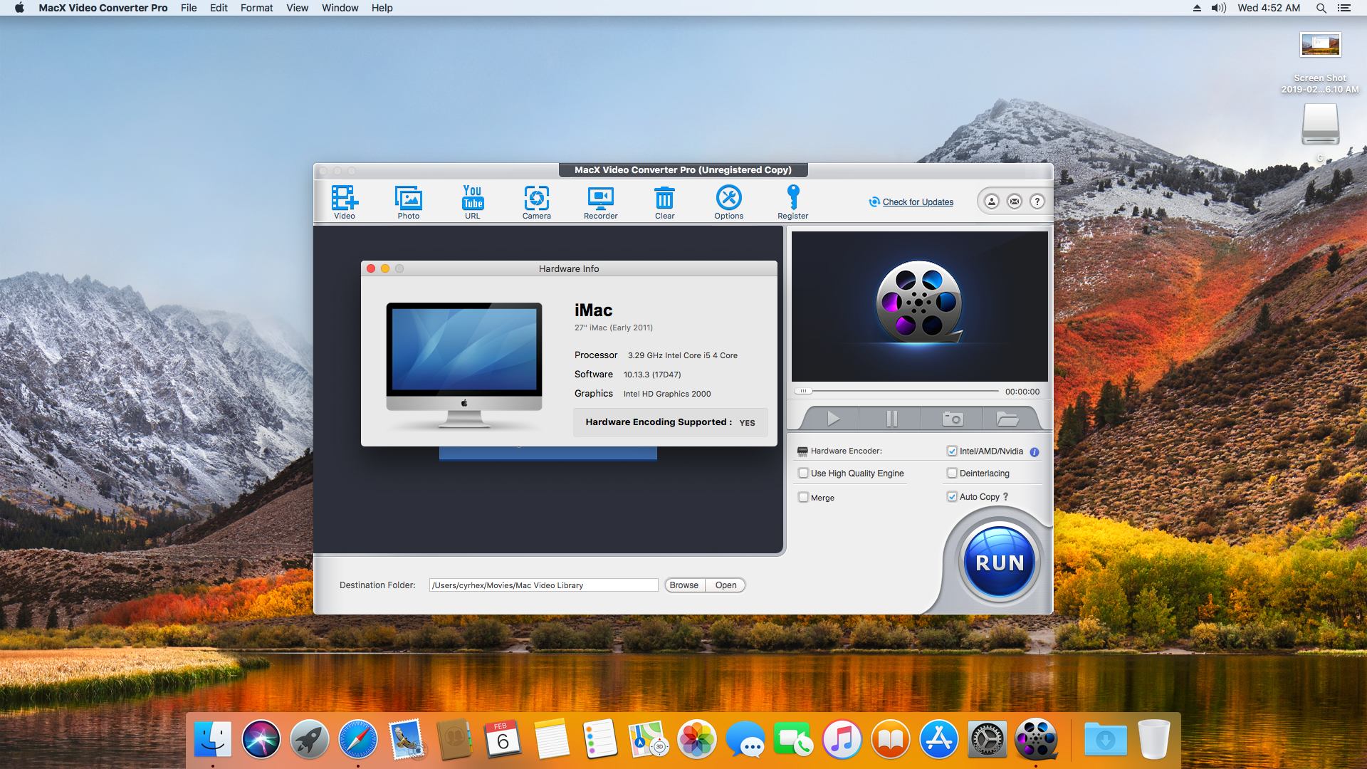

use hackintool,whatevergreen,lilu and applealc.kext then go to your bios activate your igpu anyway got working iqsv on my i5 2500 and asus b75 board with sapphire r7 250 ddr5
