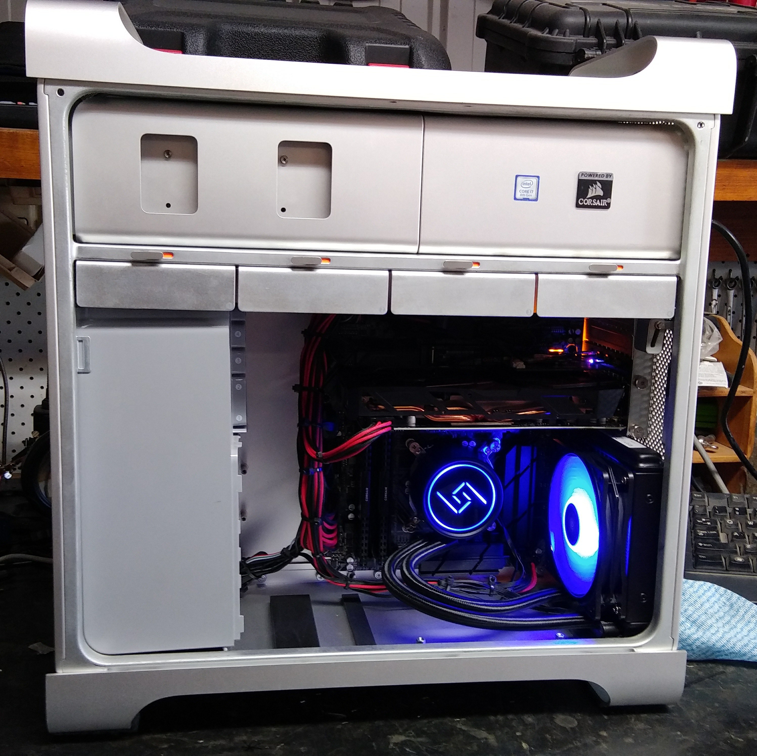

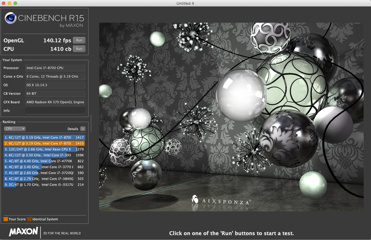

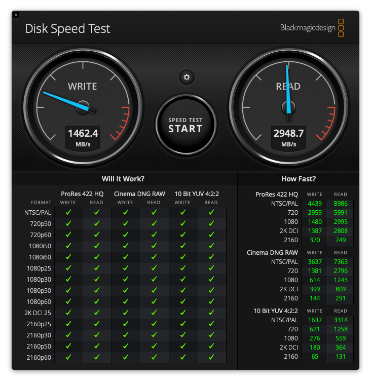

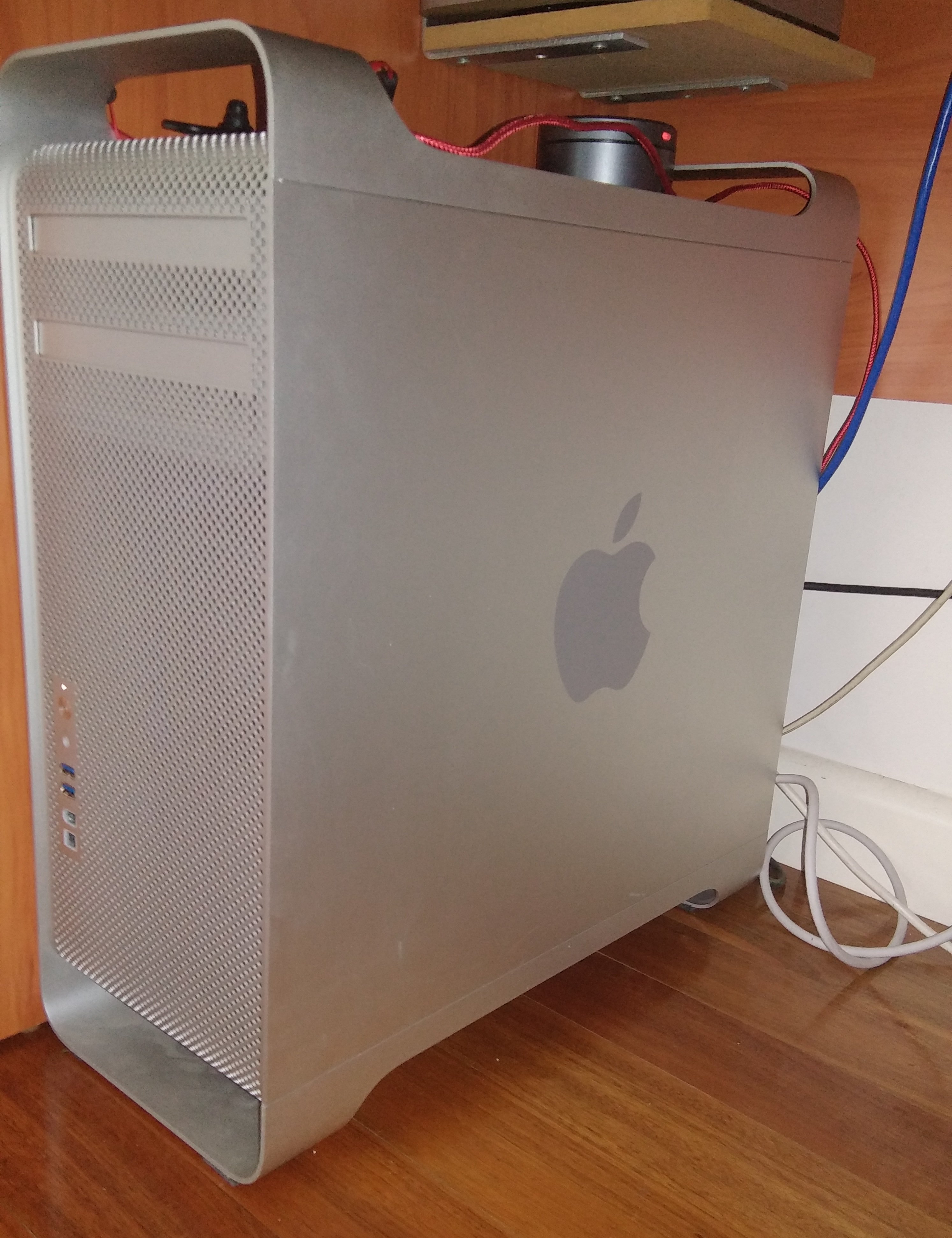

Yowie Posted February 3, 2019 Share Posted February 3, 2019 Components Bought Motherboard Gigabyte Z370M D3H - 1.0 - motherboard - micro ATX - LGA1151 CPU Intel i7 8700 Graphics Intel® UHD Graphics 630 Gigabyte Radeon™ RX 570 Gaming 8G MI Corsair Vengeance LPX 16GB (2x8GB), PC4-21300 (2666MHz) DDR4 Cooling Original 2x 120mm case fans Deepcool Gammaxx L120 AIO RGB CPU Cooler Hard Drives Samsung 250GB SSD, 970 EVO, NVMe M.2 (PCIe) Hackintosh OS Drive Western Digital WD 240GB SSD, WD Green 3D NAND, M.2 (SATA)Windows 10 OS Power Supply Corsair 600W SF600 High Performance SFX Power Supply, 80 PLUS Gold, Fully Modular WiFi & Bluetooth Broadcom BCM94331CD 802.11a/b/g WiFi card + Bluetooth 4.0 BCM94360CD/BCM94331CD to PCI-e 1X Adapter Already Owned Case Mac Pro 1,1 2006 Drive Seagate 4TB 3.5” Hard Drive Storage LG DVD RW HL-DT-ST DVDRAM GH24NS90 Comments I wanted to upgrade my Mac Mini 2012 server but didn't want to spend to buy a Mac Pro. I bought and dead Mac Pro 1,1 2006 off Gumtree for $50 and that was the start of the project. My aim was to keep it as stock looking as possible as i love the aesthetic of these cases. My goal was Mac Pro performance for under $1200. This i believe i have achieved. Installation Bios Loaded optimised defaults. Changes from default. Peripherals → USB Configuration → XHCI Hand-off : Enabled Chipset → Vt-d : Disabled Install was completed on Intel® UHD Graphics 630 as i had not purchased the RX570 as yet. Boot USB was created using terminal command "sudo "/Applications/Install macOS Mojave.app/Contents/Resources/createinstallmedia" --volume /Volumes/INSTALLER" Bootloader was installed with Clover Boot Loader EFI partition Config.plist was replaced with Coffeelake version from this website. https://github.com/corpnewt/Hackintosh-Guide/tree/master/Configs KEXTs Installed. WhateverGreen.kext Lilu.kext IntelMausiEthernet.kext FakeSMC_ACPISensors.kext FakeSMC_CPUSensors.kext FakeSMC_GPUSensors.kext FakeSMC_LPCSensors.kext FakeSMC_SMMSensors.kext FakeSMC.kext AppleHDA.kext AppleALC.kext MacOS was installed with no issues during installation. After install Issues Pink Screen Soundcard Sleep with any USB device plugged in. I used the information from this website to fix the pinkscreen fantastic description and easy to follow.. https://www.mathewinkson.com/2013/03/force-rgb-mode-in-mac-os-x-to-fix-the-picture-quality-of-an-external-monitor I used this guide from another amazing person will to share their knowledge to fix the audio. https://hackintosher.com/guides/get-hackintosh-audio-working/ I purchased a Gigabyte RX 570 Gaming 8GB ex-mining card that was remanufactured by Gigabyte and installed it into the system and the only thing i changed was the default card in the Bios. It just worked straight off. I have been using the system now for a couple of weeks and it has now replaced my Mac Mini. The only thing i cannot get to work is the USB sleep as every-time the system sleeps it just restarts Darkwake, for now i have just stopped sleep when monitor turns off setting until i can find a solution as i don't want to unplug the USB devices every-time. Benchmarks. Cinebench CPU Consistently around 1420 GPU Consistently around 140fps Cooling CPU has never throttled under high load running Cinebench 10x in a row the CPU never got above 60c and drops to around 30c straight after tests. Blackmagic Disk Speed Write 1450 to 1500MB/s Read 2900 to 3000MB/s Link to comment Share on other sites More sharing options...
