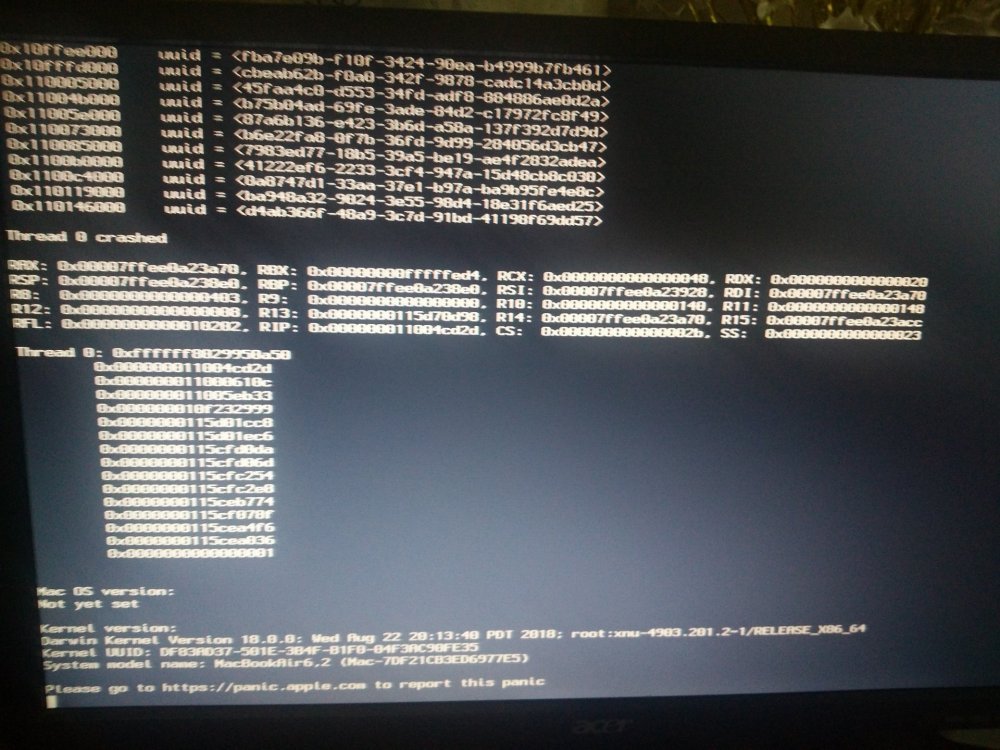

m2morteza Posted January 22, 2019 Share Posted January 22, 2019 Hi first of all I apologize for poor English . I am trying to install a version of hackintosh on my PC. without a Mac I decide to use prepared images on web . I downloaded 6 version of hackintoshs . El capitan , mavericks , sierra , high sierra , Mojave . for first time hackintosh high sierra booted to installer but i rebooted for back up data . after that when i try to install any other version a panic occurred."mac os version not set yet " I try many boot flags , try change bios settings , change ram slot , remove CMOS battery , unplug HDD and SDD , try all USB ports . but the problem exist yet . all versions boot to installer on other pc or laptops . my PC configuration is MB : Gigabyte H81M-S2PV CPU : Intel Pentium G3250 RAM : One 4 GB SDD : 256 GB HDD : 2 TB I attached the screen shot Thanks for help Link to comment https://www.insanelymac.com/forum/topic/337325-help-cant-install-any-version-of-hackintosh-on-gigabyte-h81m/ Share on other sites More sharing options...

PippoX0 Posted January 27, 2019 Share Posted January 27, 2019 You need to boot with Clover and FakeCPUID option set .I.e FakeCPUID=0x0306A0 because your intel Pentium G3250 is not recognized by OSX/macOSsent from my iPhone Link to comment https://www.insanelymac.com/forum/topic/337325-help-cant-install-any-version-of-hackintosh-on-gigabyte-h81m/#findComment-2661503 Share on other sites More sharing options...
