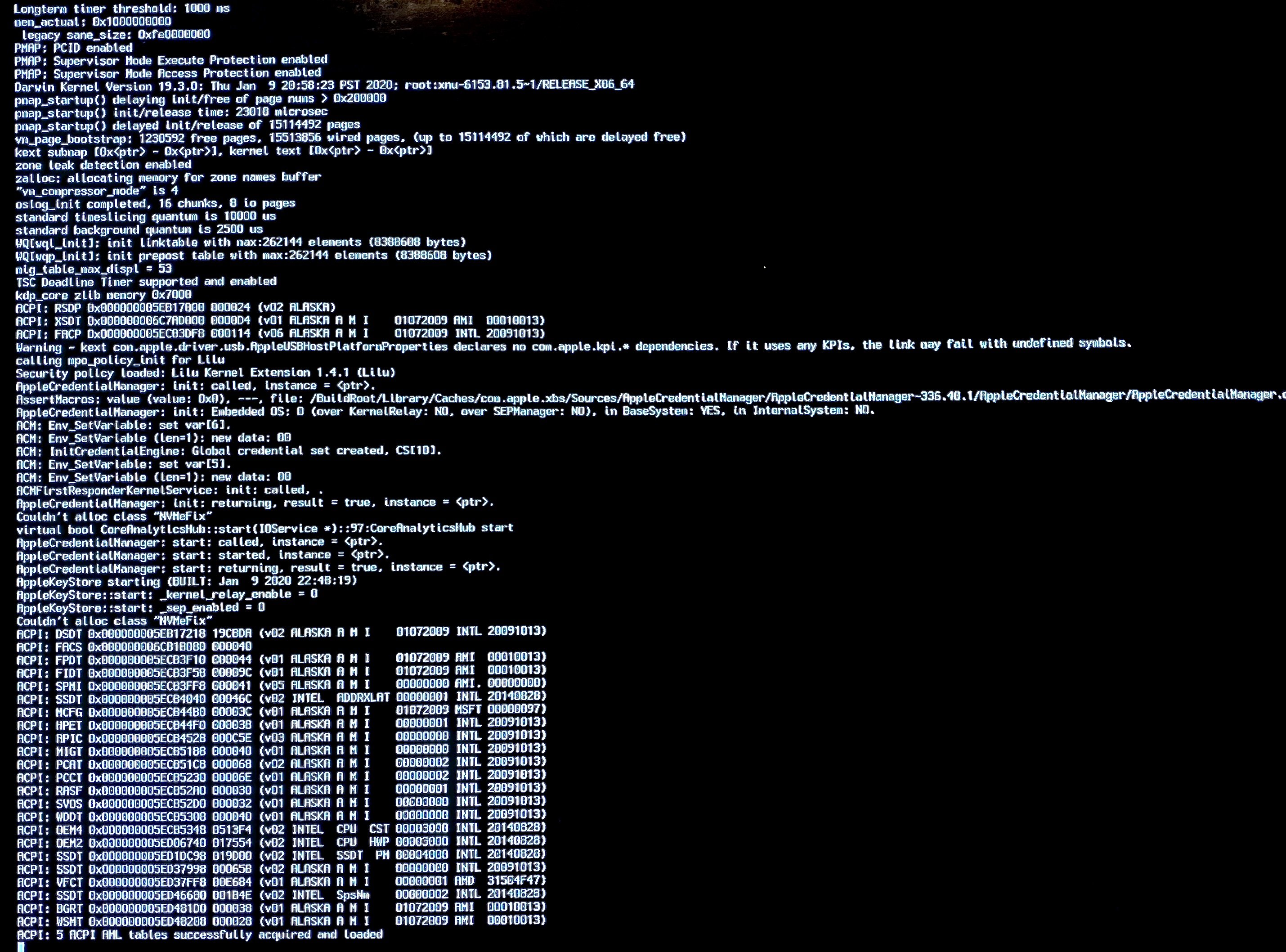

OK, I think I may have discovered the problem.  I know this is affecting zero other people right now, but if anyone else ever tries to hackintosh a X11DAi-N with the latest firmware, they'll (hopefully) find this post helpful.
So it looks like Supermicro is using the LoadTable() function to selectively load several additional SSDTs based on BIOS options (specifically, those relating to power management for the CPUs).
LoadTable(), according to the ACPI 6.x spec, is supposed to load an additional DefinitionBlock containing .aml file into the ACPI namespace.  Of course, to allow these tables to be selectively loaded, they cannot be declared as DSDT or SSDT types, as the OS would load them automatically, removing any ability to only load certain ones.  These tables are, in fact, SSDT tables, but they're named with nonstandard table types, specifically OEM1, OEM2, OEM3 and OEM4.  Any OS will see those types and simply ignore the tables, unless one of them is forced to load via either a DSDT or SSDT table invoking  LoadTable()
Therein lies the problem:  LoadTable() is an AML function, and inside AML code.  That means it happens at run time, when the OS is actually executing the AML code contained in the DSDT and SSDTs.  It is important to remember that AML is a combination of hardware/device descriptions, but also executable code that lets the OS interact with said hardware.
macOS appears to perform the table loading and AML code execution separately, as based on my BIOS settings when I took that screenshot in my last post, tables OEM2 and OEM4 should have been loaded.  Yet, at the bottom, it says 5 tables were successfully loaded.  There is the DSDT of course, plus 4 SSDTs, which is 5.  If tables OEM2 and OEM4 (remembering that these are secretly just SSDTs) were being loaded by macOS, that count would be 7.
The specific point where LoadTable() is called is upon executing various standard ACPI functions on the CPU device descriptors.  Supermicro's intention was to selectively load things like HWP SSDT tables or legacy P-state tables depending on certain BIOS switches (ACPI variables that it checks with an if statement).
I think macOS must only support static loading and not dynamic table loading, and then when it tries to execute the loaded DSDT and SSDTs, it reaches a LoadTable() call and can't find the requested table (since, being of a type other than DSDT or SSDT, were never loaded upon initialization), it just hangs.
I'll hopefully test this theory later today, I have to rework the Supermicro SSDTs a bit.  I'd rather not drop the table entirely if at all possible.

For comparison: old SkyLake and new CascadeLake ACPI from ASUS WS C422Pro/SE (dumped by Clover).
I'm sure the non-bootable macOS on CascadeLike BIOS v.3003 is somehow related to ACPIs tables. Locked MSR is important but not critical and is temporarily ignored.
WS C422Pro:SE OEM ACPI Tables.zip
Indeed, you are right.  The ACPI table issue was still a problem for my motherboard in the sense that it would prevent macOS from loading certain SSDTs (which may or may not even matter), but unfortunately it had nothing to do with the hang/crash.  Working around all instances of LoadTable() did nothing, though now all the SSDTs I want to load are loading.
Oh, and are you saying that other people are having issues booting cascade lake?  I thought it was just me.  I should reread this thread more carefully.  :blush:
Anyway, thank you for those ACPI tables.  I'll take a look, though I agree that it probably isn't anything to do with ACPI tables.  I mistakenly thought other people were able to boot macOS using cascade lake (possibly using a fake cpuid for skylake-x) and that the issue must be due to the only difference between eritius' motherboard and mine - the BIOS version (and thus likely some problem with the ACPI tables).
But if there is generally an issue with cascade lake and macOS... well, then obviously the problem is that I am using cascade lake CPUs and it has nothing to do with my BIOS or anything else.  I wish I could get some sort of debug information out of the macOS kernel but it just seems to lockup.
I was able to get a CPU register dump after it had locked up trying to boot macOS via IPMI, though I haven’t really looked at it yet, but here it is just in case:
save_config.txt
Edited by metacollin
Share this post
Link to post
Well the register dump is apparently just the machine check exception registers, which are generally for hardware problems.  And they all just show that there is no exceptions.  I thought the dump would have more in it.
But, I have great news! I'm an idiot :D!  This entire time, the answer was at my very hands.  Literally.  I have a backlit keyboard, and it is currently configured to always be on - if it has power, it lights up.  And back when I was working on just getting OpenCore to even load the kernel etc., I knew there was a problem whenever the keyboard stayed lit.  However, if OpenCore managed to start the kernel booting, shortly before the boot began, my keyboard's backlight would always turn off.  I learned to recognize my keyboard going dark as a sign that macOS was successfully starting to boot.
But that means power to that USB port is being turned off completely.   It's a pretty dumb keyboard, it doesn't know or care if it has been enumerated or anything else.  If it has power, it lights up.  It can't not light up unless it is unpowered.  And some quick research seems to show that USB 3.0 is a complete mess on X299 (and presumably, C621) chipsets, with only USB 2.0 working without a ton of mucking about.  Which is unfortunate, as the X11DAi-N doesn't actually have any USB 2.0 ports, or any EHCI controller to speak of.
Anyway, if macOS is cutting power to all my USB ports the moment it starts booting... I feel like this probably presents a problem if both my EFI partition and Catalina install partition are on a USB thumb drive.  I feel like this probably might result in the boot process simply hanging.  It's like pulling the drive out of the port the moment you see any verbose boot text.
So uh, I'm 99% sure my problem has everything to do with me not dealing with USB properly (or just avoiding it entirely) and nothing to do with Cascade Lake.
Once I sort that out, hopefully I can make some progress on Cascade Lake + C621 (which should translate over to C422).
Ugh, I can't believe how long it took me to make the connection between keyboard turning off and USB crapping out.
