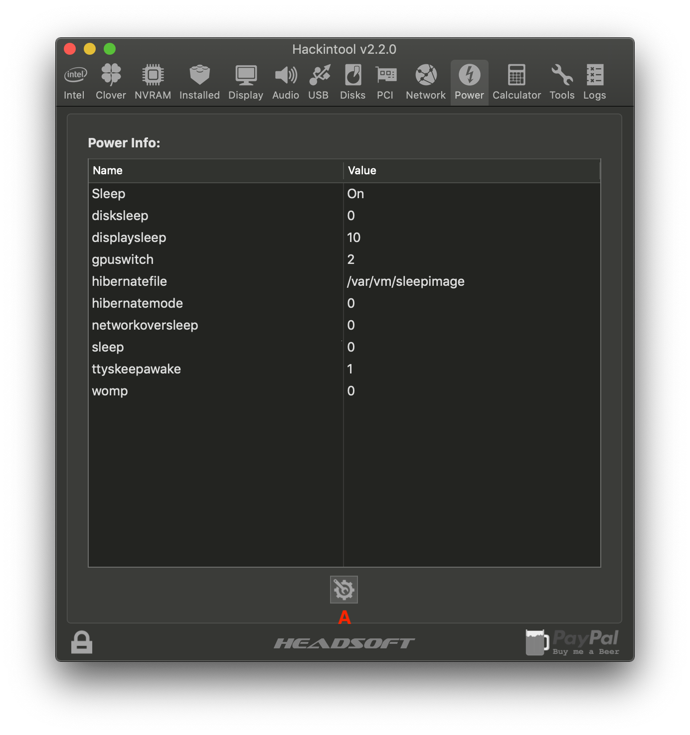

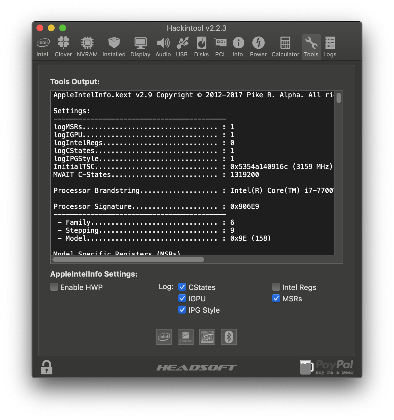

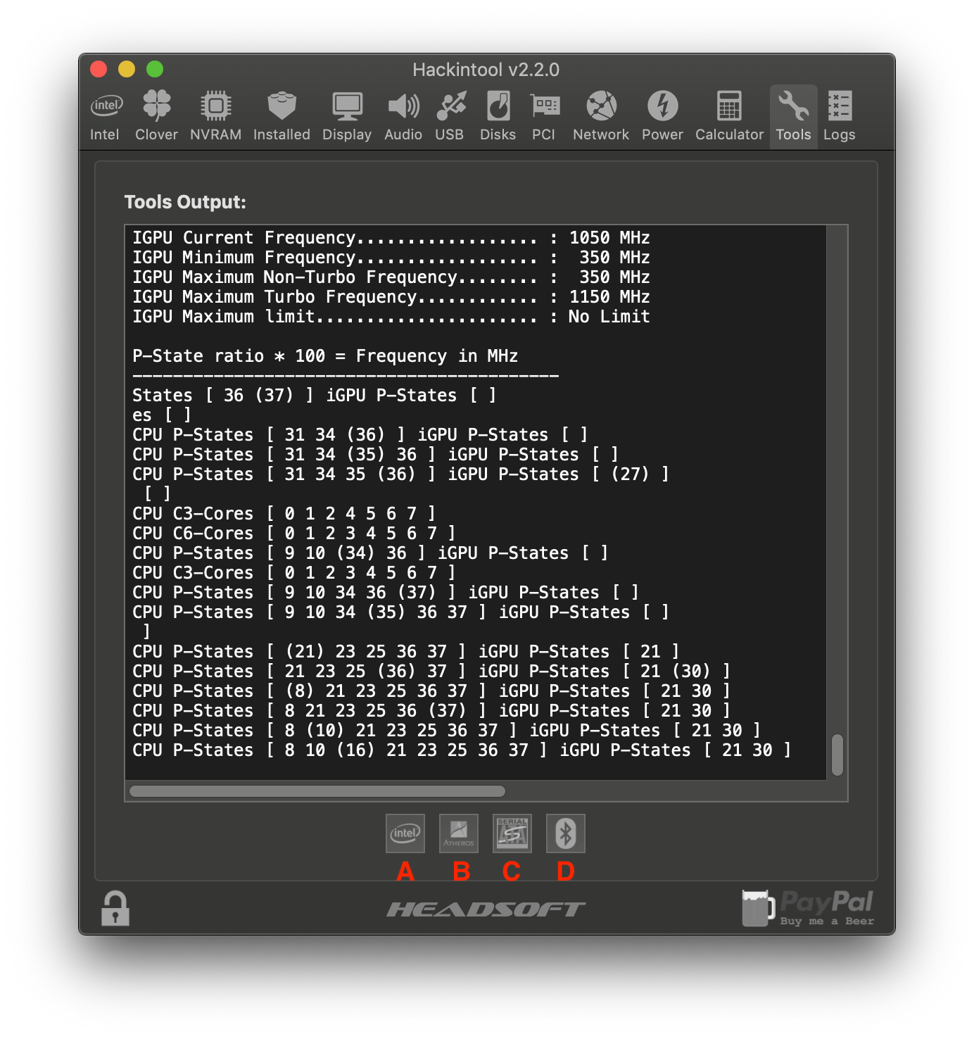

Posted (edited)
Hackintool v2.2.0 Released
- New PCI Devices, Network, Power and Tools tab
- Set power settings (be careful!)
- Power tab includes:
   A. If your computer has a problem with sleep this could help. Hibernatemode will be set to 0 and the Sleepimage will be replaced with a write protected 0-byte file.
- Tools tab includes:
   A. Generate AppleIntelInfo report (thanks Pike R. Alpha)
   B. Install Kext for Atheros AR92xx/93xx WLan Cards (only 10.14 +) (thanks Sascha Lamprecht)
   C. Install Kext to enable SATA HotPlug on Mojave again (thanks Sascha Lamprecht)
   D. Generate Windows Bluetooth Registry File
- If you dual boot with Windows and want to share your Bluetooth mouse without having to pair again, do it once in macOS then generate this registry file for Windows.
Edited by headkaze

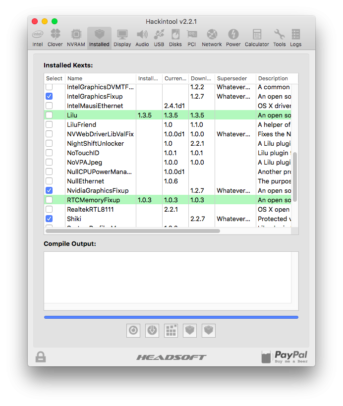

Posted (edited)
2 hours ago, Allan said:
Hey [mention=1364628]headkaze[/mention], as the IntelGraphicsFixup, NvidiaGraphicsFixup, and Shiki are officially dead, why it are available at Hackintool?
If it detects these older kexts it shows in the "Superceder" column the new one you should be using. So its mainly to inform the user.
Edited by headkaze

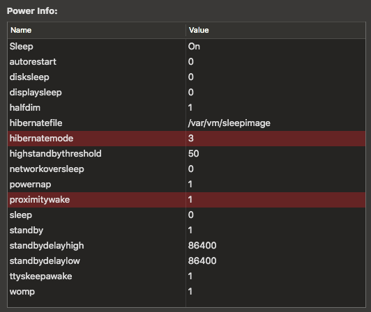

Posted (edited)
What is these two value it is showing red indicate but my sleep is working without any problem If I click to fix will it break my sleep?
Edited by telepati
Share this post
Link to post
It's a good question. I have the same two settings on my laptop and I have not applied the patch for it because sleep works fine. My guess is HibernationFixup or some other Lilu plugin is taking care of it. I don't think it would hurt to apply it and it's easy enough to restore the previous settings.

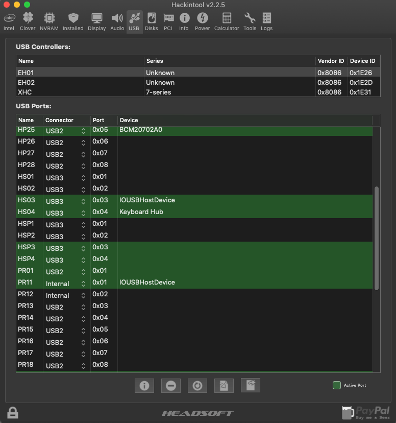

Posted (edited)
Hello guys! I using USBInjectAll.kext and EHC1->EH01 and EHC2->EH02 rename in clover config.
I downloaded Hackintool for check my USB.
This is normal? Unknown EH01 and EH02? How to fix this?
Motherboard: GA-Z77N-WIFI
Thanks!
Edited by jasonhun
Share this post
Link to post
It just means it doesn't recognize the controller. The latest version should improve this.

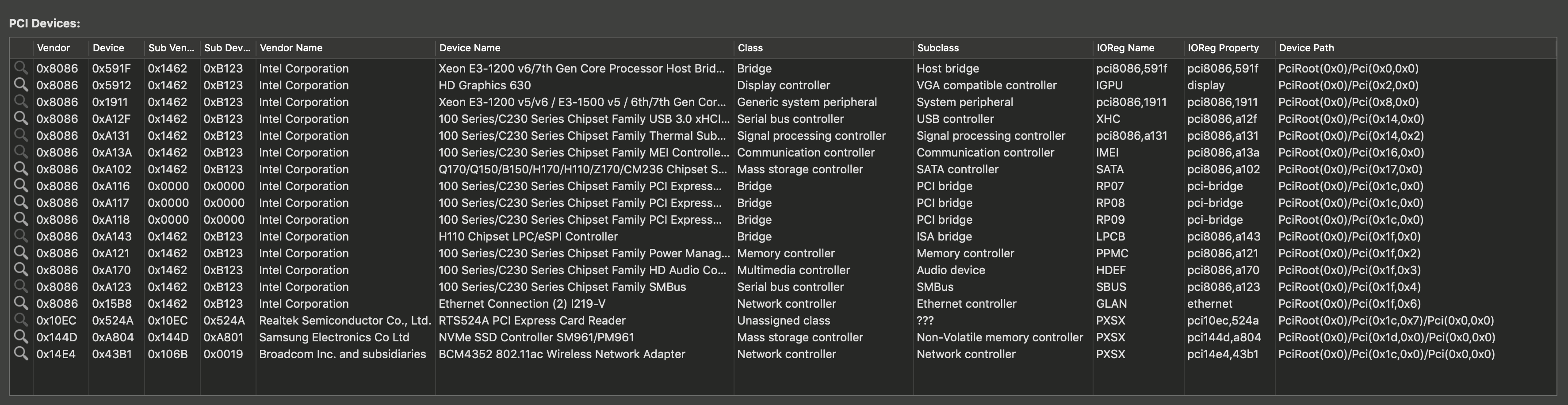

Posted (edited)

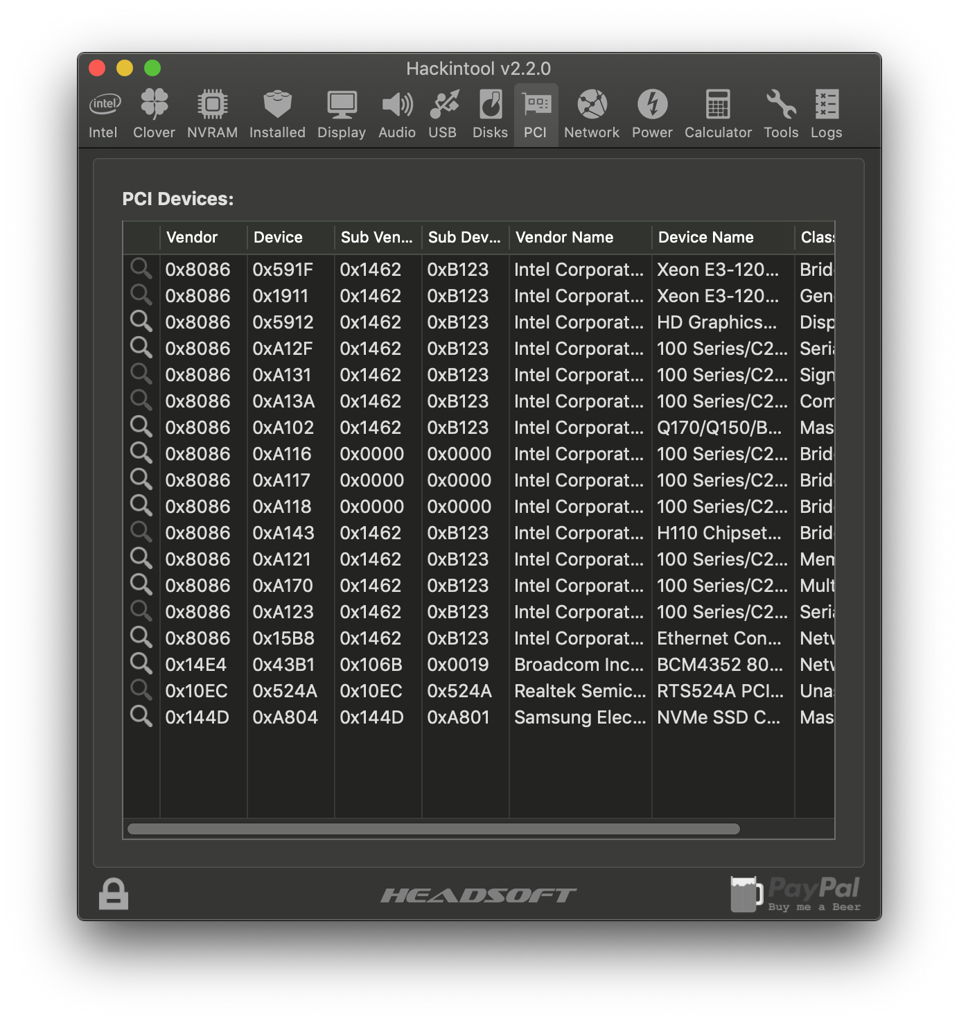

PCI Devices list is much more informative. No need to use gfxutil to get the Device Path anymore. Right-click on a device in the list and select "Copy DevicePath" to copy it to the clipboard.
Edited by headkaze
cool, one of the most frequently used hackintosh app for me.
:thanks_speechbubble: for that!
