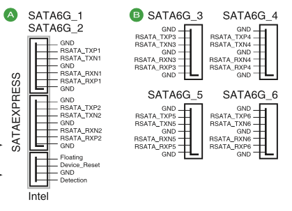

6 hours ago, telepati said:
My mobo on my signature. These are the slots I use. All other slots are empty.
You can change this setting to try.
Edited by 紫米
Share this post
Link to post
Check BIOs settings because your manual says:
The M.2 shares SATA mode with SATA Express. Change this item before installing M.2 SATA devices. Default setting is SATA Express
Onboard Devices Configuration > M.2 and SATA Express Mode Configuration > M.2
Share this post
Link to post
I read the manual over and over again. My SATA Express ports are empty. But when change SataExpress to M.2 I cant never boot. But I didn't remove the device first. I think just like you said first I must remove NVME >Change Bios Settings to M.2>Shut Down>Install device again>Start.  I will try that then share the result. We will see what will happen.
Edit: I used that setting a very long time and I remember what happen the change this setting on BIOS. I also tried again just like you said. Here it is what happening after change this setting; when you change this setting to M.2 machine restart itself 2 times and change this setting to SataExpress Automatically. You can't set up this setting to M.2. Default Setting is the right setting for NVME.
Edited by telepati
