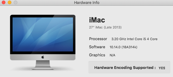

Let me explain it this way:
All the CPUs that come with the internal GPU (IGD/iGFX/iGPU) have a feature called Intel Quick Sync Video which was introduced with Sandy Bridge CPUs.
Apple has been using this technology since Mountain Lion which being used with a variety of its softwares such as Safari, iTunes FaceTime QuickTime and so on and so forth, this feature is helps to improve the performance of video encoding and conversion and rendering (in video editing softwares such as iMovie, FinalCut, Motion and Compressor) in a sense of actuall video rendering (in video editing softwares such as iMovie, FinalCut, Motion and Compressor, etc..) and simply viewing what we see on our displays.
This feature is enabled by default in any given Apple computer which has the internal graphics and/or a dedicated GPU such as 21.5" and 27" iMacs or for instance MacBook Pros with single or dual GPUs and they will use the Intel Quick Sync Video technology to improve the performance on video rendering (macOS itself and the Video Editing softwares) so macOS will take advantage of this technology automatically when the iGPU is active and initialized correctly by the OS which is the case in all of those computers.
Now on our hacks when we enable this feature in BIOS/UEFI and config it correctly as the result we have a better performance on how the video performance of our systems behaves.
When I first installed Mojave I wasn't even able to play videos in QuickTime let alone using QuickLooks properly so something was missing. After I made the changes to my config.plist it become clear that the missing pice was indeed the Intel Quick Sync which is responsible for handling the correct and a better performance.
I know you might have used the same config in Sierra and High Sierra without any issues because most of the new discreet GPUs can handle the Quick Sync up to a point but with macOS Mojave and the major changes in the OS itself we now need to adapt to these changes accordingly and I believe that's another reason that macOS Mojave is not supporting many of the previous Apple computers and hacks because they aren't simply able to support these changes and processes properly.
Please feel free to correct me if I'm wrong.
These are two simple examples on Hardware Encoding Support when the iGPU is enabled or not:
My IvyBridge rig without iGPU and a nVidia 1070 GPU with Latest Web Drives in High Sierra
My SkyLake with iGPU and RX580 in High Sierra:
Edited by Cyberdevs

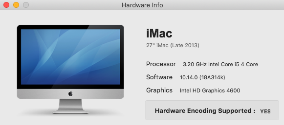

Just now, arsradu said:
No no... I meant the Hardware Info app from which you posted the screenshot. :))
Whoops! my bad :D Sorry.
It's MacX Video Converter and you can check the hardware encoding support by clicking the section show in the picture.

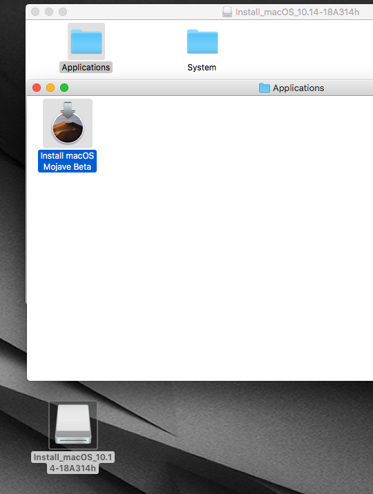

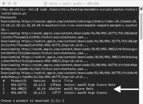

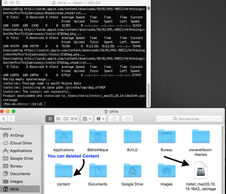

MorenoAv
you can used this Script here  installinstallmacos.py Thanks MR Greg Neagle
sudo /Directory installinstallmacos.py
Select 2 follow by Enter
Install macOS Mojave Beta will be create on /Users/MorenoAv/Install_macOS_10.14-18A314h.sparseimage
after completed delete Users/MorenoAv/Content
Content is the folder used by the script
This is the contents of the image
I hope this is help you

Thanks to you both @crazybirdy and @chris1111 for your help,
And the script from @crazybirdy did the trick, now I'm writing this from my newest install of Mojave 10.14 beta 2...
For future memory, update clover in usb install and use install create media script and all is well...
And another great advice install with a minimum of kexts type fakesmc and internet kext only... and it works, or for me worked.
Thanks to all
And now begins my battle with sound, one more time...
PS: your script download the complete install, @crazybirdy... and I'm proof of that, I installed Mojave with the result of the script...
