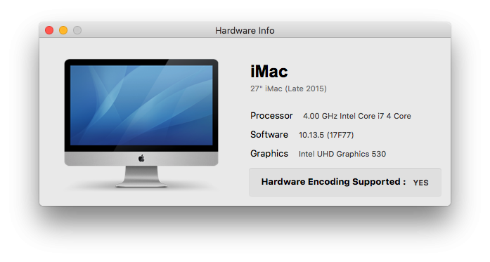

11 hours ago, arsradu said:
Hi man! Glad to hear that! :)
The point is to set it as IGD, not PEG. :) Meaning, with the cable connected to the dedicated card, set it as INTEGRATED in BIOS.
Also, if you're on Skylake, you need to set Inject Intel and the correct ig-platform-id for your case (probably HD 530 or something). My example is for my iGPU which is an Intel HD 4600. And yes, it DOES matter, even if you're technically not using the actual iGPU directly. That's the whole point. You need to set the iGPU as if you're using it. Keep the cable connected to the DEDICATED GPU and set it to INTEGRATED in BIOS. :D
@Cyberdevs has a little more experience with AMD and RX cards than I do. So, he might be able to help you more with this. He was also the one who discovered this little thing in the first place. I just adjusted it for my setup. :) So, thanks to him.
But the idea is simple: trick the OS into thinking you're connected to the iGPU, when in fact, you're not. That's all.
I forgot the inject intel after inject and add ig-platform-id now its working.

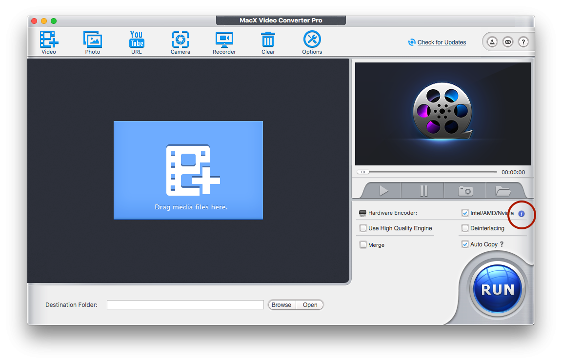

To solve the QuickLook issue as @arsradu already mentioned you need to have the iGPU enabled in BIOS/UEFI. just let the RX560 be the primary and the iGPU set as enabled and that's it. This way you will have the Hardware Encoding Support which will be handled by the Intel HD Graphics and macOS will use your RX 560 for other tasks such as games and graphic softwares.
check this post and you will have quicklooks enabled easily.
I forgot the inject intel after inject and add ig-platform-id now its working. In your post you are also inject ATI. I followed your direction and inject it but it is necessary?
Quote
I remember that I gave you a SSDT for your GPU do you still use that? Because yo udon't need it anymore ever since macOS 10.13.4 our GPUs are working OOB with just a little tweak.
is this tweak you mention about; is adding frame buffer to FakeSMC? If it is, I am using my FakeSMC like that 'cause without it I am always getting black screen.

I'm glad that you feel better :)
The injection was necessary for me because I had to remove the DSDT because of some weird glitch, but if on your system it works ok without injection that's ok. don't use it.
