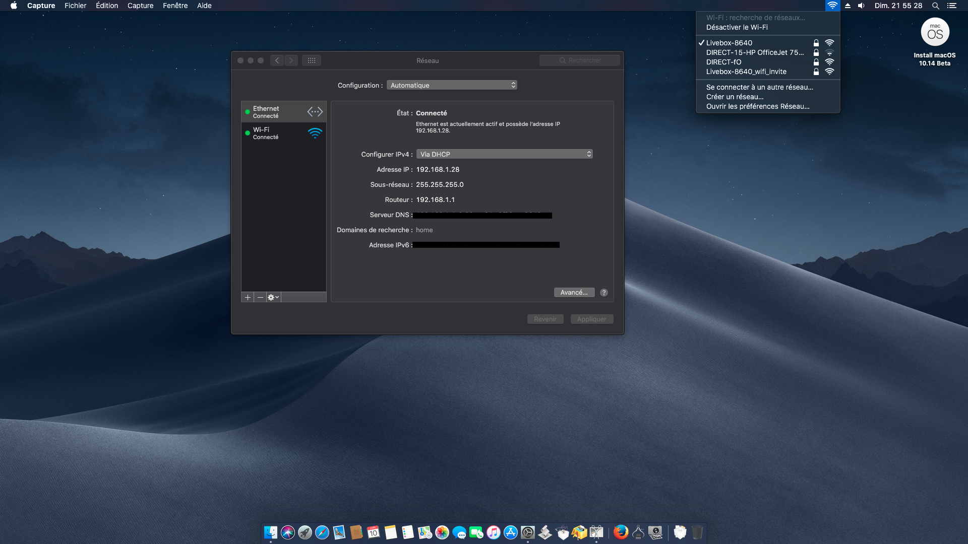

After many problems, I managed to install on my system H81 Sapphire R9 380 with iMac Pro SMI bios:
- The first time I downloaded the MacOs installer I had an error before the first reboot
- I downloaded the MacOs installer another time in my X299 rig.
- unable to handle the boot process after successful installation with other SMBIOS than iMac Pro 1.1
- Setup has converted my hard drive test to APFS
- the sound works with WoodoHDA
- Wifi does not work
Thank you to everyone here for their help / tools / kexts and others.981793804_Loloflat6Mojavebeta100618.thumb.png.bd9b41bd59ff59f79679b96d030bb713.png

Posted (edited)
9 minutes ago, Cyberdevs said:
Have you seem my post about the WiFi?
If you have your WiFi adapter working OOB in previous macOS versions all you have to do is to extract the AirPortAtheros40.kext from macOS High Sierra and place it under /L/E or /S/L/E then repair the permission and reboot.
Use Kext Wizard or Kext Utility to install the kext.
AirPortAtheros40.kext.zip
Thanks Cyberdevs :
I readed your previous post but perhaps i made a mistake : :hammer: i placed the kext in Clover/kexts/other and also in S/L/E .
So i will remove it and only place the kext in /S/L/E.
Edited by Loloflat6

Just now, Loloflat6 said:
Thanks Cyberdevs :
I readed your previous post but perhaps i made a mistake : :hammer: i placed the kext in Clover/kexts/other and also in S/L/E too
You're welcome, I also tried the /EFI/Clover/kext/other but it didn't work so I copied it to /S/L/E and repaired the permission and it worked.

Posted (edited)
Thanks , works fine now :thumbsup_anim:1024410747_Loloflat6WifiMojave100618.thumb.png.e46daee9a36df1b21c643fcbed99078b.png
