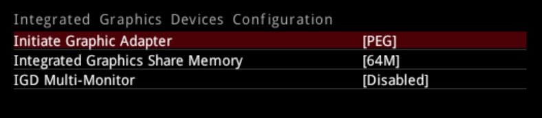

I can't find iGPU in BIOS. In Graphics it only allows me to choose between IGD or PEG
Below I can specify shared memory and IGD Multi-Monitor. Similar to the screenshot.
Share this post
Link to post
Yeah, I was suggesting trying to set IGD Multi-monitor to Enabled.

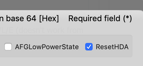

23 minutes ago, bogascorp said:
@arsradu Another question. When you put the computer to sleep, did you ever lose sound after waking?
That is not related to this topic. Depending on what method are you using for sound (hopefully Lilu + AppleALC), you can try different Layout IDs. :) Some of them have EAPD enabled and you shouldn't lose sound after sleep. Alternatively, you can get CodecCommander.kext, put it in S/L/E (doesn't work from Clover/kexts/Other) and it should have the same effect. I personally had issues with it under Mojave, so I chose one of the other Layouts in order to fix this issue.
Now, unfortunately, your motherboard uses a different codec than mine, so I can't suggest the same Layout ID that worked for me. But what I can suggest is taking a look at the list of supported codecs from here and trying a different one than the one you currently have. Your codec is ALC 887, so choose one of these Layout IDs: 1, 2, 3, 5, 7, 11, 13, 17, 18, 33, 50, 99
Also, select ResetHDA in your Clover config. Might help with that.
