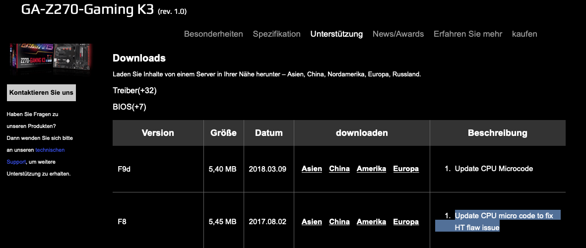

Since you say, a CPU upgrade solved your issue, lemme ask one thing: did you update the BIOS firmware before? In my case, it looks like the random crashes stopped after I installed a BIOS upgrade, which contains updates for the Intel Microcodes... In case you still have your old CPU, please consider trying this out and report back.
correct, i also had same experience with intelhd 530 (random freeze).
And fixed by update the bios, and no need to spend any money to change the cpu.
