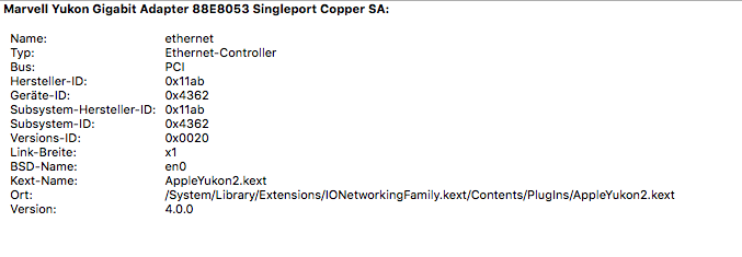

ApexDE Posted June 19, 2018 Author Share Posted June 19, 2018 i don't have LANInjection or InjectLAN in my config.plist. Maybe it is needed with Clover >4428? This is my Profiler-Ethernet-Report with 4428 and without any LAN Injection active in config.plist: Link to comment Share on other sites More sharing options...

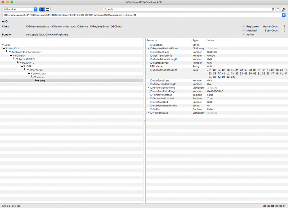

pkdesign Posted June 20, 2018 Share Posted June 20, 2018 UGH!! Right about June 6 my Messages/Facetime, which have been working for many years, just stopped working. It wouldn’t activate. I spent at least eight hours on Monday trying to figure out why. I deleted pref files, even changed my rock solid config file with new serial number, board serial, ROM, MLB, etc. I even called Apple which I know was a stupid idea. So others are having this same issue? I tried to go back to version 4497 but it didn't work. I think I've screwed something up with Apple activation servers now. Link to comment Share on other sites More sharing options...

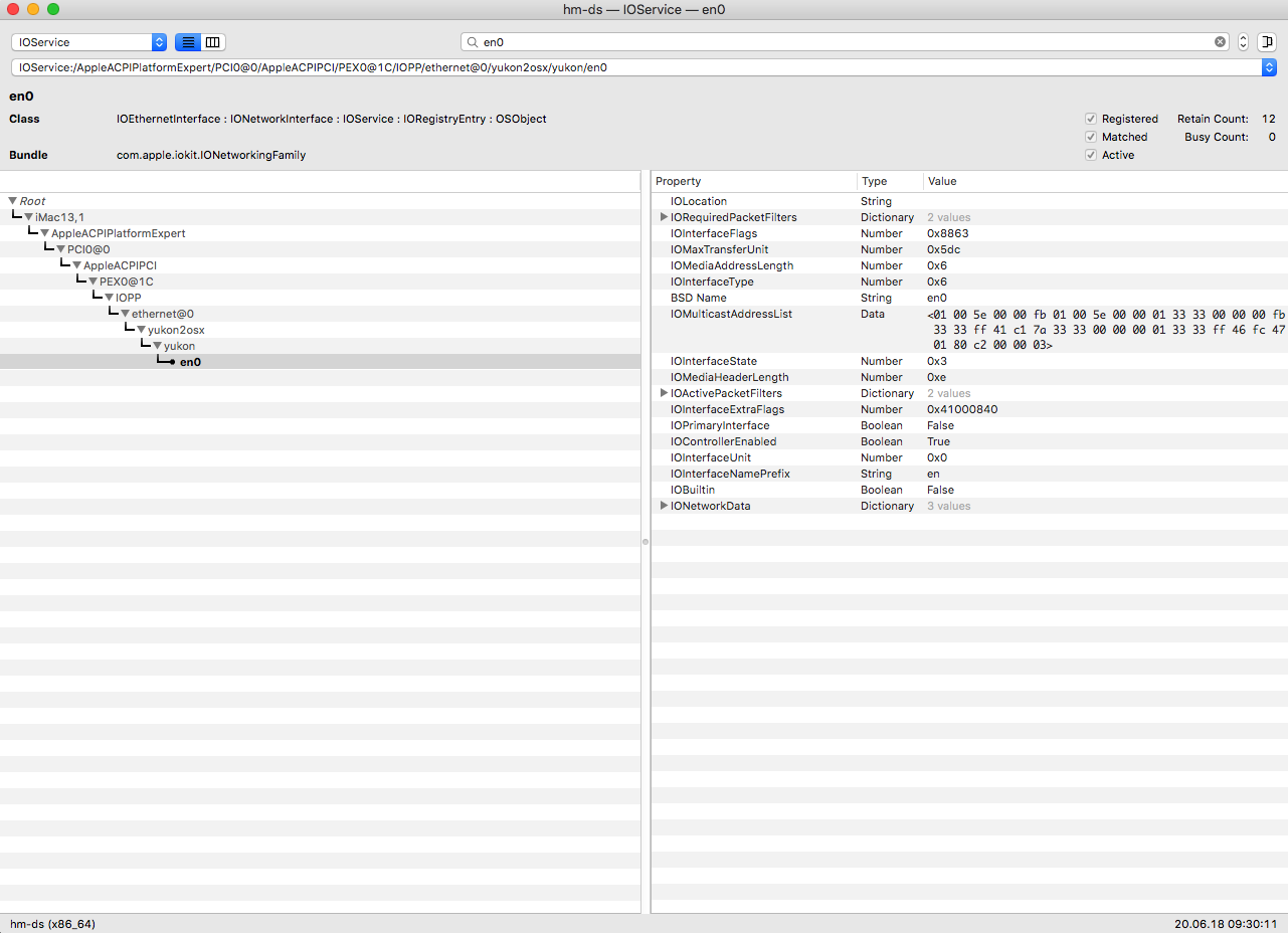

arsradu Posted June 20, 2018 Share Posted June 20, 2018 (edited) 13 minutes ago, pkdesign said: Yes, I use an OOB card that the system recognizes using AppleYukon2.kext. Like I said hasn’t been an issue for many years. I checked IOReg and it does show as not built in (won't let me attach screen shot.) I'm afraid to money around with my config again as I'm afraid I will get blocked. But I may try to go back to my original config as the new one has screwed up a lot of apps, etc. Ok... Now, this will probably sound really stupid, and I'm only trying to understand why that commit was made in the first place. Cause it clearly says "correct mistakes". Which makes me think that...actually the way it worked before, was not the right way. Even if, in this particular case, it did fit your needs perfectly. And the reason why I'm saying this is because this is (technically) NOT an on-board/built-in card. So...why are you expecting it to work like one? And especially out of the box. Edited June 20, 2018 by arsradu Link to comment Share on other sites More sharing options...
pkdesign Posted June 20, 2018 Share Posted June 20, 2018 Hmm, not sure what you mean or are asking. I bought the card in October 2016 when my onboard Ethernet died. It has been working flawlessly ever since with no extra kext or injection. Hence OOB. The OS just recognizes the card as a Marvell Yukon Gigabit Adapter 88E8053 and uses AppleYukon2.kext to load. Since it always worked, I was never aware of any issues (such as having to inject like ApexDE has found) or needing to look at the IOReg. 4 hours ago, arsradu said: Final EDIT: It turns out that Clover doesn't inject the Network Card automatically as "built-in" since Clover 4428. You need to add two more lines in config.plist in "Devices" for properly injected internal Ethernet, so IORegistryExplorer shows "True" for IOBuiltin: Quote <key>LANInjection</key> <true/> I'll report back when my iMessage Security Token expires and new iMessage Activation is needed, but i guess it will be working again from now on. Where did you insert that key? Link to comment Share on other sites More sharing options...
arsradu Posted June 20, 2018 Share Posted June 20, 2018 (edited) 32 minutes ago, pkdesign said: Hmm, not sure what you mean or are asking. I bought the card in October 2016 when my onboard Ethernet died. It has been working flawlessly ever since with no extra kext or injection. Hence OOB. The OS just recognizes the card as a Marvell Yukon Gigabit Adapter 88E8053 and uses AppleYukon2.kext to load. Yep, I understand that. But...I'm saying that, since this is a new "issue", and since it appears to only affect people with non-builtIn cards, and since the commit above was meant to fix a mistake (meaning the fact that it probably shouldn't have worked like that in the first place since it's not an on-board card), I'm thinking that, maybe, the fact that it did work for so long, was simply because this "bug" hasn't been discovered and fixed until now. Of course, now that it's fixed (assuming this is actually the way it should have been all along), of course it's not ok since you expected it to continue to work, as it did, even if it wasn't supposed to. At least not without some patches. I mean...to me, logic would suggest that, since it's not an on-board card, it shouldn't work like one. So the fact that it did, is probably just a lucky coincidence. Of course, this is just my opinion. As for where you should add that, open up your config.plist with Clover Configurator, go to Devices and check the box for LANInjection. Ooor, edit the config.plist with a good text editor, search for the Devices section, and add that key into it. Save the changes and restart. I guess both should work. Only one is more user-friendly than the other. I would upload a screenshot but uploads are down...again. Edited June 20, 2018 by arsradu Link to comment Share on other sites More sharing options...
ApexDE Posted June 20, 2018 Author Share Posted June 20, 2018 2 hours ago, pkdesign said: Where did you insert that key? You need to insert it under „Devices“ in config.plist. You can also use CloverConfigurator App if you are unsure. Link to comment Share on other sites More sharing options...
pkdesign Posted June 20, 2018 Share Posted June 20, 2018 (edited) You have no idea just how happy i am right now. Even though I did spend all day Monday trying to figure this out. IT WORKS! I went back to all my original settings except I added the LAN key and ow IOReg does indeed see the LAN adapter as BuiltIn. I'm guessing Apple got a little particular with this last update that made my previous setting not work. I can't seem to sign into iTunes now but one problem at a time! It may clear itself up. Everything else works. THANK YOU! Edited June 20, 2018 by pkdesign Link to comment Share on other sites More sharing options...

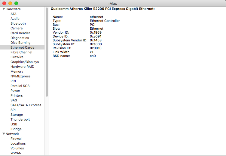

SavageAUS Posted August 4, 2018 Share Posted August 4, 2018 I figure this is the best post to hijack. I’m trying to activate iMessage on my laptop. I have followed many guides and done every step correctly but iMessage will not activateI have my Ethernet as en0, laninjection is enabled. I now have an iPhone and iMessage is working on it so I’m at a loss. Any help would be great. I’m using Mojave beta 5 and clover 4634. I did have it working after a fresh install but after a reboot it wouldn’t activate. Sent from my iPhone using Tapatalk Link to comment Share on other sites More sharing options...
arsradu Posted August 4, 2018 Share Posted August 4, 2018 (edited) 49 minutes ago, SavageAUS said: I figure this is the best post to hijack. I’m trying to activate iMessage on my laptop. I have followed many guides and done every step correctly but iMessage will not activate I have my Ethernet as en0, laninjection is enabled. I now have an iPhone and iMessage is working on it so I’m at a loss. Any help would be great. I’m using Mojave beta 5 and clover 4634. I did have it working after a fresh install but after a reboot it wouldn’t activate. Sent from my iPhone using Tapatalk Sounds like NVRAM issues to me... Could be wrong though. Make sure you have either hardware NVRAM (which, if you're asking for the Desktop build in your signature, it's not the case), or you use AptioMemoryFix in Clover. Edited August 4, 2018 by arsradu Link to comment Share on other sites More sharing options...
