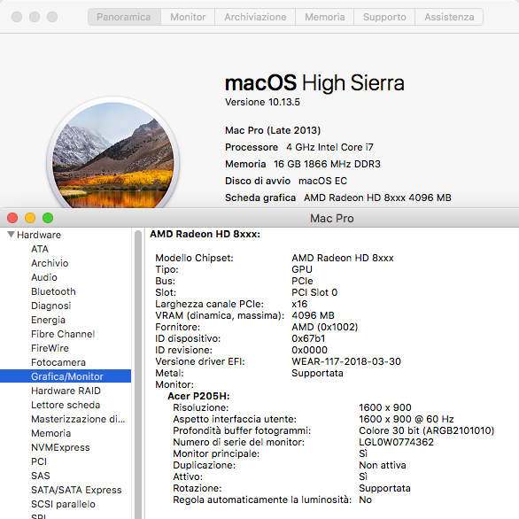

Swear Posted July 11, 2018 Share Posted July 11, 2018 I don't have this card. I have a r9 290 non-x and had a lot of hard time getting it to work properly. I'm telling you what I did to make it work: 1: I edited all related kexts (3 in total) in S/L/E by adding r9 290 non-x ID which is 0x67B11002; 2: Replaced original kexts with edited kexts through Kext Utility; 3: Placed Lilu.kext and Whatevergreen.kext in Clover's "Other" folder; 4: Edit config.plist with Clover Configurator by enabling "RadeonDeInit" option in Graphics tab. 5: Restarted and it works with full vram. Hope this helps you Link to comment https://www.insanelymac.com/forum/topic/334323-anybody-has-a-working-asus-strix-r9-380x-with-hs/#findComment-2625315 Share on other sites More sharing options...
