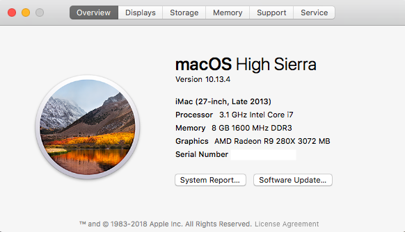

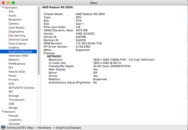

Back for an update. So I was able to finally get into High Sierra after black screen and trying different things with clover. I switched to the backup bios on my GPU and was able to get in into high Sierra. I'm in my desktop and run geek bench again and scores are off.  So now I can boot and see everything just fine but my system is still not running the way it should. Any thoughts?

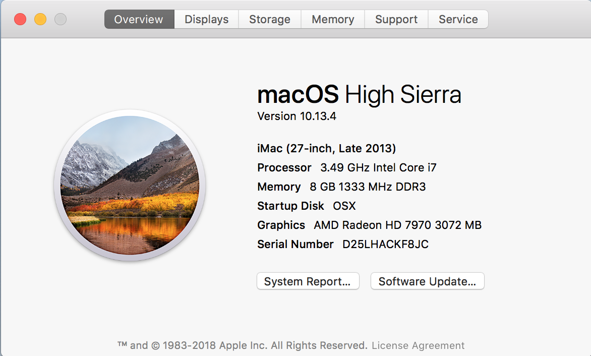

Also my card is showing as 7970.

With the same settings in the config plist i made for you and SSDT like above, I've this on About This Mac:

7 hours ago, ammoune78 said:
:D It worked hhh, but it's so slow, i mean booting up to login screen, it take too much time, going from losing screen to the Finder takes too much time, loading the things and settings take too much time and also clicking on app it will to. So here are screenshots from About this Mac and SSDT patch working with:
Looking here, from the Name it says ATY,AMD,RadeonFramebuffer hhhh, is it the defaults one or because of the unknown framebuffer that have to be used for?
Well, The timing can be reduces with a kext cache cleanup I guess but not that much, you can also add the correct framebuffer to your SSDT/DSDT and see if that changes the boot up time or not.
And yes the "ATY,AMD,RadeonFramebuffer" is the default AMD Framebuffer which is being used while the macOS can not recognize the correct framebuffer for an AMD GPU.

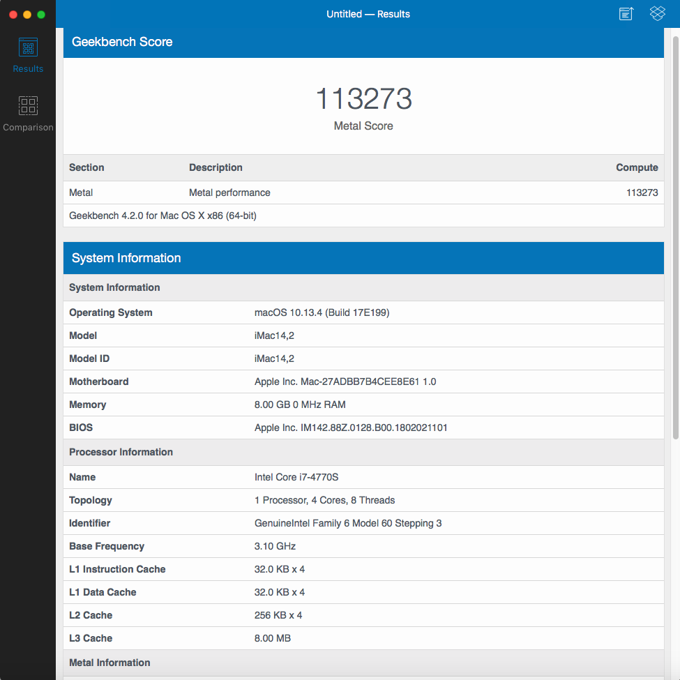

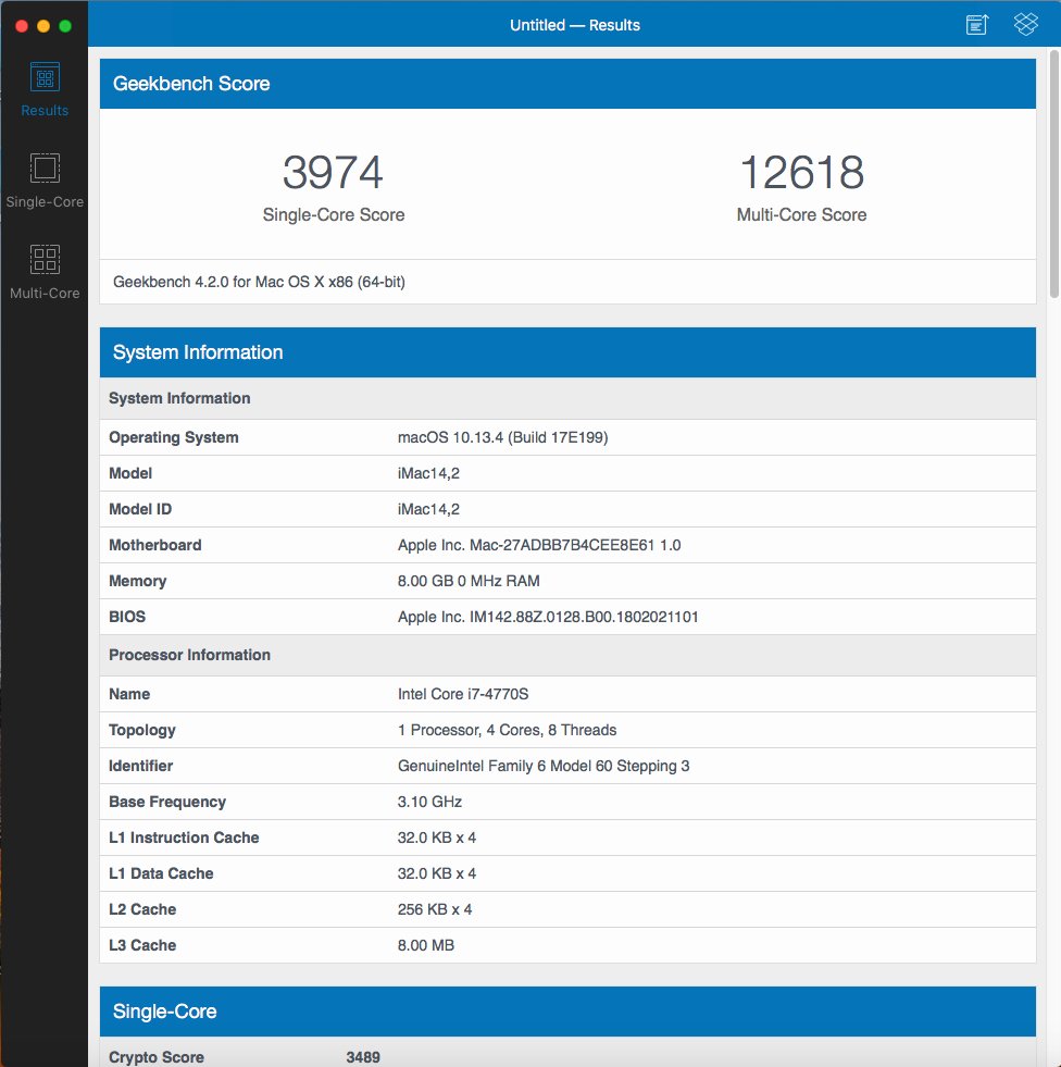

How's your GeekBench results in comparison to his?
Do you use any patches for the kernel in KernelToPatch section under the Kernel and Kext Patches?
Share this post
Link to post

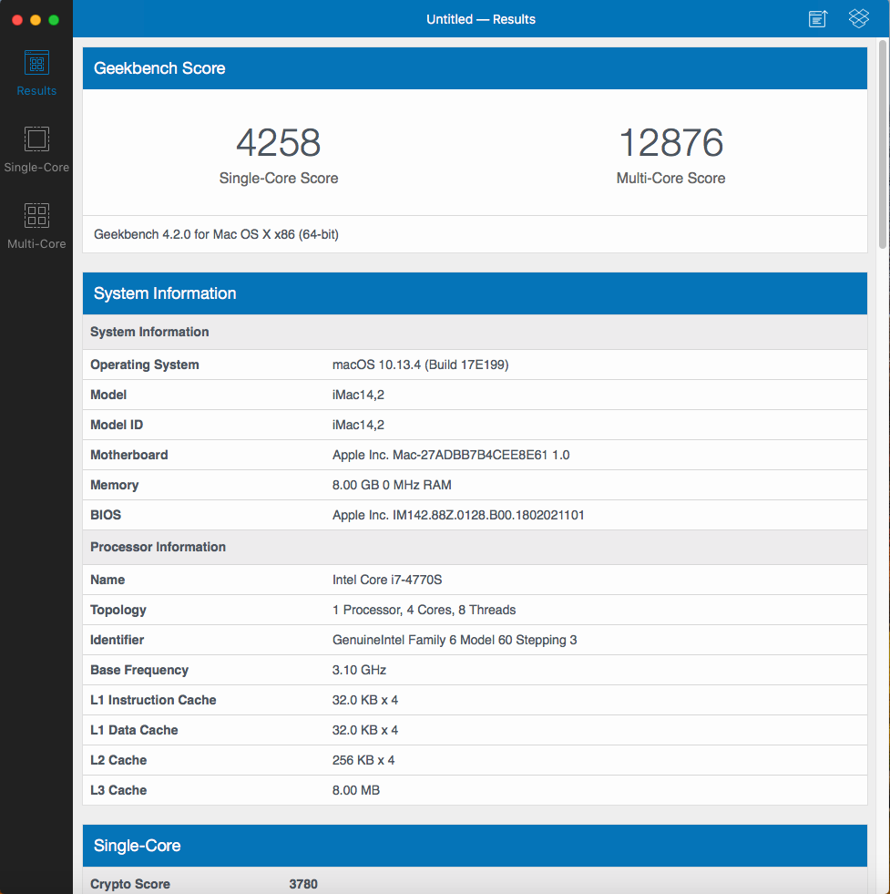

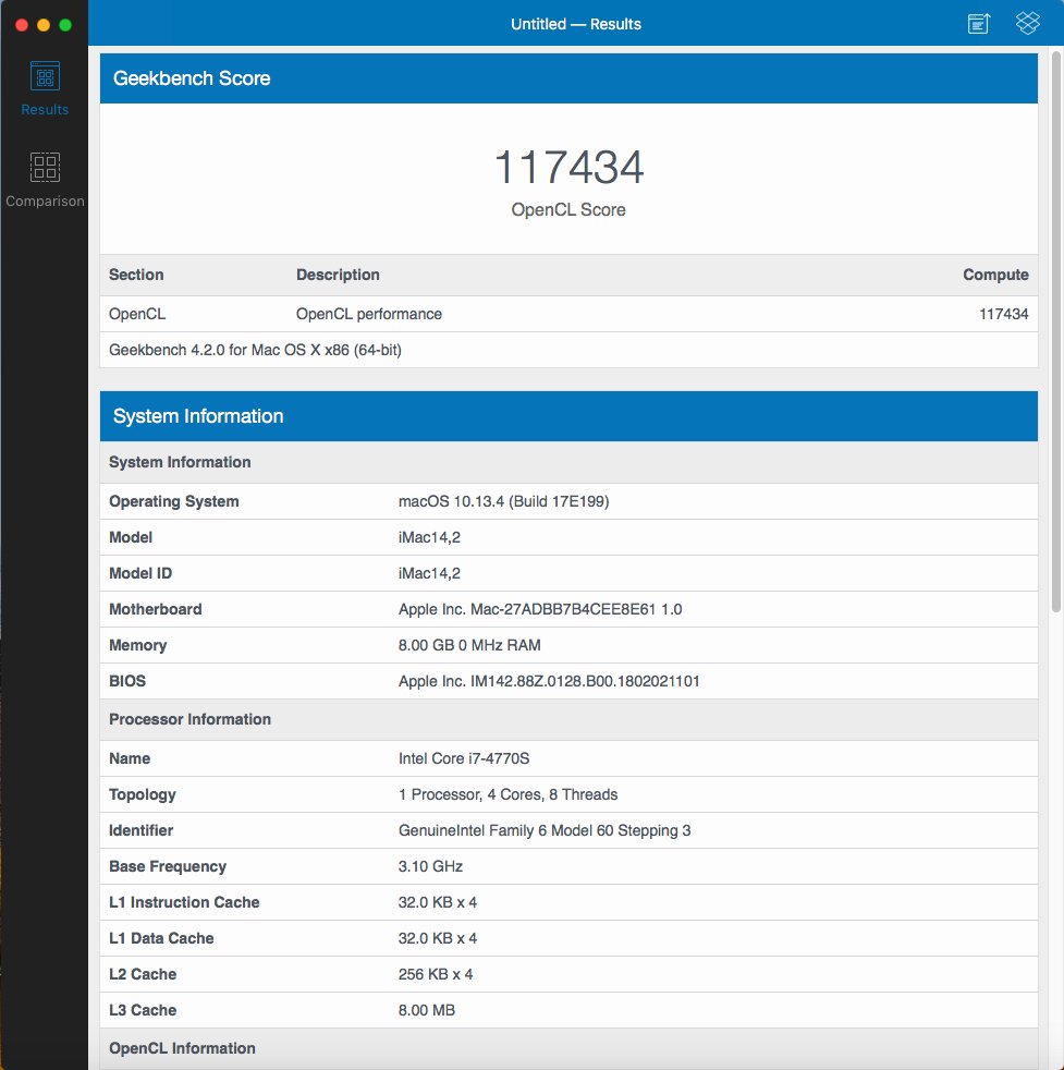

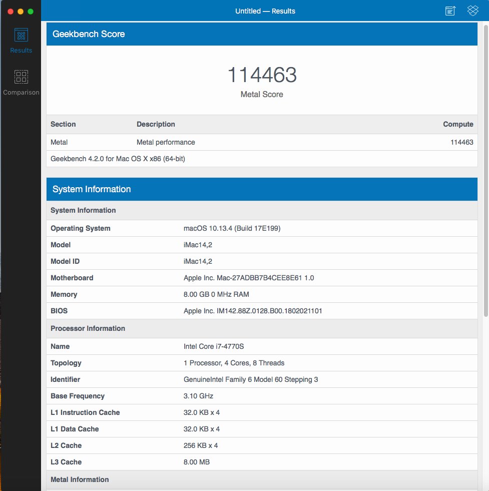

Here's
Metal score
OpenCL score
Geekbench score
This score was done by using Hamachi, Inject ATI and using SSDT patch like the screenshot posted before and using Load VBIOS from ROM folder of clover

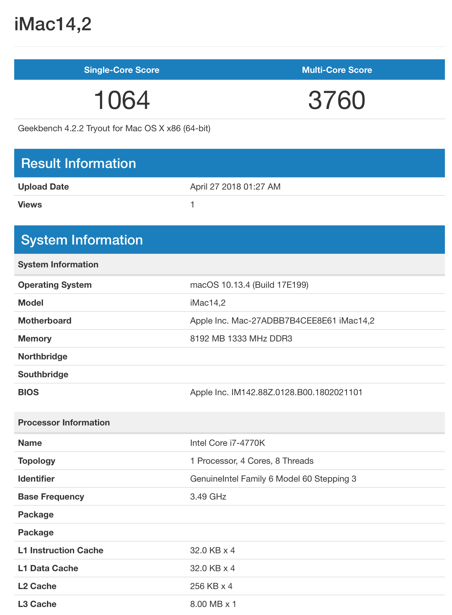

Wow those scores are so much better than mine. Hmmmm... what rom are you using in your clover folder?
I did message power color yesterday to see if they can send me the most current updated rom for my GPU. Hopefully that works.

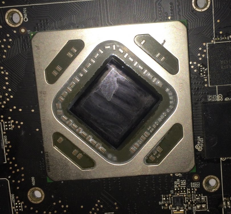

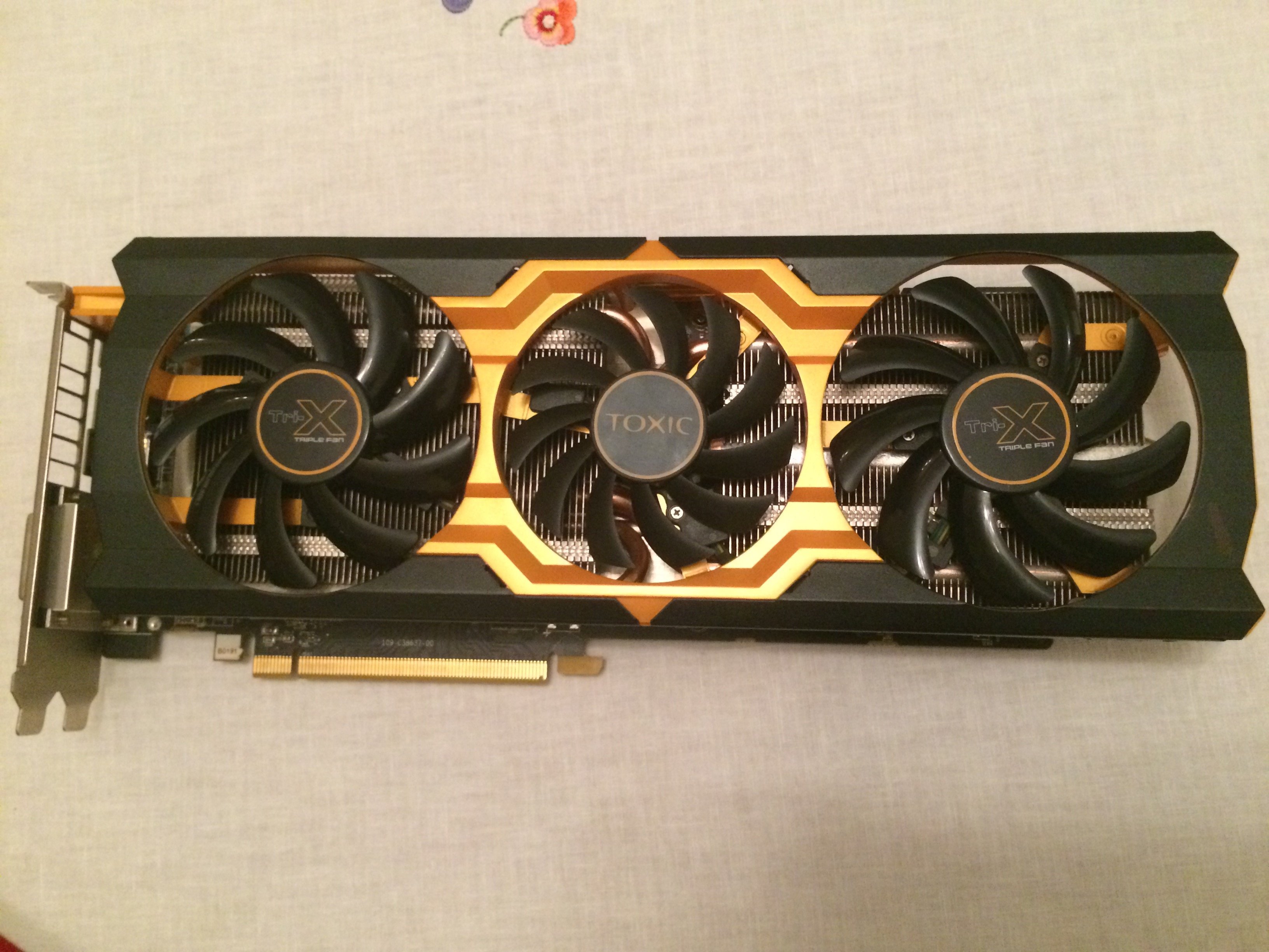

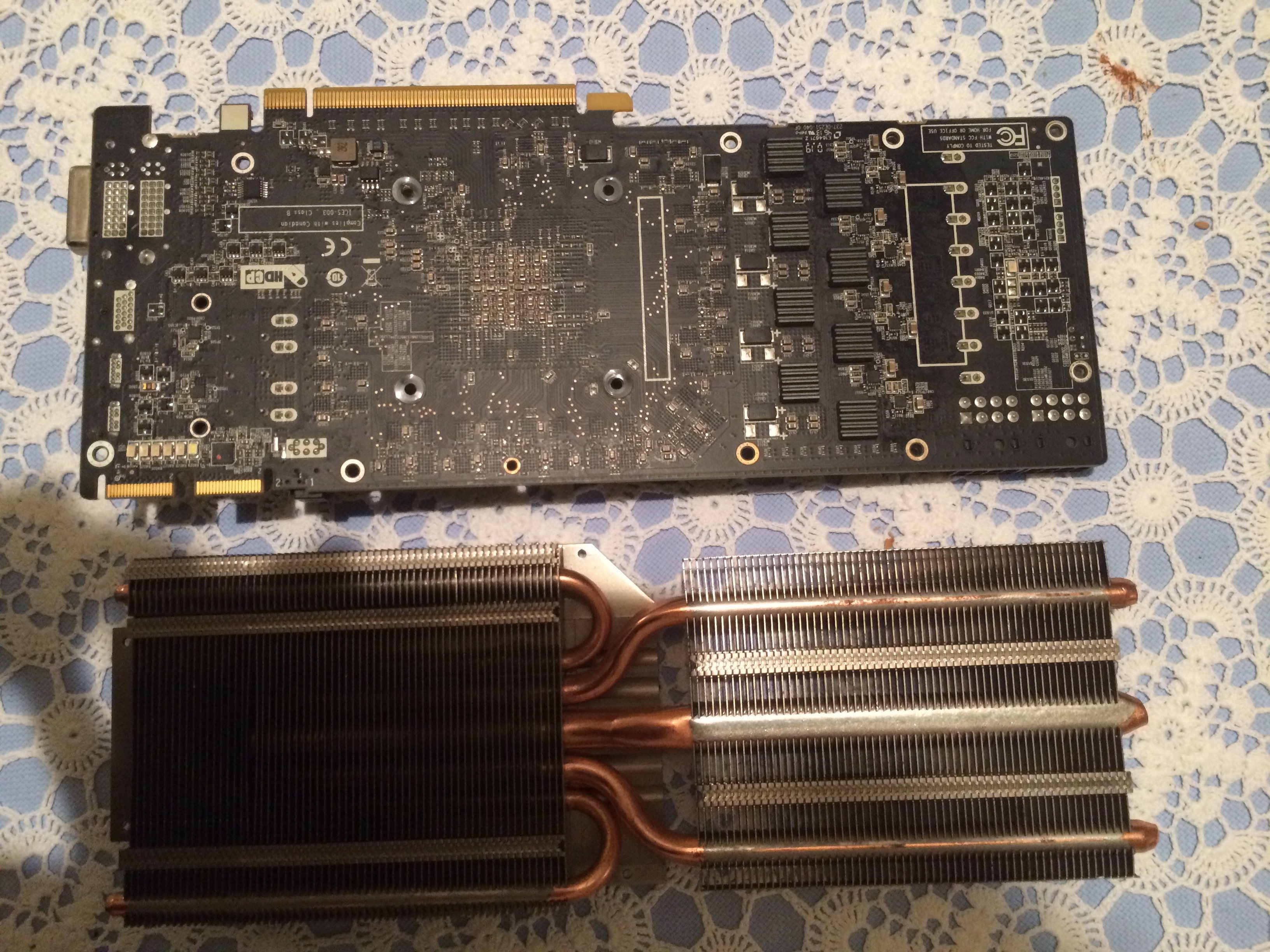

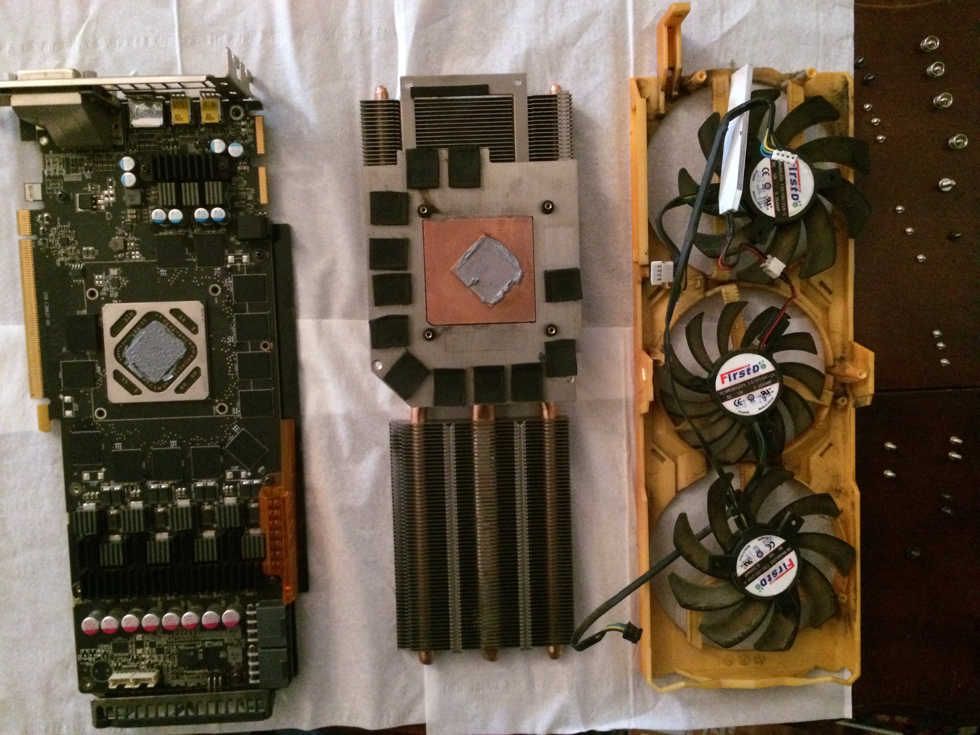

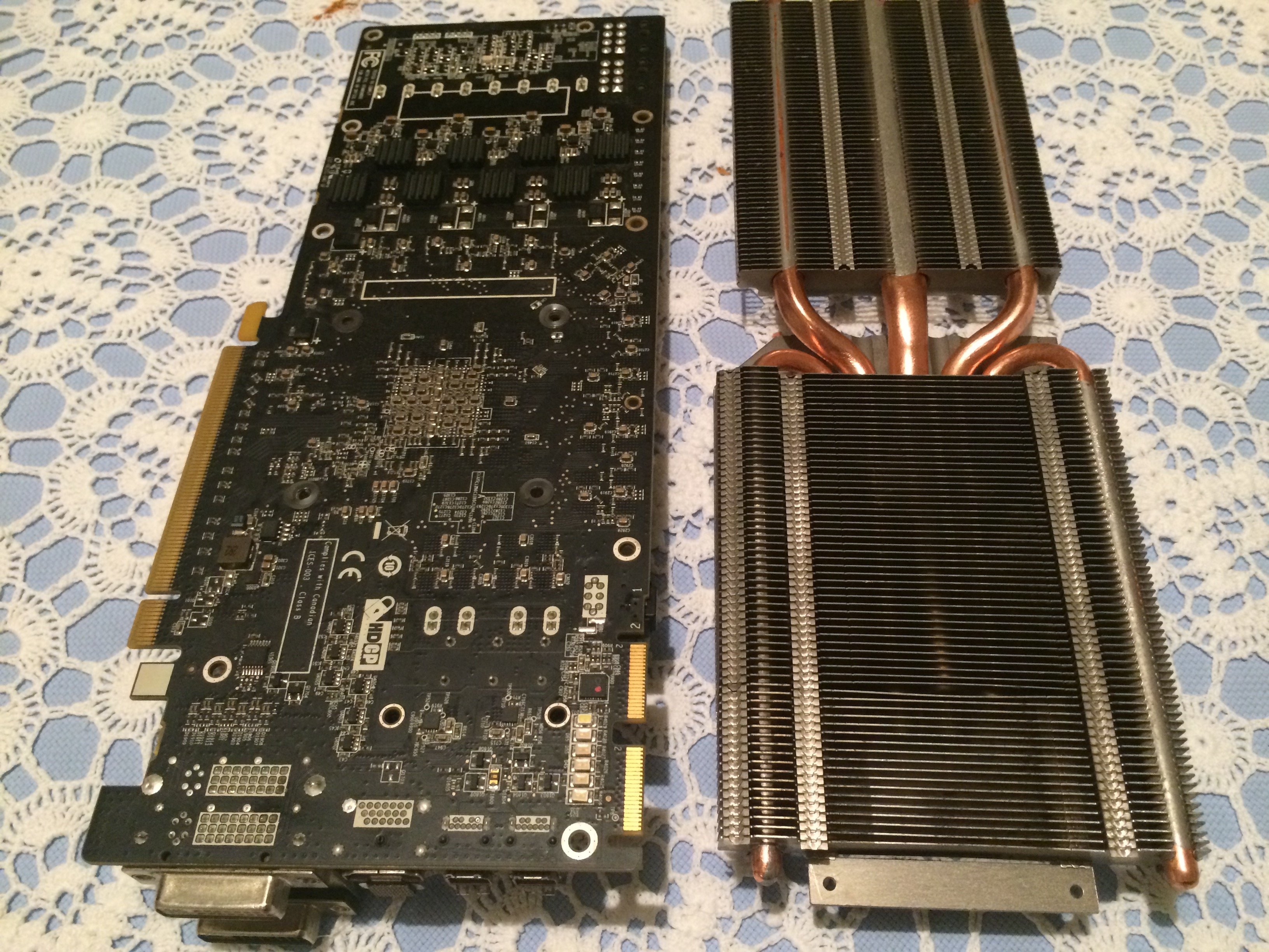

:lol: and here's my card disassembled now, i'll just stick it up and assemble it, hoping that artifacts issue will be fixed:
I think this is not the original thermal paste!
The difference in Geekbench scores can be only because of the GPU and the ROM, and besides isn't your GPU XFX? or is it PowerColor?
Oh Boy! What scene! I hope they glitches get better, don't forget to clean up those blades and the heatsink itself. ;)

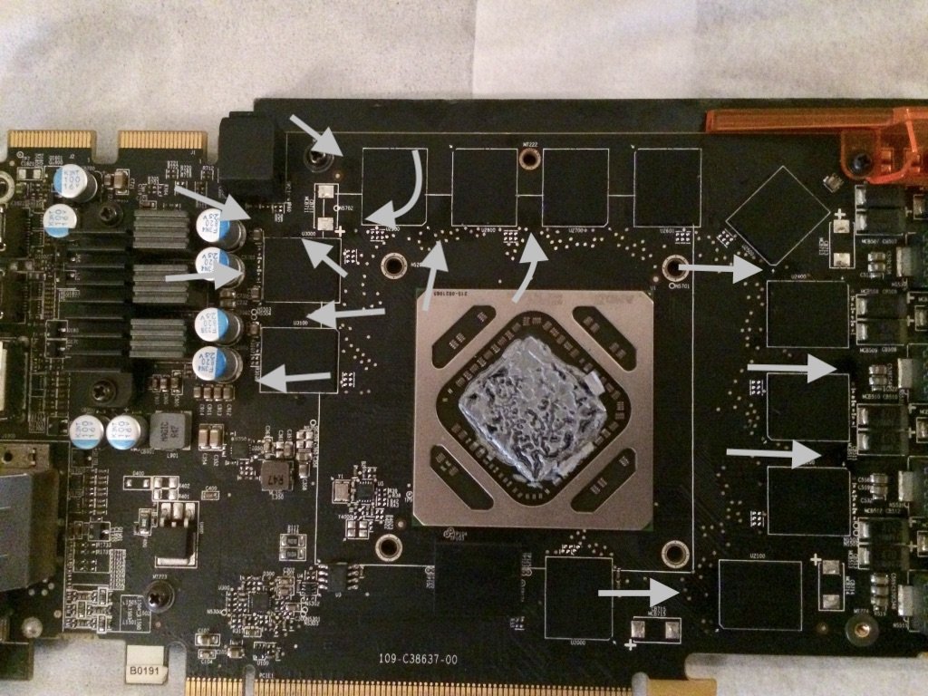

I don't know if this is normal, but i've seen some things like oil in the PCB and in VRAM, i'll upload photos for that right now after going to market to take some gasoline for components, just to clean it better!

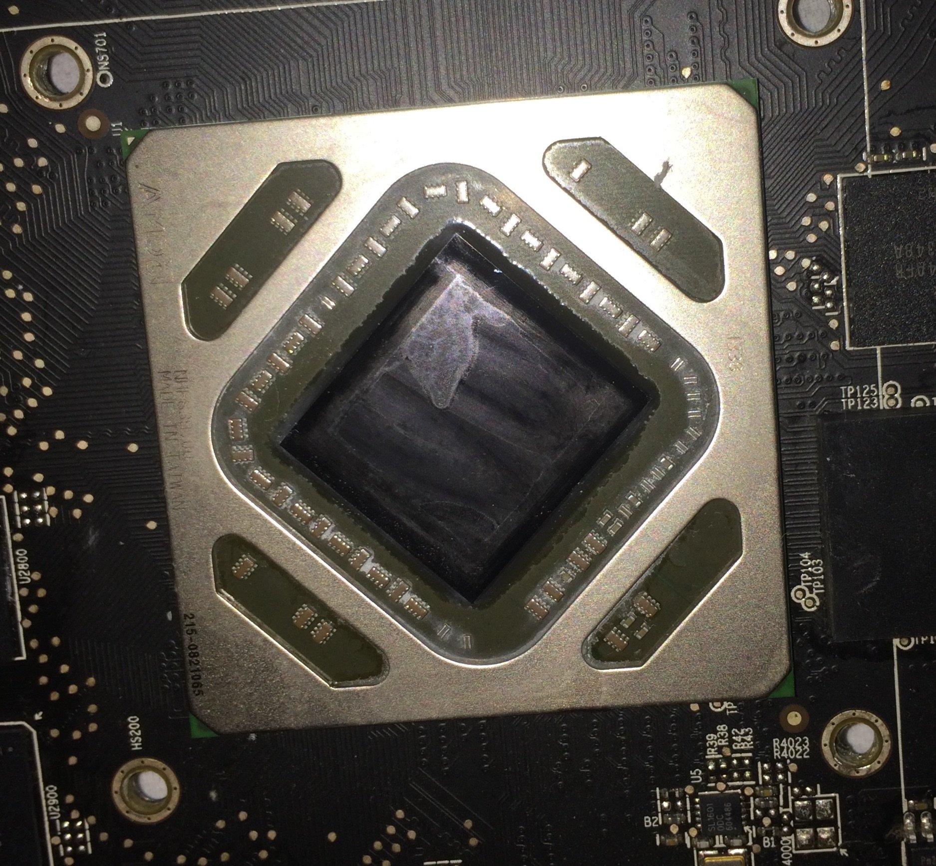

@CyberdevsHere are the Oil things:
I'll begin cleaning right now :D , i forgot, can you tell me where i can add thermal paste beside GPU Chip?
Edited by ammoune78
Those Oils can be from the manufacturing process, that can be simply the soldering oil residue.
Be careful with the gasoline it might damage the chipsets, don't apply any liquid directly to the board, just use the cleaning cloth and moist it with the alcohol and then gently clean the areas that you want.
Hope all goes well and when you re-assemble the GPU it works better than before.

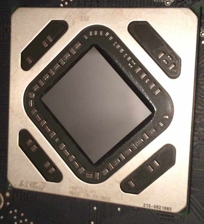

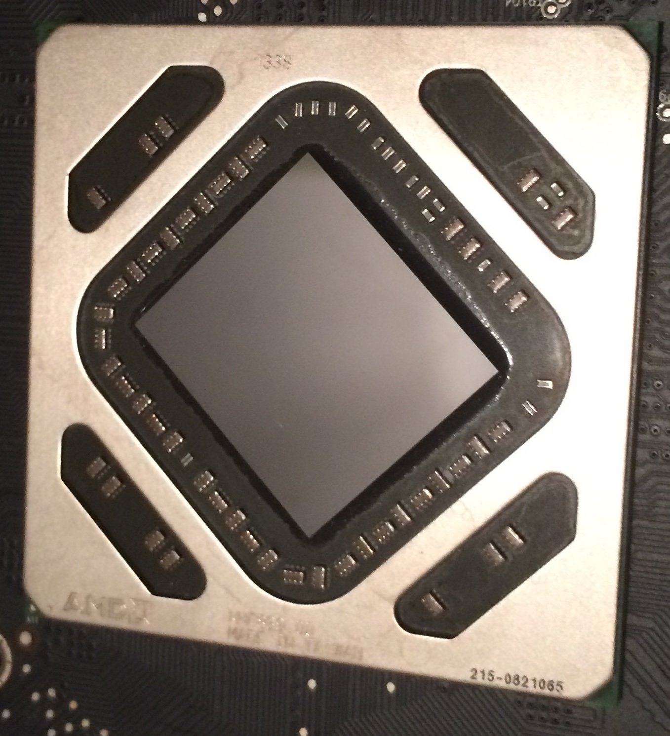

Here are photos for before cleaning the Chip and left on by mistake some of the thermal paste and after cleaning, with others and last result:
I just want to go home, and test it, some of suspense hhhh, and by the way thanks Cyberdevs for your comments that pushed me to do it, really thanks Man :thumbsup_anim:

Worked, and the geekbench is a little bit tricky, a did one test for CPU, Metal and OpenCL GPU. I've got a score not better than the previous one in CPU and OpenCL, did another test and got a score better than the first one, hhhh :D ! But I guess if i  delete the cache and nvram reset, then I'll have better one maybe, here's the scores:
Now I'm gonna stress it with games to see if that real problem has gone or not :cry:
Congrats :thumbsup_anim:
Cleaning the peripherals won't necessarily increase the performance, although it will help them perform better and cooler and then when a device is performing cooler it will increase the stability and longevity ;)
I hope in the stress test the artifacts are gone :D
Edited by Cyberdevs
Share this post
Link to post
Yep, Yes, Well, Super, good, nice, fine, great, fantastic, fantastical, awesome, brilliant, wonderful, grand, terrific, marvelous :hysterical:
They are gone, i've been playing for two hours some games, and not all that i have like (Project Cars, Just Cause III and PES 2018), and no one appeared. I already know that ROTTR can do some artifacts if 15 mn or 30 mn of playing, but Just Cause do them both at 5 mn,  whatever the first time after booting the windows directly or after playing some other games, but i played Just cause III for about 1 hour, no artifacts, no slowness, the card is in total calm, i didn't heard Fans and it was not hot, in contrary of before, it was hot, did a big noise will playing as you can hear it, slowness and the PC come too hot. It's a total huge difference, and now i'm happy, because now it's my big deal that card and for only 86$.
I'll try another test, or i simply will play all games that i have to see if it's definitely indisputable, just to be comfortable.
Thanks again Cyberdevs
Share this post
Link to post
That’s wonderful! and your welcome :)
From what I saw in the photos you sent before the cleanup the bad performance was expected because the heatsink and the fan blades were so dirty and clogged up with dust and other stuf which could impact the air flow and heat couldn’t be transfered efficiently.
Now you have a brand new GPU and I know that the R9 280X is a very powerful card! :D
