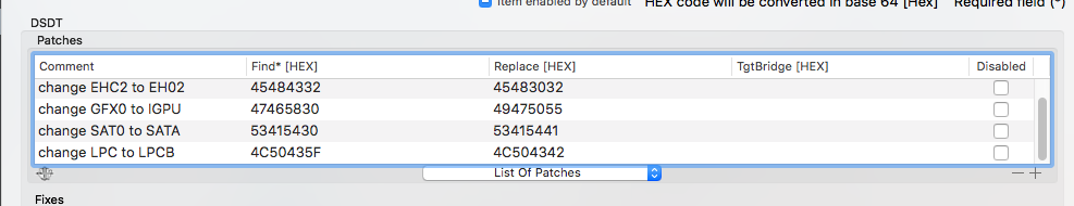

Now I just added USB Patches because you are getting "Still Waiting For Root Device".
It won't do anything useful if your drive is SATA though.
Try again.
CLOVER.zip
Since your drive is probably SATA and it seems like Mac OS can't find it, I would try playing with these patches : 5ade0db36c2f1_ScreenShot2018-04-23at12_45_12PM.png.549bf9d2af70aa594851d2a96cf911ff.png

1 hour ago, jamesst20 said:
I added APFS driver to Allan config.
Try again.
CLOVER.zip

I mean't to fix that. The new attached EFI only contains new USB patch that will unlikely fix anything unless your hackintosh is installed on a USB drive.
If it is installed on your hard drive, as I said, try playing with the patches I attached in the screenshot (i.e. disabling some of them).
Your SATA Mode is AHCI in the BIOS right?
