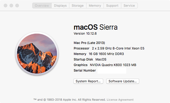

During reboot, I saw something about ACPI... successful.
I tested with Geekbench: 2548 single-core and 19615 multi-core (?), which is better than before (1800)
How could I check if everything is 100% working?

OK bilbo, thank you very much for your precious help.
It is a hard way to knowledge, but thanks to the others we learn a lot!
With HW monitor, I just can see HDD T°, no CPU activity...
(I am using my tables don't worry. Concerning KP's, it is scrolling so fast that I can't read everything.
In fact, sometimes it can generate C states, sometimes not... Odd behavior! Another thing: countdown during Clover is very low, about 3 seconds for 1.)

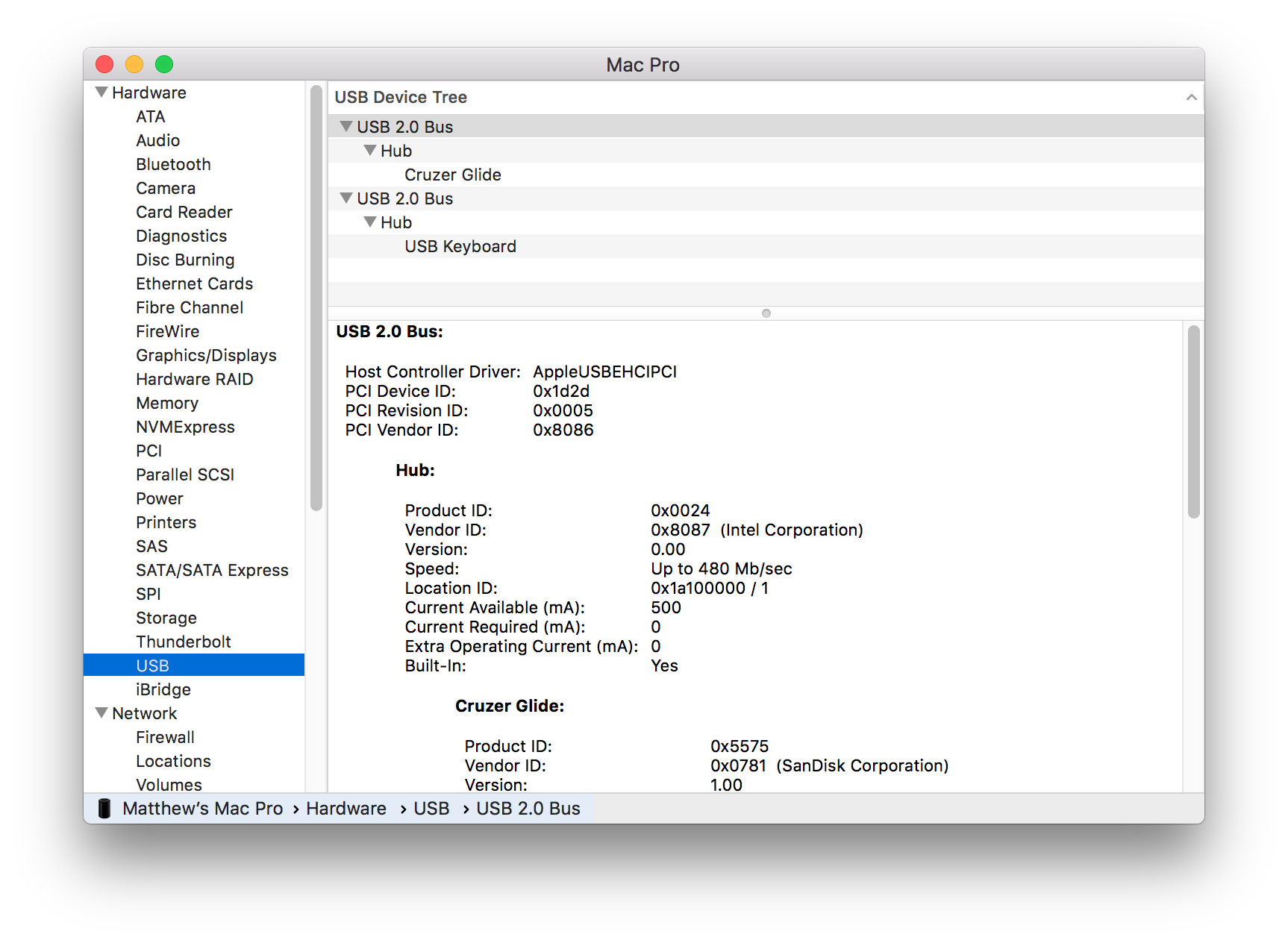

Hello, what about USB3? I have Z620 but have errors only with USB.
Share this post

Thanks to many here, especially @bilbo and @asiansurf. I have an *almost* working Sierra z620 with v3.92 bios on a v2 motherboard with dual E5-2680v2 CPUs. I have a GTX 980ti graphics card.
I created the USB installer and I made some updates using the old version of this guide - the El Capitan which had some supplemental instructions for Sierra. I then used that to install and everything worked OK. I then followed the steps in this guide (though it has been modified a little since then). Powersaving mode causes a problem with USB devices not appearing after I wake the computer, so I have disabled power saving mode. Also, USB3 ports don't work after about half-way through the boot process. Finally, the performance is slower than in Windows. Cinebench (Windows): 2665, (Sierra):  2355. On a positive note, the computer is super quiet in Sierra!
I then went through the updated instructions and tried to re-do the parts that were pertinent. I patched my own DSDT using the instructions but didn't see any change. I patched the SSDT and also didn't see a change. So I tried replacing my kexts with those in the 6 folder. I also diff'd the config and kept my smbios parameters but otherwise used bilbo's config. I also took his DSDT and the SSDT for my CPU.
Now when I boot I get a kp every single time on some part of the FakeSMC stuff. The kp happens at slightly different parts of the message, but always the last line on the screen is something related to FakeSMC, such as, "New prioritized handler CPUSensors".
I know that I am using a newer bios. I don't know how to downgrade. Also, there are slight differences between the Z820 that Bilbo has and my Z620.
For now I am using the computer by booting off of the USB drive.
I am at a loss on how to troubleshoot. I'd love to have my USB ports working and not need to boot off of a thumb drive. Performance similar to Windows would also be great. Lastly, power saving is a nice to have.
Is there any data I can share that would help me do better at troubleshooting?
Also, one challenge I have when reading the guide at the start of the thread is it's not clear to me which steps are optional (i.e. informative) and which ones I actually should perform. I may have done some things twice because I followed the steps that were optional.
P.S. I am OK with Sierra, but I wouldn't mind being on High Sierra. I tried the NTT123 guide and couldn't even get booted. I have my critical files backed up so I don't mind formatting and starting over. I think that guide is a little to short and intermingled with some outdated info.
Hello SquidGM,
I tried using the mXHCD.kext but it does not seem to work for me. At least for the Z620.  I didn't do any complex patches or fixes and just use High Sierra as-is.  Hope there is a simple fix for USB3 for us.  But I can live without it.  I just need Thunderbolt and a stable macOS.
Hope that you have better luck.
Update :
I have followed Bilbo's instructions for fixing religiously until the USB3 which includes using MaciASL to generate my own DSDT, compile etc. and the audio, USB2 and USB3 works!! I'm skipping PM because it looks complicated and wouldn't want a kp to troubleshoot!
Somehow, the fixes messed with IRQ for my bluetooth and now it's disabled....
Edited by asiansurf
Update to include USB3 success! But bluetooth disabled.
Share this post

I have had some improvements with my z620. I downgraded the bios to v3.91, same as used throughout this guide. Then I got rid of my EFI/CLOVER folder, copied over from the installer and then followed the guide. All worked according to plan.
I appear to have semi-functional USB3. For example, USB speakers that work on my MBP don't work. However, the system does pick up the microphone in the webcam connected to the hub built into the speakers.
[computer - usb3 port] ---> [speakers with hub] ---> Web cam / microphone (only the microphone works) Weird, huh? (unless you plug them in after booted)
Lastly, patching the DSDT did not work for me, and I followed every step spelled out in the guide and in the posts by oliveg. I copied the tables to the DSDT and that did not have an effect. I even specified extra parameters to ssdtPRGen.sh in order to explicitly describe my CPU.
Apparently it's weirder than I thought. The USB 3 on the back sometimes work, sometimes doesn't. I can always plug one USB2 device in on the back and one on the front. Sometimes, that's all that works. Sometimes, I can do more. Not a huge deal at the moment, but would be nice to have working. I will do some troubleshooting and see if I can post details. I may be delayed slightly, because the computer is working and it's almost the end of semester.

On 5/4/2018 at 8:05 AM, ochja said:
maybe your z620 is similar to my z420 ?
i have to change the ports in the SSDT-UIAC-ALL with maciASL
my HP z420 USB Ports are
USB3
- PEX3
USB2
- EH02 PR21
-- HP22 (Front USB Card Reader - fully working ;-) )
-- HP23 (Front USB 2.0 Port)
-- HP26 (Front USB Card Reader)
- EH01 PR11
-- HP11
-- HP12
-- HP13
-- HP14
(the 4 USB 2.0 rear Ports)
regards
SSDT-UIAC-ALL.aml
 Hello,
Not woking for me.

Thank you, bilbo for you detailed guide!
I want to report that sleep is working on my Z820. Still can't reproduce it on another installation with High Sierra because of lack of knowledge
Edited by jack.avenger
