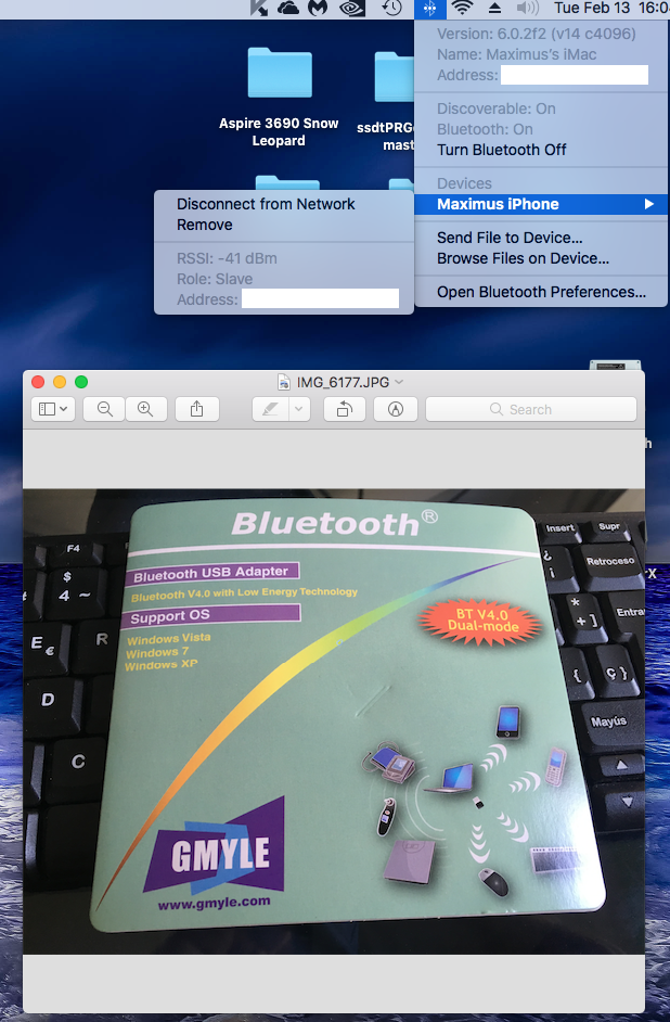

Well guys. I got the Dongle and it was recognized directly. Paired my iPhone and sent pictures by Airdrop.
But it show the devices but connect and disconnects. Dunno if something more is necessary to do.

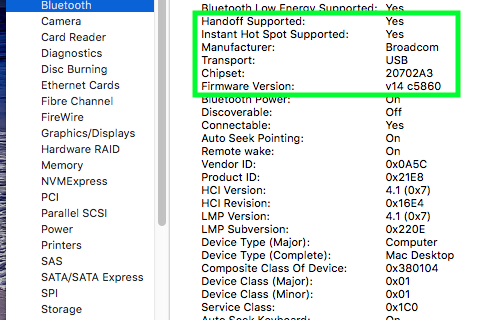

Handoff is not working. Installed Kext´s but to no avail.
My wifi has a Broadcom BCM4360 and the dongle BCM 20702A3 with firmware v14 c5860.
If someone has a solution for this would be appreciated.

Still Handoff not working.
Firmware update kexts BrcmPAtchRam2.kext and BrcmFirmwareRepo.kext not updating the firmware when booting. Putting these on "Other" or in S/L/E has no effect. Firmware on first power up would remain in version 4096.
The only walk around I found for the dongle to autoupdate was to boot first windows 10 and later a restart and boot MAcOS. (This solution works and update the firmware to v14 c5860) Sadly this has to be done every time I do a complete power off else it would stick to 4096.
Has anyone paired effectively this Broadcom chipset 20702A3 with wifi Broadcom 4360?

Exactly. If "4096" appears then means the update is not loaded. Anyways with that version Airdrops works fine but is more to me to understand why the kexts are not working as it should. My version always update as I boot Windows 10 first every day before High Sierra.
As handoff concerning is not something ir really use but it would be nice to have it working anyways. Just to say I did it  :D

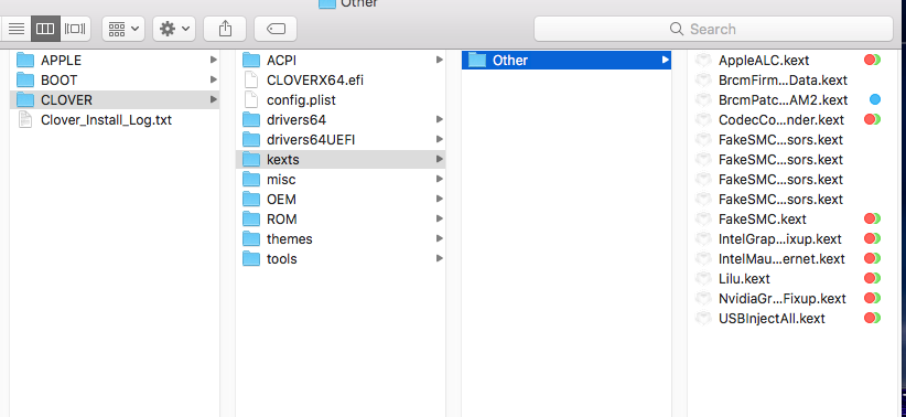

Got it right now, I found my mistake.
I used Repo in Clover instead of Data. Replaced it and it works.
I´l try using Data too. Used Repo before and saw no change so just wiped ram and repo.
After I test with a complete power off without loading windows before I`ll post the results.
Update:
Sailor
you were right. Worked using Data instead of Repo. Strangely the indications told the contrary... But now working as it should.
Regarding Handoff lets see if someone dig more over this in the future.
* For those with the same bluetooth dongle chipset and with High Sierra just put "BrcmPatchRAM2.kext" & "BrcmFirmwareData.kext" in clover "others".
