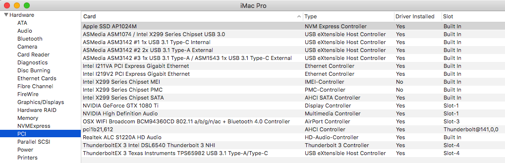

Everything works again as expected:
Note however that this update does not resolve yet the USB3.0 related issues witnessed with 10.13.3 public beta 6 (17D2046a).
Enjoy and have fun

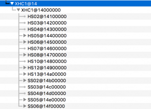

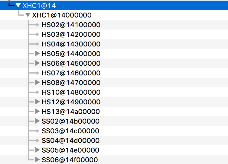

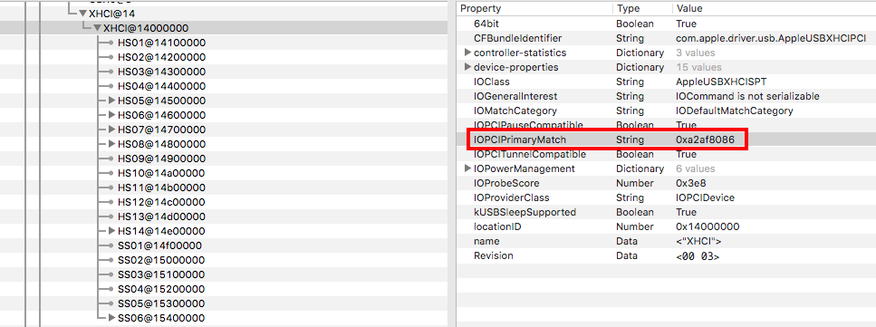

@Matthew82, just discovered why all USB3.0 ports are non-functional under 10.13.3 beta 6.
Since 10.13.3 beta 6, XHCI@14000000 uses  an AppleUSBXHCIPCI driver with IOPCIClassMatchID 0x0c033000 instead of 0xa2af8086.
I could use my XHC USB kext to force OSX to use the  AppleUSBXHCIPCI driver with IOPCIClassMatchID 0xa2af8086.
However, I would prefer to achieve the latter in the frame of an AML implementation. Is this possible at all? and how to achieve it if possible?

 I am neither talking about the device id nor the class id.
I am talking about the AppleUSBXHCIPCI driver IOPCIClassMatchID used by XHCI@14000000..
Not talking about XHCI@14
If all your ports work which AppleUSBXHCIPCI driver do you use?
USB3.0 stopped working under 10.13.3 beta even within the XHC USB emergency configuration, which means no XHC USB kext nor SSDT.aml
My guess is that in my case the wrong AppleUSBXHCIPCI driver is loaded.
​Formerly it was always the one with IOPCIClassMatchID 0xa2af8086 which was working. Now I have the one with IOPCIClassMatchID 0x0c033000 which does not work.
The device id of XHCI@14 was also previously 0xa2af8086, and the class id as well 0x0c033000. This did not change at all.

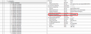

iMacPro XHC USB Kext to be tested by all users facing issues with XHC USB3.0 under 10.13.3 beta 6
Within the 10.13.3 betas, Apple suddenly assigns to XHCI@14000000 an AppleUSBXHCIPCI driver with IOPCIClassMatchID 0x0c033000 instead of 0xa2af8086. This results in the loss of native XHC USB3.0 support and in the malfunction of all XHC USB3.0 ports at least on the ASUS Prime X299 Deluxe. I don't know if we can find a way to properly inject the AppleUSBXHCIPCI driver with IOPCIClassMatchID 0xa2af8086 via our SSDT-X299-iMacPro.aml.
However it can be easily injected via the XHC USB kext attached below. With KGP-iMacPro-XHCI.kext, all USB2.0 and USB3.0 ports will become fully functional. This kext should be at least fully compatible with the ASUS Prime X299 Deluxe, but hopefully it will be also compatible with all other mainboards facing the same IOPCIClassMatchID issue.
Under 10.13.2, this kext also properly implements all USB HDDs and SSDs as external drives, where else all USB2.0 and USB3.0 drives are also still correctly and fully natively implemented by OSX, thanks to the AppleUSBXHCIPCI driver with IOPCIClassMatchID 0xa2af8086.
Your user feedback about XHC USB Kext compatibly and functionality is highly desired and appreciated.

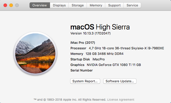

Up and successfully running official release of 10.13.3 (17D2047)
The good news are that with the official release of 10.13.3 (17D2047) the AppleUSBXHCIPCI driver with IOPCIClassMatchID 0xa2af8086 is back to XHCI@14000000
and the entire XHC USB 3.0 issue during the 10.13.3 betas has been removed by itself automatically.
All XHC USB2.0 and USB3.0 ports are again natively implemented. Apple even solved the previous problem of the internal implementation of USB HDDs and SSDs. All USB drives are now correctly implemented as external.
The entire XHC USB Kext discussion is herewith obsolete. Full native XHC USB implementation without any need for additional USB kexts!
BTW, @Matthew82, try to remove  XHCI-200-series-injector.kext and you will see to what I am referring to.
Cheers and good night,

      My actual respective X99 EFI-Folder distribution contains an already fully functional AppleALC audio configuration. The latter consist of:
      1.) Actual versions of codeccommander.kext,  AppleALC.kext and Lilu.kext in "/EFI/CLOVER/kexts/Other/
      2.)  Note that ALZA -> HDEF ACPI patch needs to be added to the config.plist in Section "ACPI" of Clover Configurator, in case one does not use the adopted system SSDT discussed in Section 9.2).
      Comment:                Find:           Replace: ALZA -> HDEF     414c5a41        48444546
      3.) Audio ID Injection "5" in the config.plist under Audio/Inject in Section "Devices" of Clover Configurator.
          This audio configuration provides a correct analogue onboard audio chipset system implementation.    The correct digital HDMI/DP HDAU PCI device implementation will be detailed in Section E.9) in line with the HDEF and GPU PCI device implementation.   Thanks to @nmano for helping me with the initial AppleALC audio setup for 10.14 Mojave.
      E.4) USB Configuration    Since 10.13.SU and with AppleIntelPCHPMC, macOS should properly implement all external and internal XHC USB 3.0 (USB 3.1 Gen 1 Type-A) and USB 2.0 (USB 2.0 Gen 1 Type-A) connectors, always provided that one uses working USB port limit patches.
        Valid USB port limit patch for 10.14.4 provided by @PMHeart (hardwired but yet disabled in my respective EFI-Folder distribution) by following USB port limit patch approach for 10.14.3 by [USER=1614363]@ydeng[/USER]:
      USB port limit patch for 10.14.4 provided by @PMheart:
      kext : com.apple.iokit.IOUSBHostFamily Find : 83FB0F0F 87 Replace : 83FB3F0F 87 Name : USB Port Limit Patch 1 ©PMHeart kext : com.apple.driver.usb.AppleUSBXHCI Find : 4183FF0F 0F83 Replace : 4183FF3F 0F83 Name : USB Port Limit Patch 2 ©PMHeart kext : com.apple.iokit.IOUSBHostFamily Find : 83E30FD3 E34109DF Replace : 83E33FD3 E34109DF Name : USB Port Limit Patch 3 ©PMHeart
      Former USB port limit patches for 10.14.3 provided by ©ydeng:
      kext : com.apple.iokit.IOUSBHostFamily Find : 83FB0F0F 871604 00 Replace : 83FB3F0F 871604 00 Name : USB Port Limit Patch 1 ©ydeng kext : com.apple.driver.usb.AppleUSBXHCI Find : 83FB0F0F 838F0400 00 Replace : 83FB3F0F 838F0400 00 Name : USB Port Limit Patch 2 ©ydeng kext : com.apple.iokit.IOUSBHostFamily Find : 83E30FD3 E34109DF Replace : 83E33FD3 E34109DF Name : USB Port Limit Patch 3 ©ydeng
      However, it is strongly recommended to use board-specific XHC USB kexts in addition. Such board-specific XHC USB kexts can be easily created for any motherboard of any brand by following my respective XHC USB Kext Creation guideline. Being mainboard specific, a XHC USB kext is only valid for one particular mainboard model although users of the same mainboard model naturally can share the same XHC USB kext, if complete and properly implemented without any additional efforts.   KGP-iMacPro-ASUS-X99AII-XHCI.kext would be the XHC USB kext for the ASUS X99-A II with all 20 ports implemented.   However, it is strongly recommend to keep respective USB port limit patches disabled and to use a truncated 15-port kext instead, which might avoid buffer overruns and makes your system more vanilla with respect to future macOS updates.   For the truncated 15-port kext, we have to drop some of the 20 HS and SS ports implemented from the kext to stay within Apple's 15 USB port limit. For truncating a fully implemented XHC USB kext (all 20 HS and SS ports implemented), I usually recommend to drop one out of usually two internal USB3.0 connectors (which already reduces the number of implemented ports to 16 for the ASUS ASUS X99-A II):       To remain within the 15 USB port limit, I also recommend to drop one of the four USB2.0 ports at the backside of the mainboard from the kext (HS05, HS06, HS13 or HS14), which further reduces the number of implemented USB ports by one.     Thus, in total we have now 15 implemented HS and SS ports and we just stay within the 15 USB port limit. In the truncated KGP-iMacPro-ASUS-X99AII-XHCI-15port.kext attached below, I removed HS03, HS04, SSP3, SSP4 (assigned to the internal USB3.0 header USB3_34) and HS05 (assigned to the most right USB2.0 connector in the second column from top on the back panel of the mainboard) from the kext. By this, all other USB2.0 and USB3.0 ASUS-A II onboard connectors remain fully functional. Alternatively, one could also drop e.g. HS01, HS01, SSP1, SSP1 (assigned to the internal USB3.0 header USB3_12) and either HS13, HS14 or HS06 from KGP-iMacPro-ASUS-X99AII-XHCI.kext. Up to your personal taste.   All experienced users are kindly invited to provide their fully implemented XHC USB kext and truncated 15-port XHC USB kext for a motherboard not yet being part of the respective XHC USB Kext Library with an implemented port-layout.rtf and by else following the correct kext nomenclatures defined in my XHC USB Kext creation guidelines in line with full motherboard and SMBIOS denominations.   Remaining USB ejection issues during sleep/wake likely can be fixed by 3rd party software tools like e.g. mountain.app
      E.5) M.2/NVMe Configuration
      In contrary to macOS Sierra 10.12, and like already in case of macOS High Sierra 10.13, also macOS 10.14 Mojave provides native support of non-4Kn NVMe SSDs, like my Samsung EVO 960 M.2/NVMe. All patches applied under macOS Sierra 10.12 are obsolete. The native support of non-4Kn NVMe SSDs enables the unique opportunity to directly perform a clean-install of macOS High Sierra 10.13 on M.2 NVMEs like the Samsung EVO 960.   The only current drawback consists in the external drive implementation of NVMEs. This minor issue should be easily solved by adding the actual External NVME Icon KextToPatch entry to the config.plist by means of the Clover Configurator. [code] Name*            Find* [HEX]           Replace* [HEX]        Comment IONVMeFamily     4885c074 07808b20     4885c090 90808b20     External NVME Icon Patch[/code] Not however that within the actual 10.14 Mojave distribution, this approach does not seem to work anymore, despite the KextToPatch entry detailed above. If you still have your NVMe implemented in form of an external drive you have to perform the following workaround, detailed below.
        1.) Disable the not working External NVME Icon KextToPatch entry.   2.) Open the IORegistryExplorer, in the upright search field type nvme and take not of values in the left column, i.e. indicated as v.1, v.2 and v.3 and marked by red rectangles in the figure below. As you can see by following these entries, your nvme device shows up in PCI0@0 > BR1B@1,1 > H000@0     3.) Download and unzip the SSDT-NVMe-extern-icon-patch.aml.zip, and open the SSDT-NVMe-extern-icon-patch.aml with MaciASL-DSDT.app, both attached towards the end of this guide. For deviating system configurations, replace the values highlighted in blue color in the figure below with those of your IOReg, marked by red rectangles and indicated by v.1, v.2 and v.3 in the figure of my IOReg above.     4.) Save and copy the modified SSDT-NVMe-extern-icon-patch.aml to the /EFI/CLOVER/ACPI/patched/ folder of your system drive.   5.) Reboot   Now your NVMe drive should correctly show up as internal.

      E.7) GC-Titan Ridge / GC-Alpine Ridge or ASUS TBEX 3 Add-in PCIe Adapter Implementation
      For the successful implementation of the GC-Titan Ridge (recommended), GC-Alpine Ridge (compatible) or ASUS Thunderbolt EX3 (R.I.P) PCIe Add-In Adapters, a fully working Dual Boot System with an UEFI Windows Implementation is unfortunately absolutely mandatory. You will not be able to configure your Thunderbolt 3 Adapter in the mainboard BIOS, until the Adapter has been successfully recognised and initialised by the UEFI Windows System. Fortunately legal and official License Keys for the actual Windows 10 Pro distribution can be purchased with a little bit of temporal effort on Google for an actual price of 20 $ or even below! Thus, the installation of a dual boot system with Windows will require some additional temporal user effort but will not noticeably further affect the users's budget.   Please note that I especially emphasize the term UEFI, when speaking about the parallel Windows implementation. Don't use or perform a Legacy Implementation of Windows! In order to properly implement your Windows partition later-on in the Clover Bootloader and to comply with the actual Mainbaord-BIOS settings requirements, it is absolutely mandatory to run or perform an UEFI Windows implementation!   So if not already implemented, how to achieve a fully working UEFI Windows Implementation and Dual boot System with Windows?   1.) Important Note! For the implementation of the UEFI Windows Distribution disconnect all usually plugged macOSDrives from your rig! The Windows installer will implement a Windows Boot Loader! If you have any macOS Drive connected during installation, the latter Windows Boot Loader might overwrite and destroy your current Clover Boot Loader. This is the last thing you want! Thus for the windows installation just connect the destination drive for the installation and the Windows USB Flash Drive Installer your will create in the subsequent step below!   2.) This Tutorial explains in all necessary detail how to download an actual Windows 10 Creator distribution,  and how tosubsequently create a bootable USB Flash Drive Installer for a subsequent UEFI Windows 10 installation by means RUFUS! Don't put emphasis on alternative optional methods and always take care that you just follow the instructions for a successful subsequent UEFI Windows Installation!   3.) This Tutorial explains in all necessary detail how to properly perform the actual Windows 10 Pro Creator UEFIInstallation, subsequent to the a bootable Windows USB Flash Drive Installer realisation detailed in 2.) above.   4.) This Tutorial explains in all necessary detail, how to migrate/clone/backup your Windows 10 UEFI System Disk afterinstallation for future maintenance and safety.   5.) After successfully performing the UEFI Windows 10 Pro Creator Implementation, you can reconnect your macOS driveto your rig. The newly created UEFI Windows 10 Pro Creator Partition will automatically appear as a further boot option in both BIOS Boot Option Menu (F8) and Clover Boot Menu! No additional or further actions or measurements have to be taken!   6.) Once your Windows 10 Pro Creator Partition is fully operational, install all mainboard drivers and programs implemented on the DVD attached to your mainboard.    7.) Now switch off your rig and start with the installation of our Thunderbolt 3 Add-In PCIe Adapter
      I recommend to install the Thunderbolt 3 Add-In PCIe Adapter in the 4th PCIe Slot from top, which is PCIEX_3   8.) Reboot into windows and install accompanying TB3 PCIe Drivers and Software.
      9.) Reboot and enter the Mainboard BIOS (F2)
      Go to /Advanced/ Thunderbolt(TM) Configuration/ and apply the following BIOS Settings detailed below:     10.) Shut down your rig, connect the Thunderbolt Device to your Thunderbolt 3 Adaptor and boot your system.
      11.) You are done! Your Thunderbolt 3 Adapter and the connected device should now be fully implemented and functional.
      12.) We will add TB XHC USB and TB HotPlug functionality in Section E.9.2) of this guide. Note that with the GC-Titan Ridge, HotPlug functionality can be gained with the THB_C connected. For HotPlug with the other TB adaptors, the THB-C must be removed from most of the available mainboards.   E.8) Gigabit and 10-Gbit Ethernet Implementations    Section E.8.1) and and E.8.2.) below, describe in all necessary detail how to gain full Gbit and 10-Gbit LAN functionality on X99 systems.
      E.8.1) ASUS X99-A onboard Gbit functionality
      The Intel I218-V2 Gigabit on-board LAN controller of the ASUS X99-A II is implemented by means of IntelMausiEthernet.kext (already part of my EFI-Folder distributions).

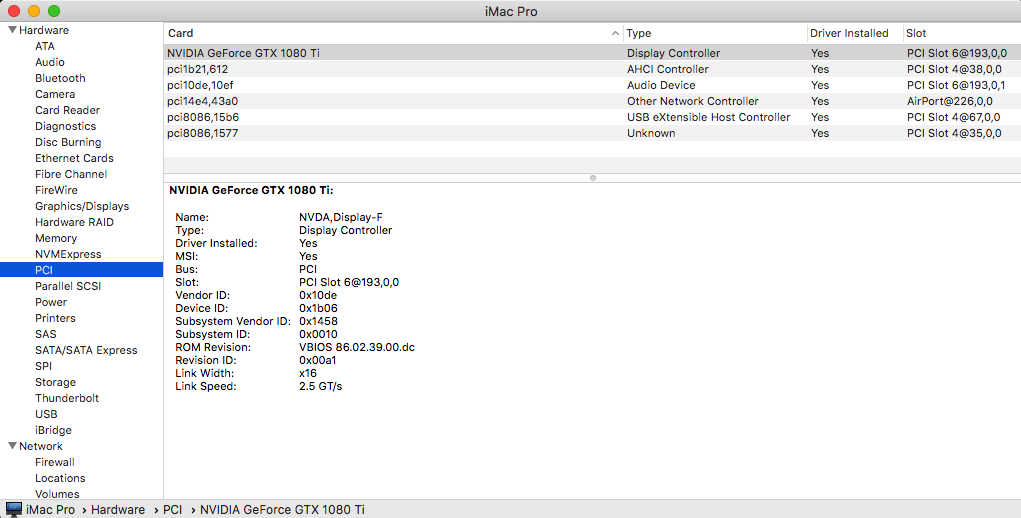

      Note that there also Radeon VII, Vega56, RX580 and RX560 SSDTs available in my X299 SSDT Github repository, which likely need to be adopted depending on your motherboard and GPU PCIe slot population by following your original IOREG ACPI table information.   C.) Nvidia GPUs
      The actual SSDT-X299-Nvidia.aml GFX0 and HDAU PCI device implementation is valid for SMBIOS iMacPro1,1 (GFX0), the ASUS Prime X299 Deluxe and any Nvidia Graphics Card implemented in PCIe Slot 1.
      It is a build and PCIe slot population dependent device implementation. Nvidia Graphics Card users with more than one graphics card, with a Nvidia graphics card in a PCIe slot different from PCIe Slot 1 or with a mainboard different form the ASUS Prime X299 Deluxe, will have to adopt the respective device path entries PC02.BR2A, ACPI DSDT replacements and PCIe Slot definitions following their respective IOREG entries. Note in this context the actual SL05 -> PEGP and PEGP -> GFX0 ACPI replacements directly performed within the SSDT.
      Also note that with 10.13.4, Apple changed the com.apple.driver.AppleHDAController implementation. To make the NVIDIA HDAU PCI device driver work for e.g. a GeForce GTX 1080 Ti, one needs to add the following KextToPatch entry in Section "Kernel and kext Patches" of Clover Configurator, as already implemented but yet disabled in the config.plist contained in my actual respective X299 EFI-Folder distribution:
        Name* Find* [HEX] Replace* [HEX] Comment com.apple.driver.AppleHDAController DE100B0E DE10EF10 FredWst DP/HDMI patch
      Thus, please all Nvidia users enable and like adopt the NVIDIA HDAU patch for your particular Nvidia GPU in dependence of the respective device-id.
      Credits to @FreedWst and thanks to @fabiosun for pointing me to this solution.
      Users of Whatevergreen.kext might be able to drop this KextToPatch entry, as the latter kext already properly implements the Nvidia HDAU PCI driver.

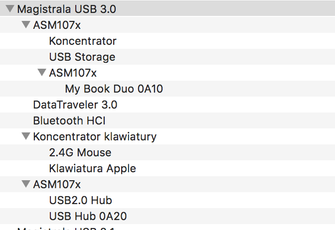

      E.9.2.4) - USBX:
      When using the XHCI device name for USB (see the XHCI PCI Device Implementation below), one observes a bunch of USB Power Errors when booting the system. The SSDT-X299-USBX.aml PCI device implementation fixes this errors.
      E.9.2.5) - XHCI - onboard Extended Host Controller Interface (XHCI) PCI Implementation:
      The SSDT-X299-XHCI.aml USB3.0 ASMedia ASM1074 / Intel X299 Series Chipset XHCI PCI device implementation is valid for the ASUS Prime X299 Deluxe / ASUS WS X299 Sage 10G and for all other X299 mainboards with the same XHC controller chipset. Verify and adopt/modify if necessary device path "PCI0.XHCI" and XHCI PCI device implementation by means of IOREG.
      E.9.2.6) - XHC2,3,4 - ASMedia ASM3142 USB 3.1 Controller PCI Implementation:
      The SSDT-X299-XHC.aml onboard ASMedia ASM3142/ASM1543 USB 3.1 XHC2,XHC3,XHC4 controller PCI device implementation is valid for the ASUS Prime X299 Deluxe and for all other X299 mainboards with the same XHC USB3.1 controller ASMedia ASM3142 chipset configuration. Note the following ACPI Replacements

      E.9.2.12) - ARPT - OSX WIFI Broadcom BCM94360CD 802.11 a/b/g/n/ac + Bluetooth 4.0 AirPort Controller PCI Implementation:
      The SSDT-X299-ARPT.aml OSX WIFI Broadcom BCM94360CD 802.11 a/b/g/n/ac + Bluetooth 4.0 AirPort Controller PCI device implementation is of pure cosmetic nature and only valid for users of the latter WIFI/Bluetooth PCIe Adapter in PCIe Slot 3 of the ASUS Prime X299 Deluxe. Users of this PCIe Adapter within a PCIe slot population different from PCIe Slot 3 or on a mainboard different form the ASUS Prime X299 Deluxe have to likely adapt/modify the respective device path "PC03","BR3D","ARPT" and likely also the respective ACPI Replacements PC03.BR3D.SL0C -> PC03.BR3D.PEGP and PC03.BR3D.PEGP -> PC03.BR3D.ARPT, directly performed within the SSDT. Users of the Asus Prime X299 Deluxe onboard Bluetooth chipset controller or with a completely different WIFI/Bluetooth configuration have to adopt the entire Airport PCI implementation by means of IOREG.   On the ASUS WS X299 Sage 10G, the ANS2 NVME controller in Slot-1 (PCI bridge @10) and the ARPT OSXWIFI Broadcom BCM94360CD BT/WIFI PCIe Adapter in Slot-3 (PCI bridge @08) share the same PCI device on different PCI bridges and therefore need to be implemented within the same system SSDT, namely SSDT-X299-Slot1-Slot3-PC02-BR2A-SL05-ANS-ARPT.aml, which one finds in the ASUS WS X299 Sage 10G subdirectory of the X299 SSDT Github repository.   E.9.2.13) - GC-Titan Ridge / GC-Alpine Ridge / ASUS TBEX 3 Thunderbolt HotPlug System Implementation:
