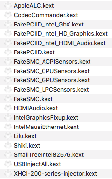

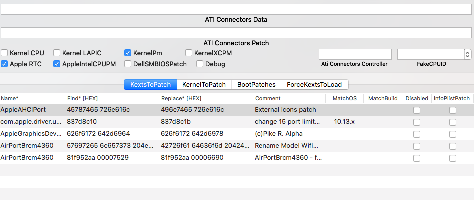

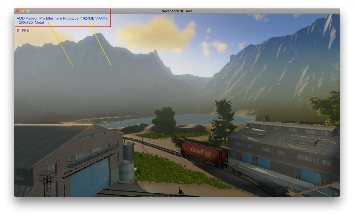

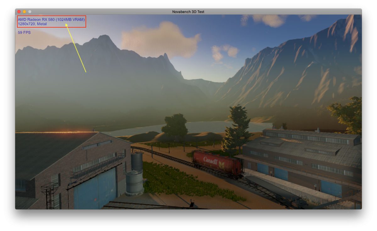

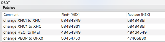

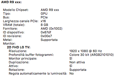

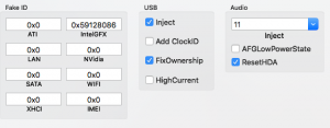

DjBeppe Posted January 9, 2018 Share Posted January 9, 2018 Hi all guys I need your help and I hope you can help me I took the road to install High Sierra on my new build and now I have some doubt / difficulty I do not know how to solve. My configuration: 8700K Asrock Z370 Professional Gaming i7 AMD RX580 Nitro+ 8GB First I created the usb pendrive and I used Clover with the following configurations: Bootflag: dart=0 -v Kext: Bios Setting: VT-d = Disabled Share Memory = 128MB IGPU Multi-Monitor = Enabled XHCI Hand-off = Enabled SMBIOS: iMac18,3 So far no problem, it started successfully, I initialized the hdd in APFS and I ran the installation. Once finished, it started and I made the first configuration successfully. At this point I configured Clover the same way as the installation: Bootflag: dart=0 disablegfxfirmware shikigva=4 -rad4200 darkwake=8 Devices: Graphics: Kernel and Kext Patches: SMBIOS: iMac18,3 Kext: I reboot and start without problems, but I know there is some problem to solve ... for example, the video card seems to recognize it but if I run a benchmark with "Novabench" I noticed that the GPU is recognized as 1GB: With "WhateverGreen.kext" and "RadeonDeInit=Disabled": || || || I tried to delete "WhateverGreen.kext" and "RadeonDeInit=Enabled" and I recognize the card differently but the same problem presents itself: || || || Why is it recognized by 1GB instead of 8GB? While on System Profiler is recognized by 8GB .... I'm doing something wrong? I tried to enable also "Hardware Encoding & HEVC Support" but I noticed a detail that I do not know if it's right or not (Hardware Info "MacX Video Converter Pro"): Without "WhateverGreen.kext" and "RadeonDeInit=Enabled": With "WhateverGreen.kext" and "RadeonDeInit=Disabled": [COMING SOON SCREENSHOT] Is it normal that this occurs? Which one is correct? I'm going completely in confusion I'm trying to figure out if I need to make any other changes to the system, if I add some other patches to make it work properly but I do not know where to check. I'm trying to configure the DSDT but DSDT Editor and MaciASL do not work, they do not open the DSDT.aml file generated by AIDA64. Do you know how to give me a hand? I'm banging my head for 2 days I thank you in advance for the help and I apologize for my english I hope I was clear 1 Link to comment https://www.insanelymac.com/forum/topic/331444-8700k-asrock-z370-prof-gaming-i7-amd-rx580-nitro-8gb/ Share on other sites More sharing options...
Dwarfy Posted January 9, 2018 Share Posted January 9, 2018 Hi, Lilu is needed with WhateverGreen. And you can get ACPI files extracted from Clover by pressing F4 as you boot to Clover. it will be in EFI/Clover/ACPI/Origin. You later patch the DSDT with MaciASL. You might also want to check iOReg for that. However, Mald0n (Moderator on InsanelyMac) tends to happily do it for people. Look up Mald0n on InsanelyMac, and check his thread about CoffeeLake Z370. Good luck. 1 Link to comment https://www.insanelymac.com/forum/topic/331444-8700k-asrock-z370-prof-gaming-i7-amd-rx580-nitro-8gb/#findComment-2565470 Share on other sites More sharing options...

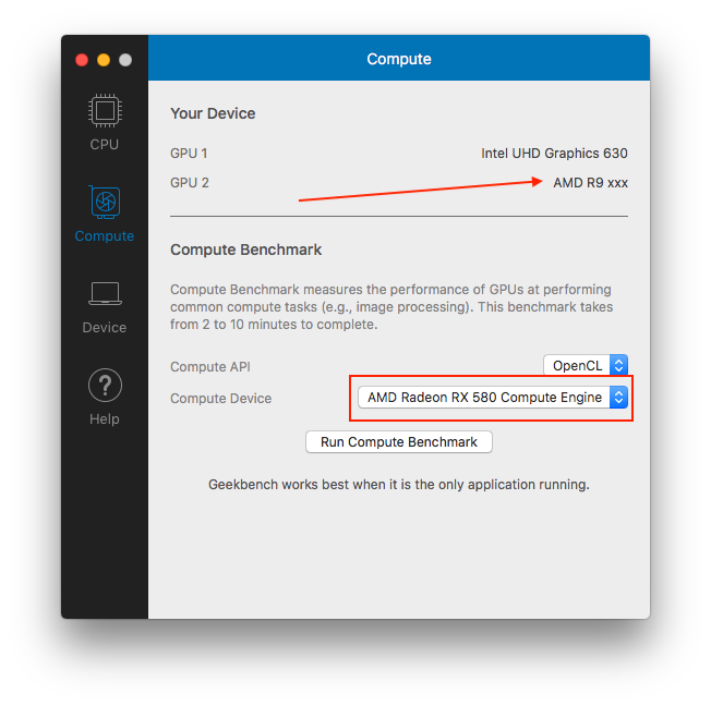

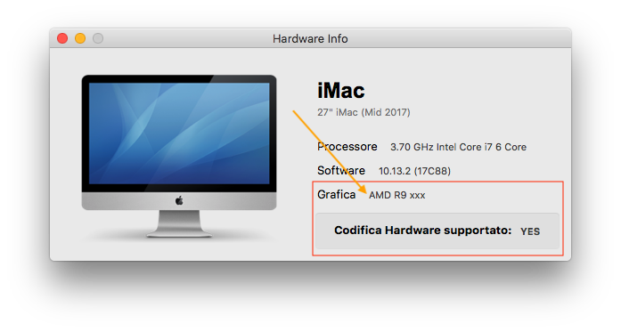

DjBeppe Posted January 9, 2018 Author Share Posted January 9, 2018 Hi, Lilu is needed with WhateverGreen. And you can get ACPI files extracted from Clover by pressing F4 as you boot to Clover. it will be in EFI/Clover/ACPI/Origin. You later patch the DSDT with MaciASL. You might also want to check iOReg for that. However, Mald0n (Moderator on InsanelyMac) tends to happily do it for people. Look up Mald0n on InsanelyMac, and check his thread about CoffeeLake Z370. Good luck. Lilu is needed with WhateverGreen But the fact that Novabench recognizes it as 1GB? Why? So it is correct to use Lilu and WhateverGreen for GPU? And you can get ACPI files extracted from Clover by pressing F4 Once I select the volume to start the mac I have to immediately press F4 (once only)? While regarding Hardware Encoding & HEVC Support "why does Lilu and WhateverGreenrecognize the Intel video card and not AMD? PS: MaciASL it does not work, it gives me an error Link to comment https://www.insanelymac.com/forum/topic/331444-8700k-asrock-z370-prof-gaming-i7-amd-rx580-nitro-8gb/#findComment-2565523 Share on other sites More sharing options...
MaLd0n Posted January 9, 2018 Share Posted January 9, 2018 -Post your full Clover folder -Send me tables http://www.insanelymac.com/forum/index.php?app=core&module=attach§ion=attach&attach_id=278494 -Send me one Ioreg too http://www.insanelymac.com/forum/index.php?app=core&module=attach§ion=attach&attach_id=278495 Link to comment https://www.insanelymac.com/forum/topic/331444-8700k-asrock-z370-prof-gaming-i7-amd-rx580-nitro-8gb/#findComment-2565541 Share on other sites More sharing options...
Dwarfy Posted January 10, 2018 Share Posted January 10, 2018 The benchmarking softwares might tell you some false or different hardware informations, but that is only cosmetic issues, usually. I know it isn't nice to have it there, but that is how it is. Link to comment https://www.insanelymac.com/forum/topic/331444-8700k-asrock-z370-prof-gaming-i7-amd-rx580-nitro-8gb/#findComment-2565899 Share on other sites More sharing options...
DjBeppe Posted January 10, 2018 Author Share Posted January 10, 2018 -Post your full Clover folder -Send me tables http://www.insanelymac.com/forum/index.php?app=core&module=attach§ion=attach&attach_id=278494 -Send me one Ioreg too http://www.insanelymac.com/forum/index.php?app=core&module=attach§ion=attach&attach_id=278495 But adding the modified "AML" files, what changes at the end? Can I send files without problems? because I saw that there are many ... what's inside? The benchmarking softwares might tell you some false or different hardware informations, but that is only cosmetic issues, usually. I know it isn't nice to have it there, but that is how it is. But it's really strange because the result of novabench is this: CPU: 263 (8700K) RAM: 292 (16GB 3200) GPU: 558 While on windows the results are much higher, and as if they did not recognize the various components 1 Link to comment https://www.insanelymac.com/forum/topic/331444-8700k-asrock-z370-prof-gaming-i7-amd-rx580-nitro-8gb/#findComment-2565917 Share on other sites More sharing options...
MacNB Posted January 10, 2018 Share Posted January 10, 2018 But adding the modified "AML" files, what changes at the end? Can I send files without problems? because I saw that there are many ... what's inside? But it's really strange because the result of novabench is this: CPU: 263 (8700K) RAM: 292 (16GB 3200) GPU: 558 While on windows the results are much higher, and as if they did not recognize the various components What's Compute score from Geekbench 4 ? Link to comment https://www.insanelymac.com/forum/topic/331444-8700k-asrock-z370-prof-gaming-i7-amd-rx580-nitro-8gb/#findComment-2566315 Share on other sites More sharing options...
