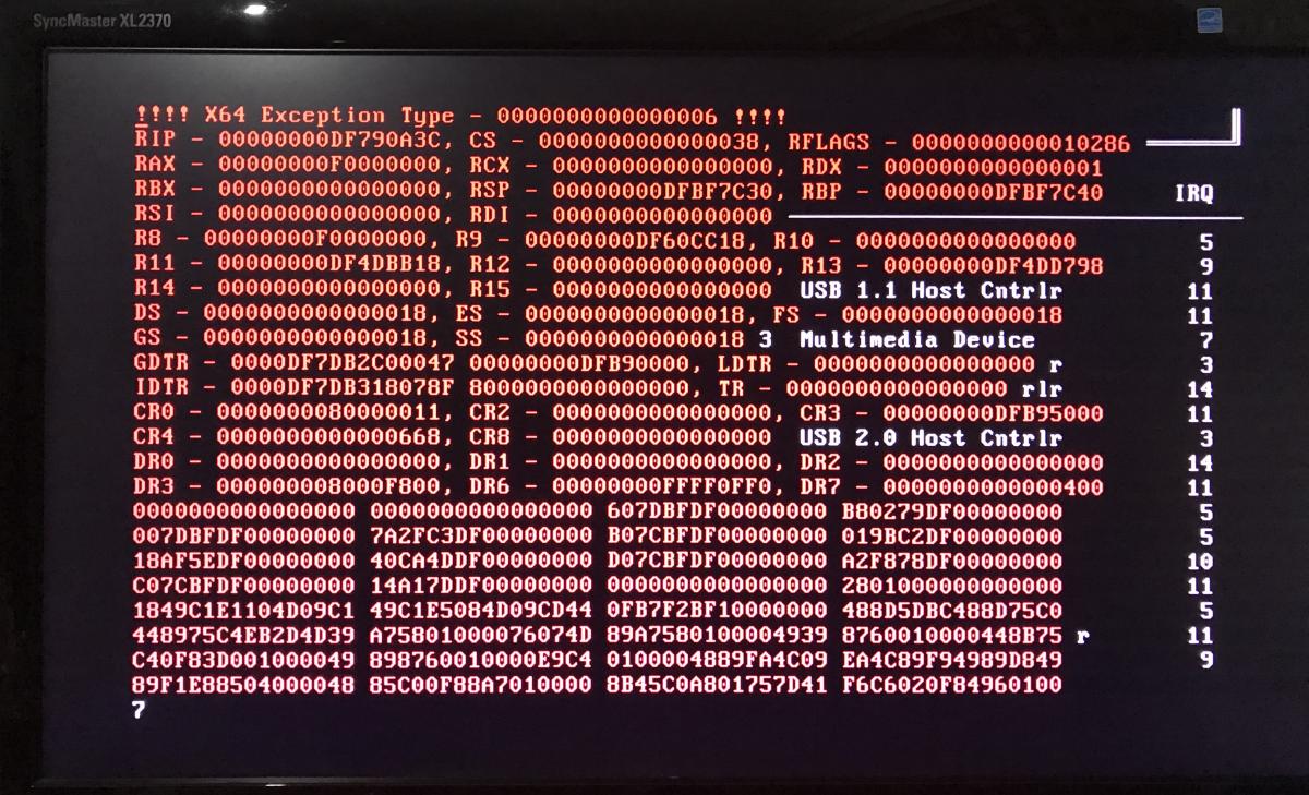

iceage2609 Posted December 15, 2017 Share Posted December 15, 2017 For a month now i am getting a random reboot when i am starting my Sierra 10.12.6 hackintosh and after that this black screen appears. Any clue whats that? Do you think that it's a hardware issue , i mean RAM-Mobo-HDD or it's a software one? Please any help because it's very very annoying Thanks Link to comment https://www.insanelymac.com/forum/topic/330679-reboot-and-strange-error-message/ Share on other sites More sharing options...
artur_pt Posted December 15, 2017 Share Posted December 15, 2017 hello every time I see that screen is about amd cpu .. post ur hardware specs boot loader u are using , version good hack Link to comment https://www.insanelymac.com/forum/topic/330679-reboot-and-strange-error-message/#findComment-2551094 Share on other sites More sharing options...

fusion71au Posted December 15, 2017 Share Posted December 15, 2017 @iceage2609, Did the red screens appear when you updated to official Clover r4243 from SourceForge (or switched from using custom dsdt to Clover dsdt patches)? That looks a lot like the red screen bug I mentioned here, due to official Clover r4061-r4264 being compiled with XCODE using -fno-common flag. It will occur if you use Clover's auto dsdt patching instead of a custom dsdt in the affected releases. Bug was fixed in r4265+. Try to update Clover to latest - attached r4359 compiled with GCC . Clover_v2.4k_r4359.pkg.zip Link to comment https://www.insanelymac.com/forum/topic/330679-reboot-and-strange-error-message/#findComment-2551301 Share on other sites More sharing options...

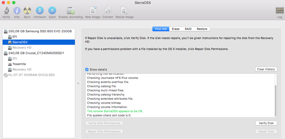

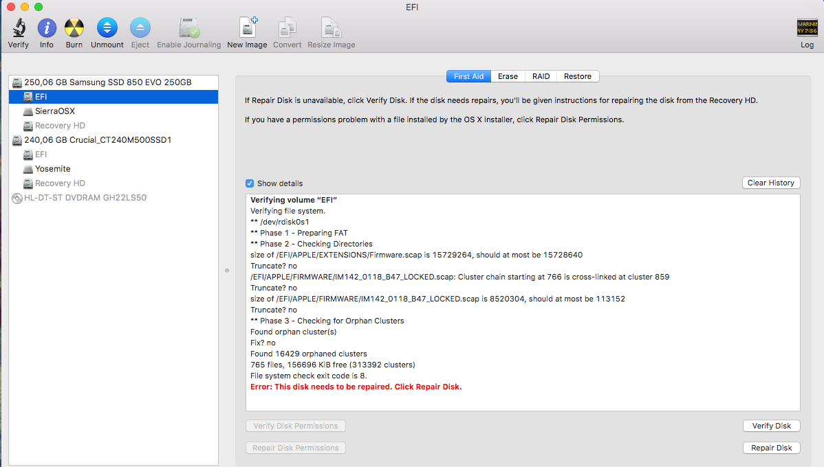

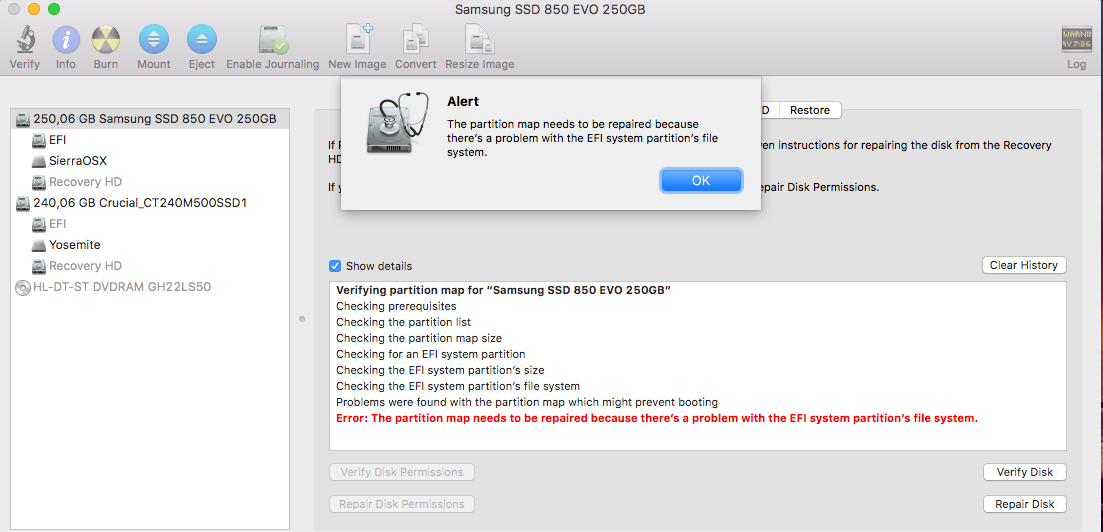

iceage2609 Posted December 18, 2017 Author Share Posted December 18, 2017 @iceage2609, Did the red screens appear when you updated to official Clover r4243 from SourceForge (or switched from using custom dsdt to Clover dsdt patches)? That looks a lot like the red screen bug I mentioned here, due to official Clover r4061-r4264 being compiled with XCODE using -fno-common flag. It will occur if you use Clover's auto dsdt patching instead of a custom dsdt in the affected releases. Bug was fixed in r4265+. Try to update Clover to latest - attached r4359 compiled with GCC . Hmm i am not sure but the whole reboot issue started with the last update.( 10.12.6) From the biggening i was using custom dsdt file (not Clover's auto dsdt though) inside the patches file. Unfortunately updating the Clover bootloader didin't fix the problem ... I used disk utility and verify disk and that's the respond error. Any clue if it has anything to do with the problem or its a accidentally error. Link to comment https://www.insanelymac.com/forum/topic/330679-reboot-and-strange-error-message/#findComment-2552753 Share on other sites More sharing options...
